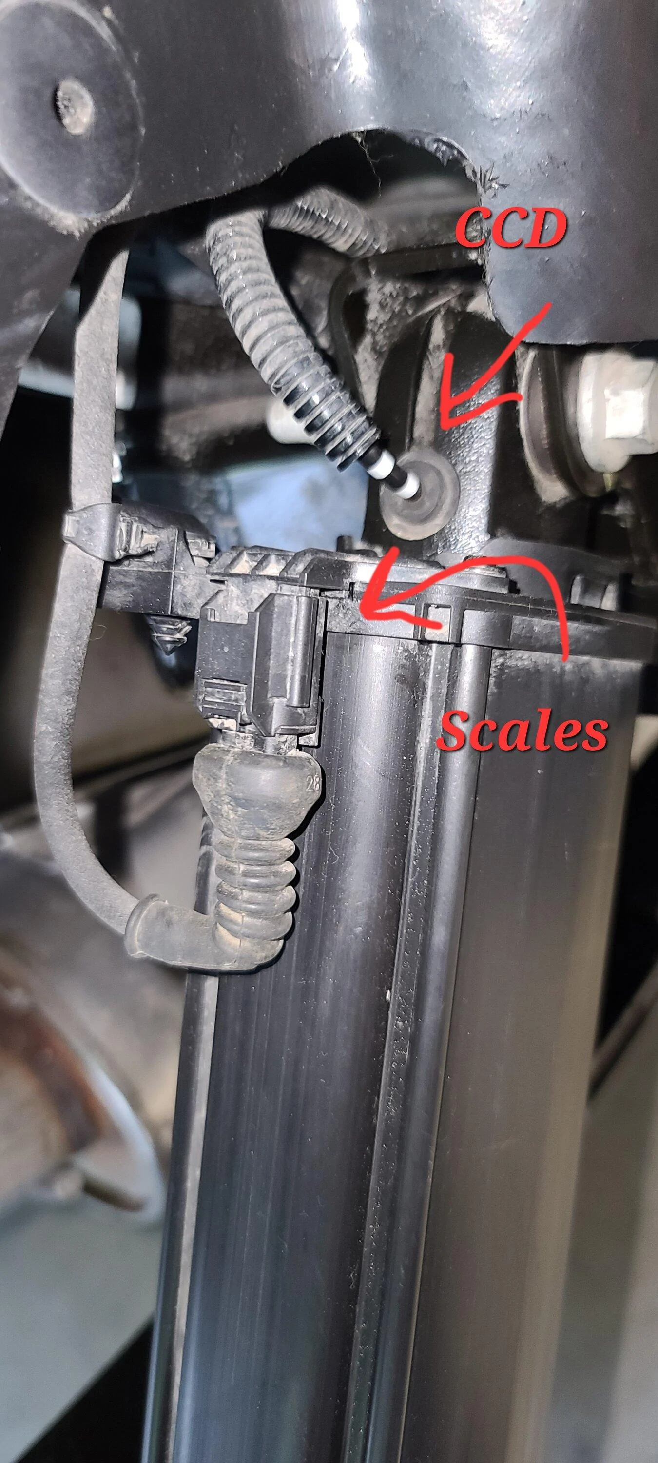

Onboard scales and auto-leveling do use the same height sensors. But you get height sensors on your truck with auto leveling headlights, even if you don't get bed scales.
In fact, there are 2 different rear height sensors available, depending on if you get CCD, as well. With CCD, the rear height sensors are imbedded in the shock cover. Without CCD, the rear height sensors are lever-type, similar to the front height sensors.
This is the rear height sensors for CCD/Scales
Ford F-150 NEW Diode Dynamics Headlights 20220508_184837
Ford F-150 NEW Diode Dynamics Headlights 20220508_184759
I don't have a picture of the other rear height sensor option, but I'm sure someone else can post one.

Digging through PTS, it appears that the leveling system uses a front and rear ride height sensor on the left side only. There are only RH ride height sensors on vehicles with CCD and/or scales. The CCD has the ride height sensor built into the shock, whereas non CCD trucks with LED projectors have a ride height sensor attached to the frame.
You beat me to it lol
