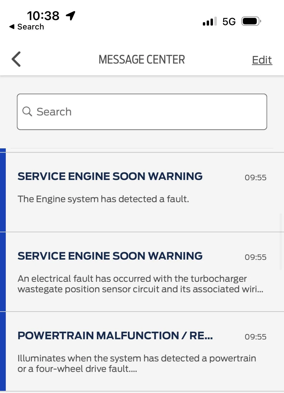

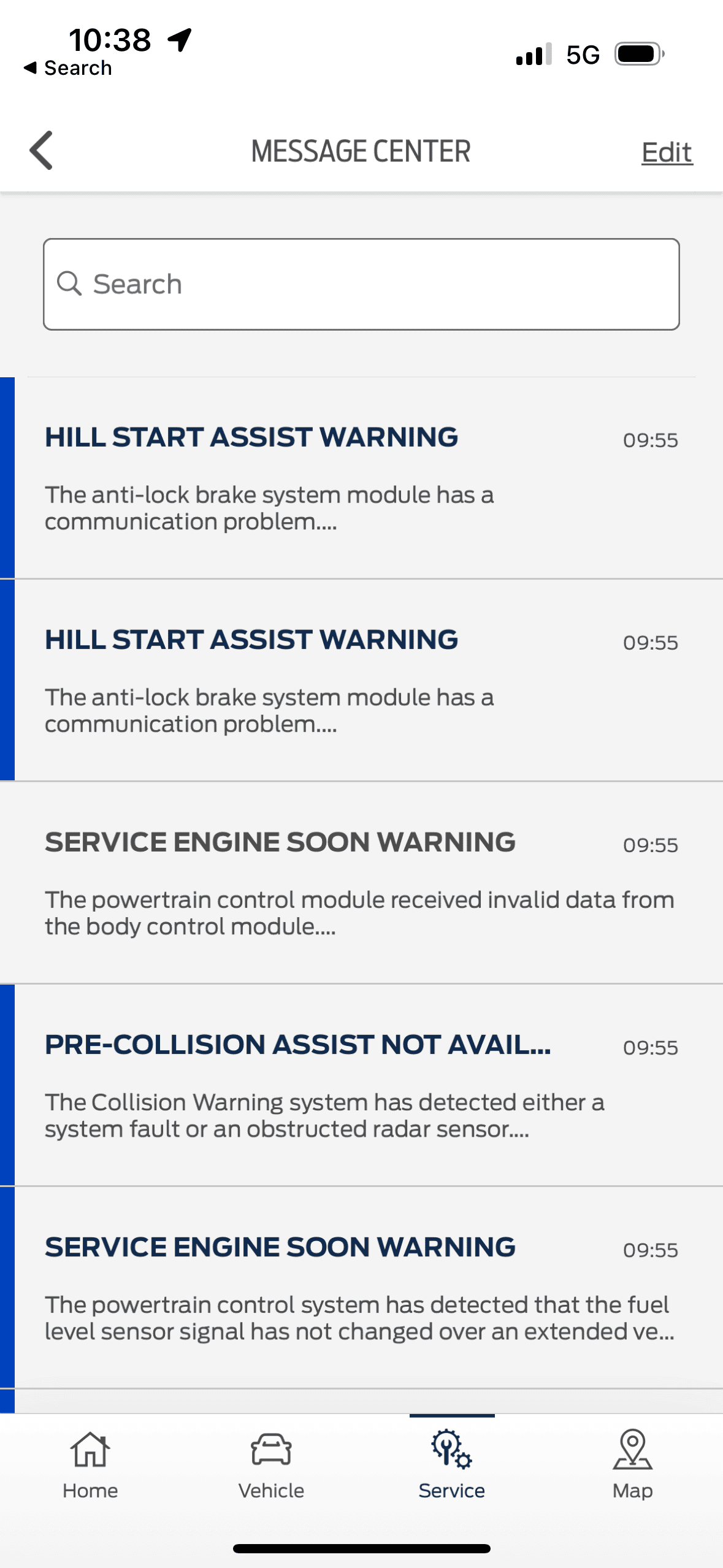

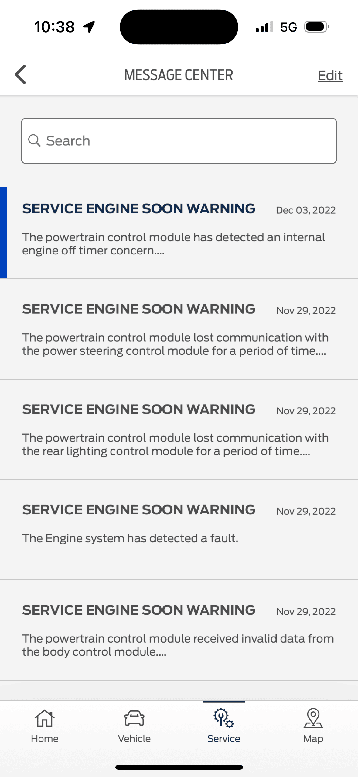

A few of the errors as reported in the ford pass app

The gateway module is similar to what a multi-medium router/switch is in a data closet. So it does make sense that a malfunctioning one would result in the disruption of communications between multiple modules on the various networks in the truck.
I'm surprised that the first dealership wouldn't have immediately seen the vast number of DTC's that would throw as soon as they ran the network scan in FDRS.
