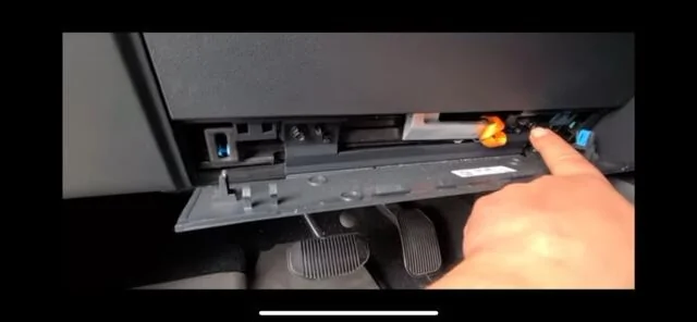

Anyone know where the neutral override switch was moved to in the 2024 F150 XLT 2.7? In the 2021-2023 it was behind a panel but it is no longer there. As far as I can tell there is no way to shift into neutral if the battery is dead or if keys are missing and can't turn on the vehicle. Asked the dealer and they didn't know. Tow driver couldnt move vehicle and didnt have skates. Been looking for parts diagram but can't find one.
Top photo is 2024
bottom photo is 2021-2023
thanks
Ford F-150 Neutral Override Switch in 2024 F150 image0
Ford F-150 Neutral Override Switch in 2024 F150 image1

According to page 271 of the owners manual it's in the same spot, that is interesting that is not there on yours. I have a 2024 Lariat 5.0L. I won't be home until tomorrow or i'd go out and check.

This is the procedure I found. Need to power on.
Ford F-150 Neutral Override Switch in 2024 F150 Captur
That sucks, will have to be accessed at the transmission directly. This is what GM does and it has to be held or zip-tied to keep it in neutral I believe.
