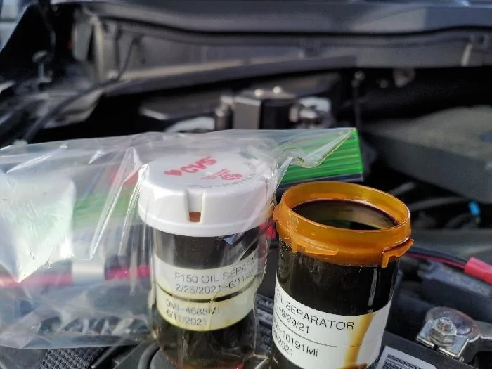

Reviving an old thread to give some personal numbers.
2021 3.5L EcoBoost. Installed passenger side catch can at the very beginning.
Just had second oil change, first one at 4,700 miles and second at 10,200 miles.
Mostly city driving. Just before taking it in to the dealer each time I dumped the catch can into a CVS pill bottle and labeled it. Each time almost filled a Berry 20 dram bottle so about 70ml since it's not all the way to the top. This volume accounts for 1.23% of the crankcase oil of 6 quarts.
Engine totals: 338 hours, 83 idle hours.
Making no claims if this is good or bad, just providing data.
