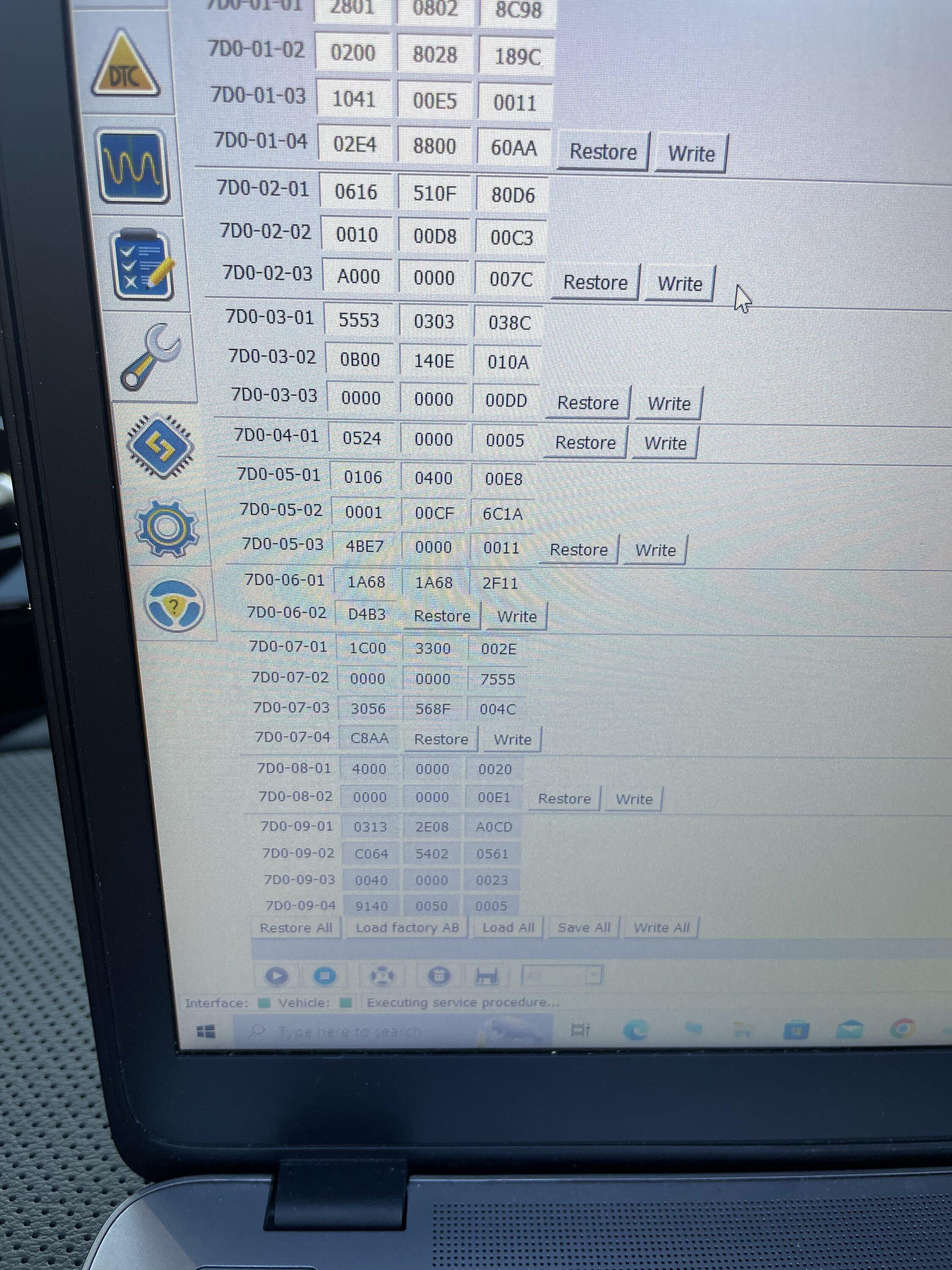

Now I need to make my Nav and cards work, if y one can chime in. I changed this line to match my brothers as well no luc
7D0-01-040004880060C8
Previously I had 02E4 8800 60AA

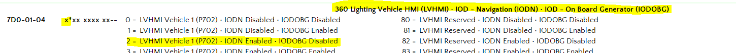

The first two digits in the first hextet should be 02 as this is what tells the APIM that NAV is enabled.
From forscan spredsheet. Note: they left out the leading zero on the spreadsheet
Ford F-150 MY22 Adding SiriusXM 1682118327891
The second hextet is fine at 8800
The first two digits of the third hextet are good. The last two digits are the check digits so you will get an error in Forscan stating this. I have a checksum calculator somewhere. I'll need to look for it.

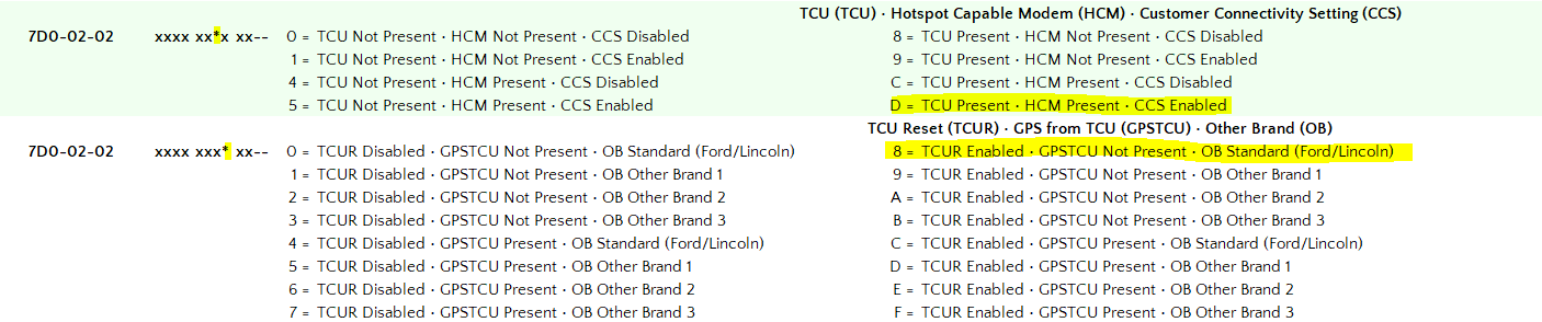

You may also need to change 7D0-02-02 to tell the APIM that the GPS from the TCU is not present.
My register is set to 4200 00D8 00F5
Ford F-150 MY22 Adding SiriusXM 1682119029846
You should have the NAV card on your screen, but No GPS will be displayed if you have the APIM set to get the GPS from the TCU.
I hope this helps.

If you plan on actually trying to navigate, I suggest you look at 7D0-05-01, 4th digit 1st column.

This is what I have now still no Nav on the screen. I got a checksum error when I changed it to this on 7D0-01-04. Sorry for the bad pic hopefully someone can point me in the right direction
thanks for your help

You have swapped in a navigation APIM haven’t you? What was it out of?

Yes, sorry should’ve stated that first. My truck is an 22 XL single cab, did the 12” screen and what I think is a Nav apim not sure what the apim came out of. I also did the 12” cluster and ACM.

Okay well that’s an important bit to know. As has been stated many times on this site you can’t just throw this stuff together like on the previous gen trucks.

I keep pulling this data from the OEM Ford as bill decoder because that works for me. Is Vin I pulled with the screenshot below is from a XLT with navigation. Try the bottom below hex code. See if that works.

The "correct" way is outlined in the first post along with an alternate method. In non-nav trucks, the TCU receives location data directly from the antenna. On nav equipped trucks it routes through the APIM.
thank you, I’ll give that a try tomorrow
