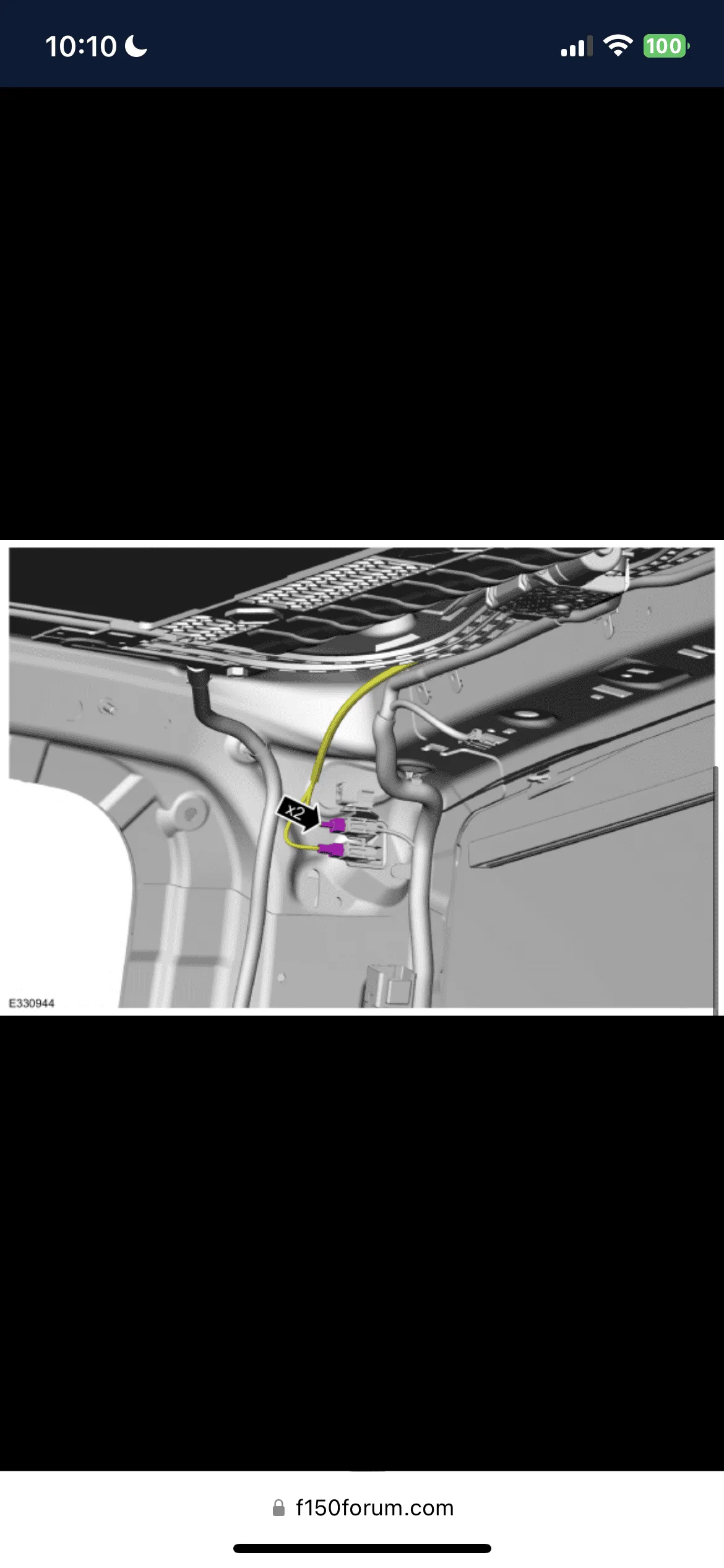

THe oem ford antenna is on the dash (NOW ROOF)
Could it be the cable I’m using? I got it from Amazon
Is this connector the xm one under the dash?
Ford F-150 MY22 Adding SiriusXM imag
also, it doesn’t look like there’s any way to remove the connector to get the portion of the antenna out to stick to the roofline. I’ve installed the antenna and connected to the cables shown in this post above.
Have the orignal antenna hangin in rear as it doesnt seem like you can get the silver connector thry the antenna base.

a couple of your photos did not come through so hard to know exactly what you have going on. You ordered a new roof antenna that has Sirius xm correct? if you drop your headliner, you unbolt the old antenna, taking the bolt completely off, I used a 10 mm ratcheting wrench so I did not have to have as much room. Then when the bolt is out completely you pop the top portion off. the new antenna will then pop down into that hole and you tighten the bolt. The antenna connection points are in the rear passenger side cab corner, you make the swap there. That is prerun to the curry connector that you have shown behind the glove box. If you havent dropped the headliner and installed that antenna, then that curry port is dead and runs to nothing.
