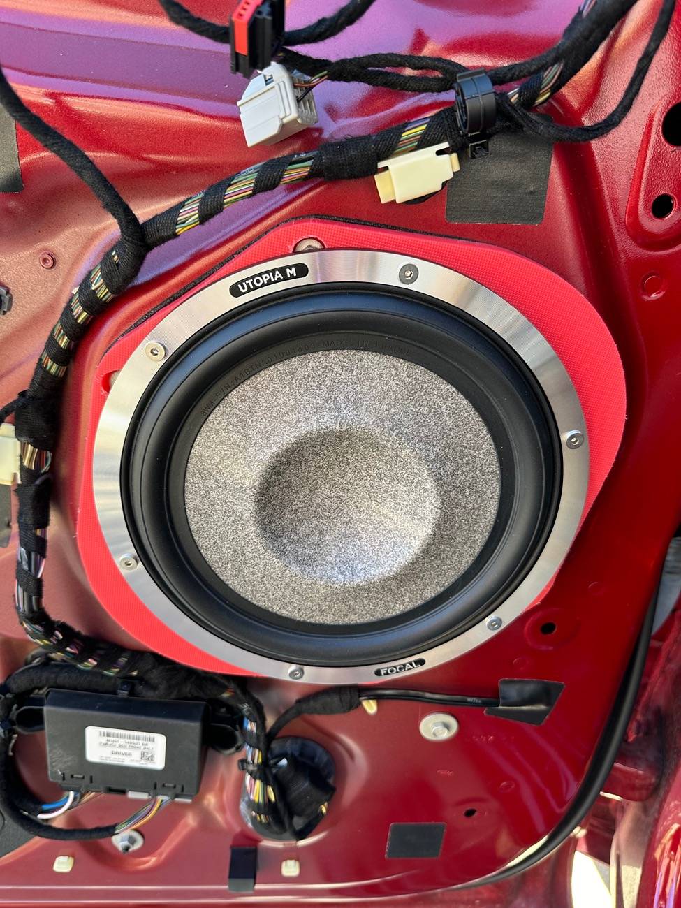

Replaced the AudioFrog 6.5s with Focal Utopia M 8wms in the front doors.

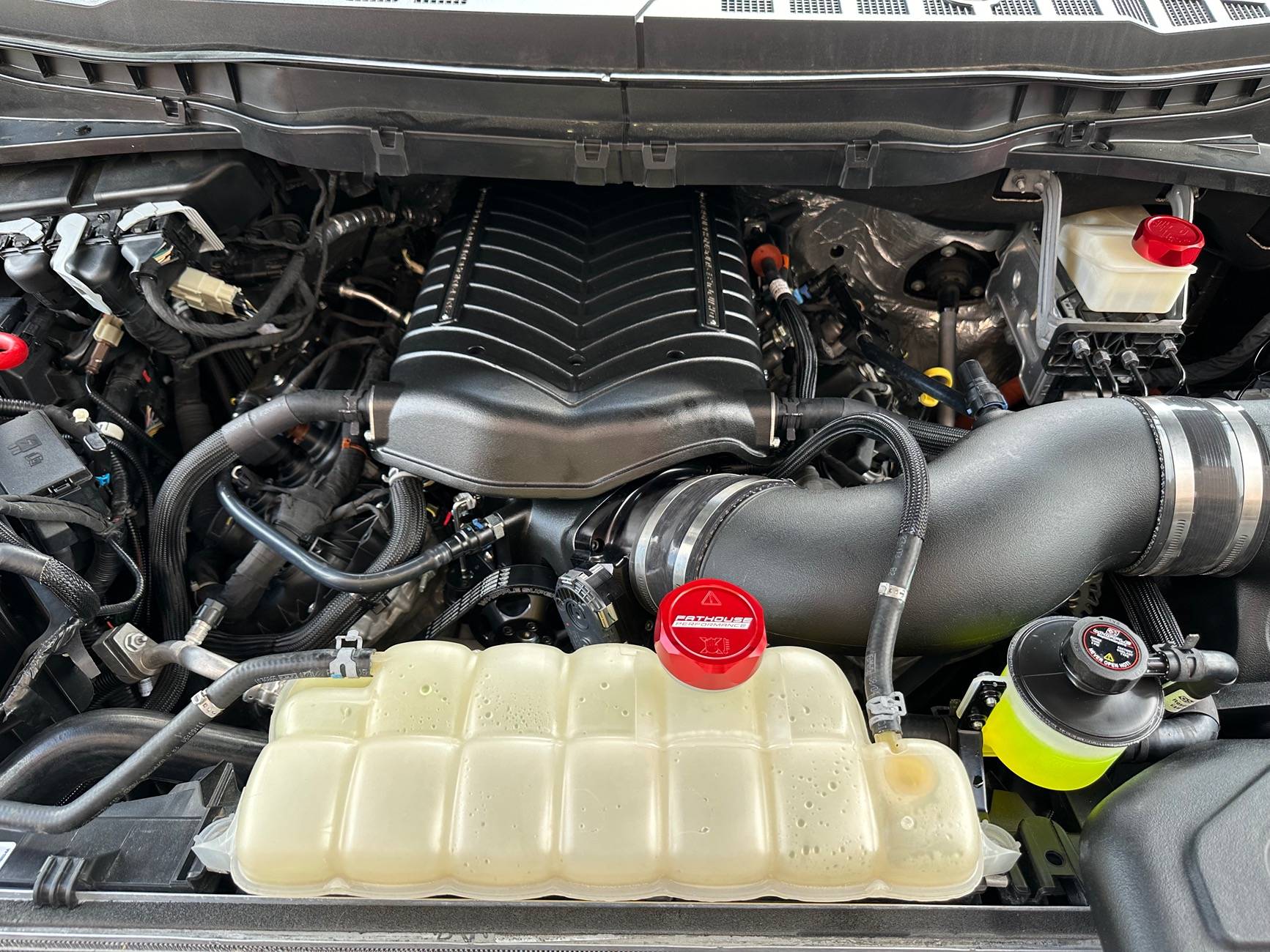

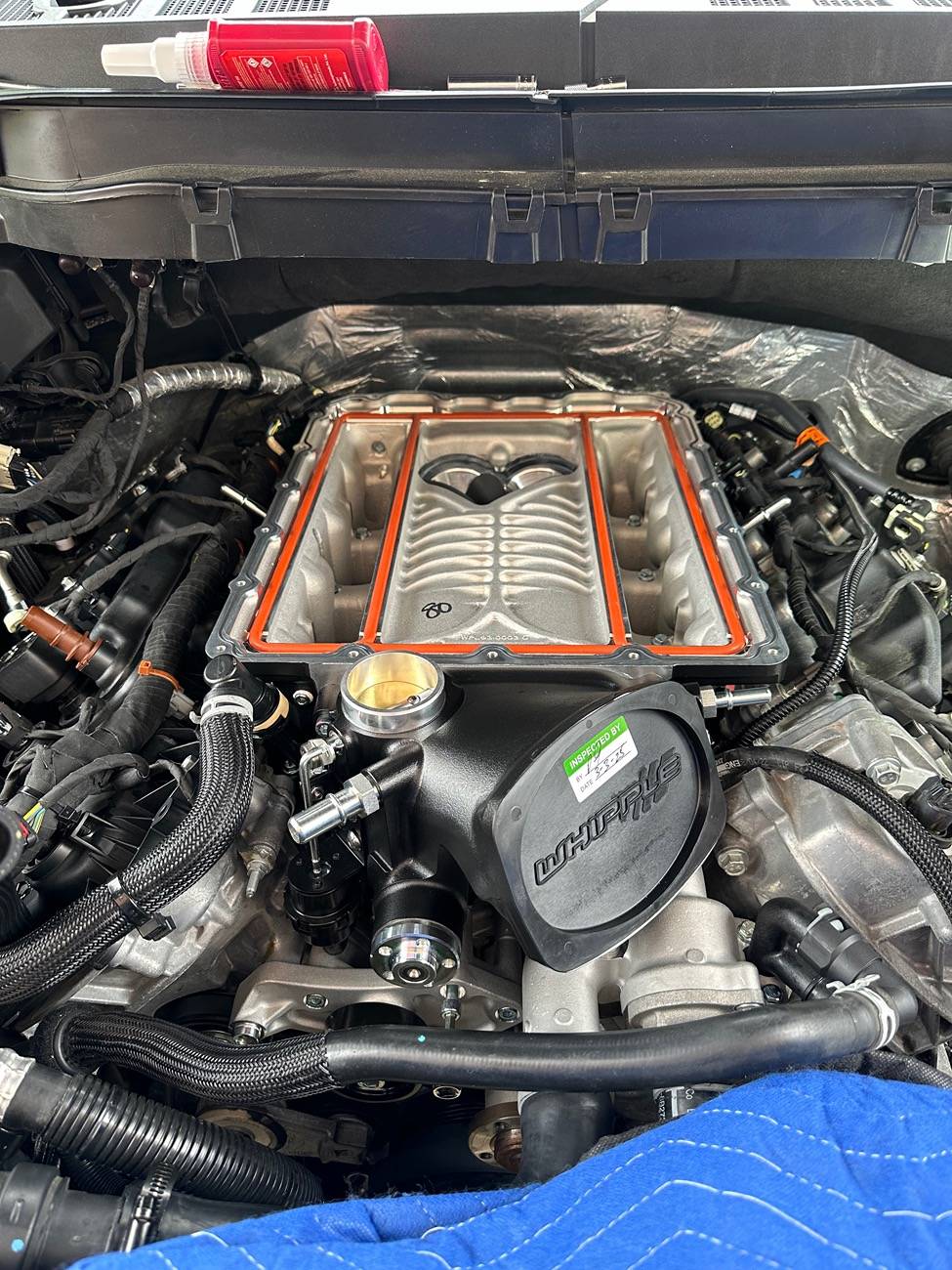

Completed the install on the Gen 6 Stage 2 Whipple the last few days.

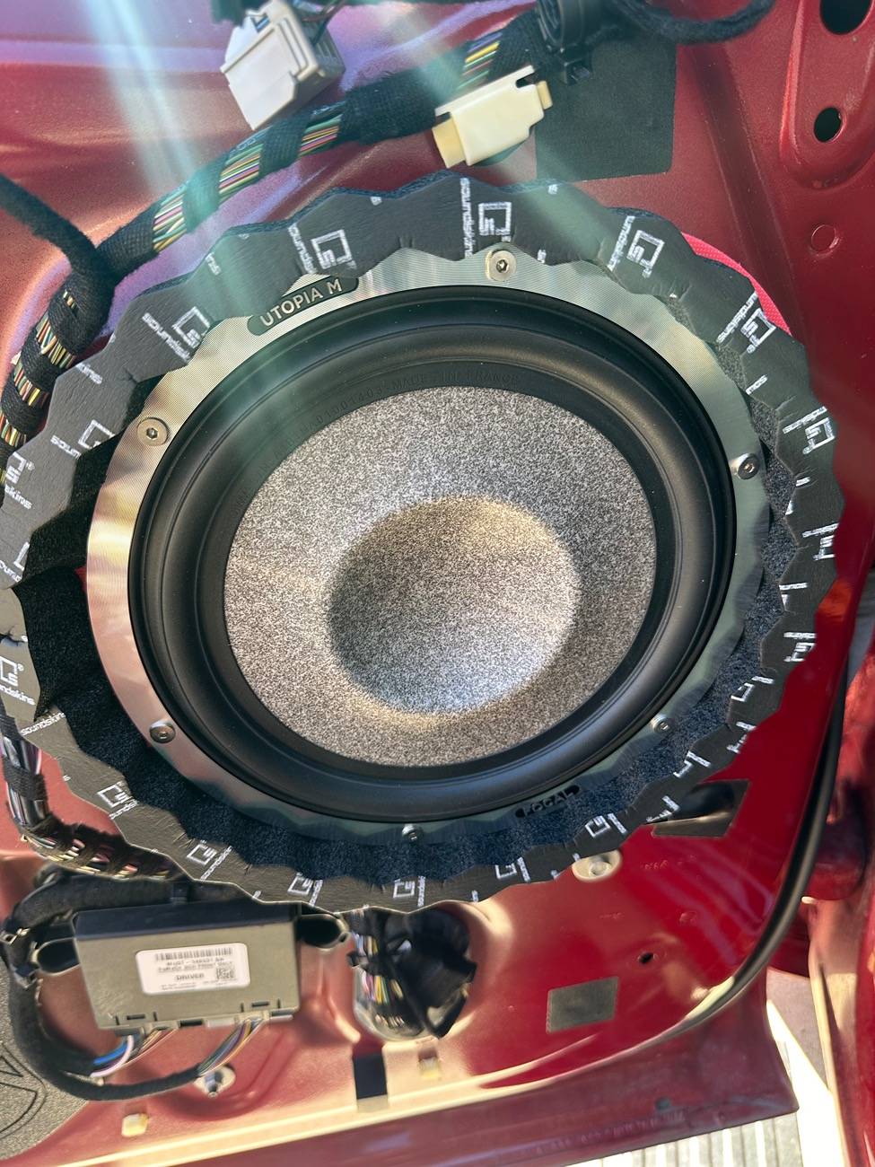

Sick build! Your attention to detail is next level. As a guy who has never messed with audio outside of putting a new headunit in back in the 90s-2000s, I have a question. Is all the sound deadening to improve audio? I see you put a layer around the door speakers too. Never seen anyone add it, usually its taken out to save weight. Again sick truck!
Flash69
May 7, 2022
488
503
Austin, TX
2022 F-150 Platinum
Thank you.
There are multiple uses for sound deadening depending on what you use and where. Sound deadening will stop vibrations, rattles which take away from the quality of the sound your speakers put out. Sound deadening in the doors will help your door speakers perform better as the back waves from the speaker will be deadened so the door does not rattle/vibrate. Door blockoff plates help the base response of the door speaker which also helps the quality of the sound. The sound treatment around the speaker in my picture is to help direct the sound from the mib-bass driver through the door panel. This helps not lose sound waves in the door panel thus making your speakers less efficient.
This is only a basic description, there is much more detailed information available online.

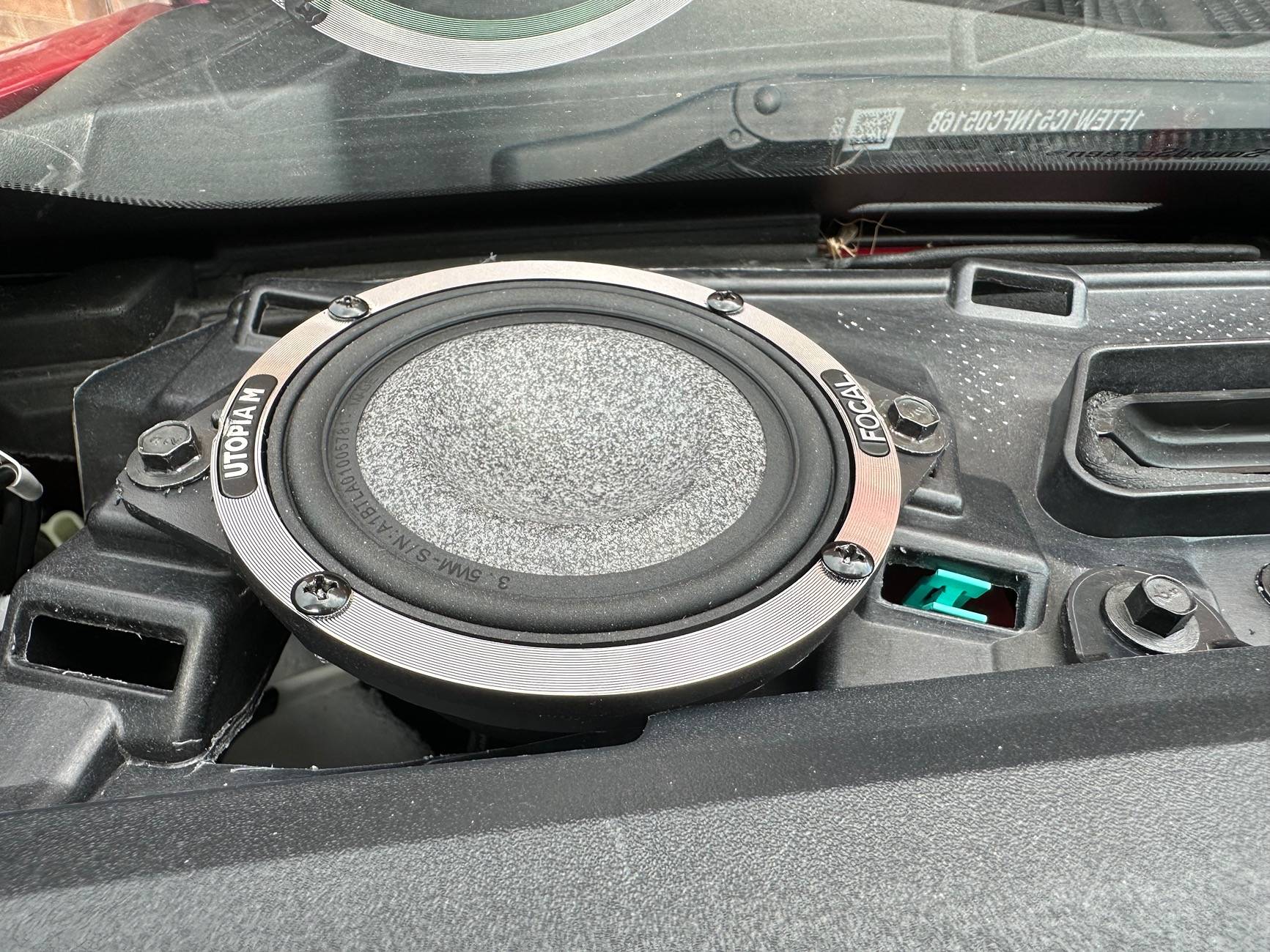

Replaced the AudioFrog GB25s with Focal Utopia M 3.5wms.
