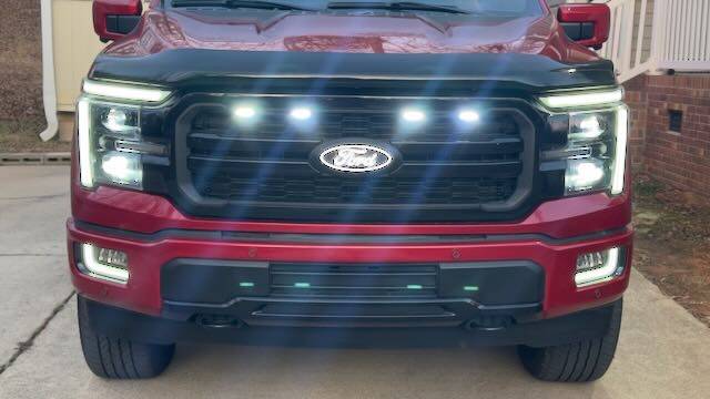

Things I got done with the nice 51° today, as I don't have a garage and it's been cold with either rain or snow.
Things added:
  • MicTuning Switch box
  • F150Leds Raptor lights
  • Diode Dynamic's SSC2 pods for reverse lights and red backlighting

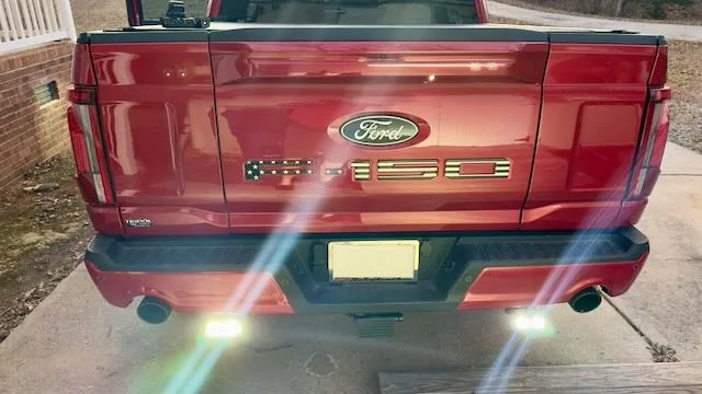

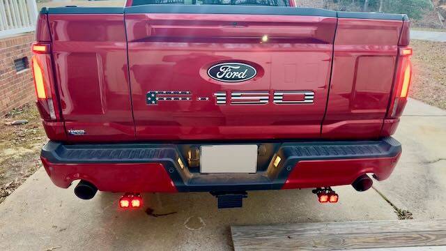

My only issue right now is when I put the truck in reverse, the reverse lights come one for one second and then turn back off. I think it has something to do with the wiring harness, maybe it's shorting out. Going to contact the wiring harness vendor to see what they say, as all the lights work as designed when I turn them on/off with the switch.
The placement of the Raptor lights are kind of funky, but did the best I could with the Lariat style grill that my truck came with.

You’ll most likely have to install a relay to run the added reverse lights. The truck is sensing additional load on the circuit and shutting it down. I had the same issue when trying to add additional fog lights.
