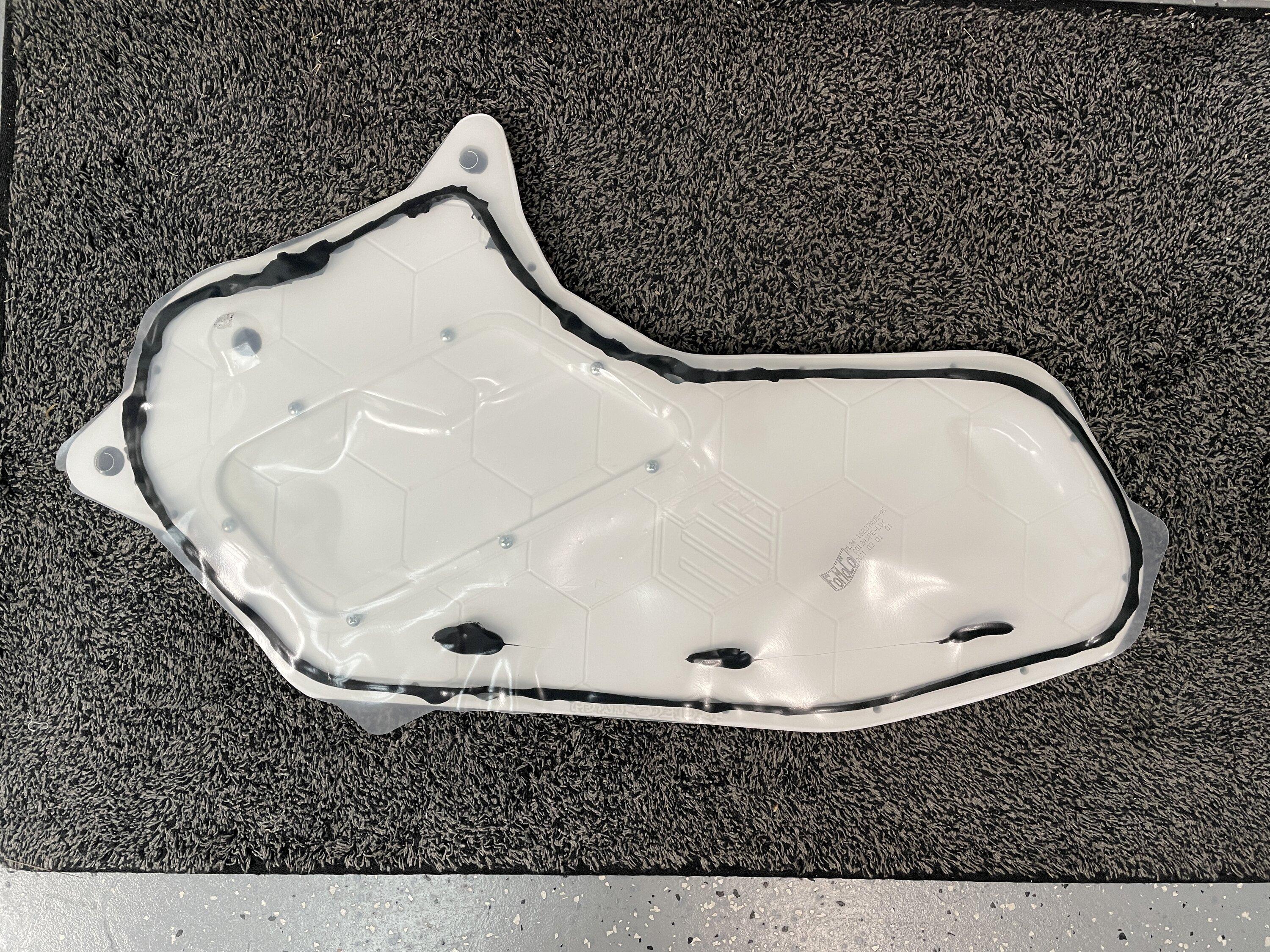

Hello, the indent on the 2021-22 door blanking panels. Is that for some kind of door panel clearance? That’s the only thing I can think of. It’s attached with lock nuts and machine screws.

Gosh those look a lot like these.... SGS blockers

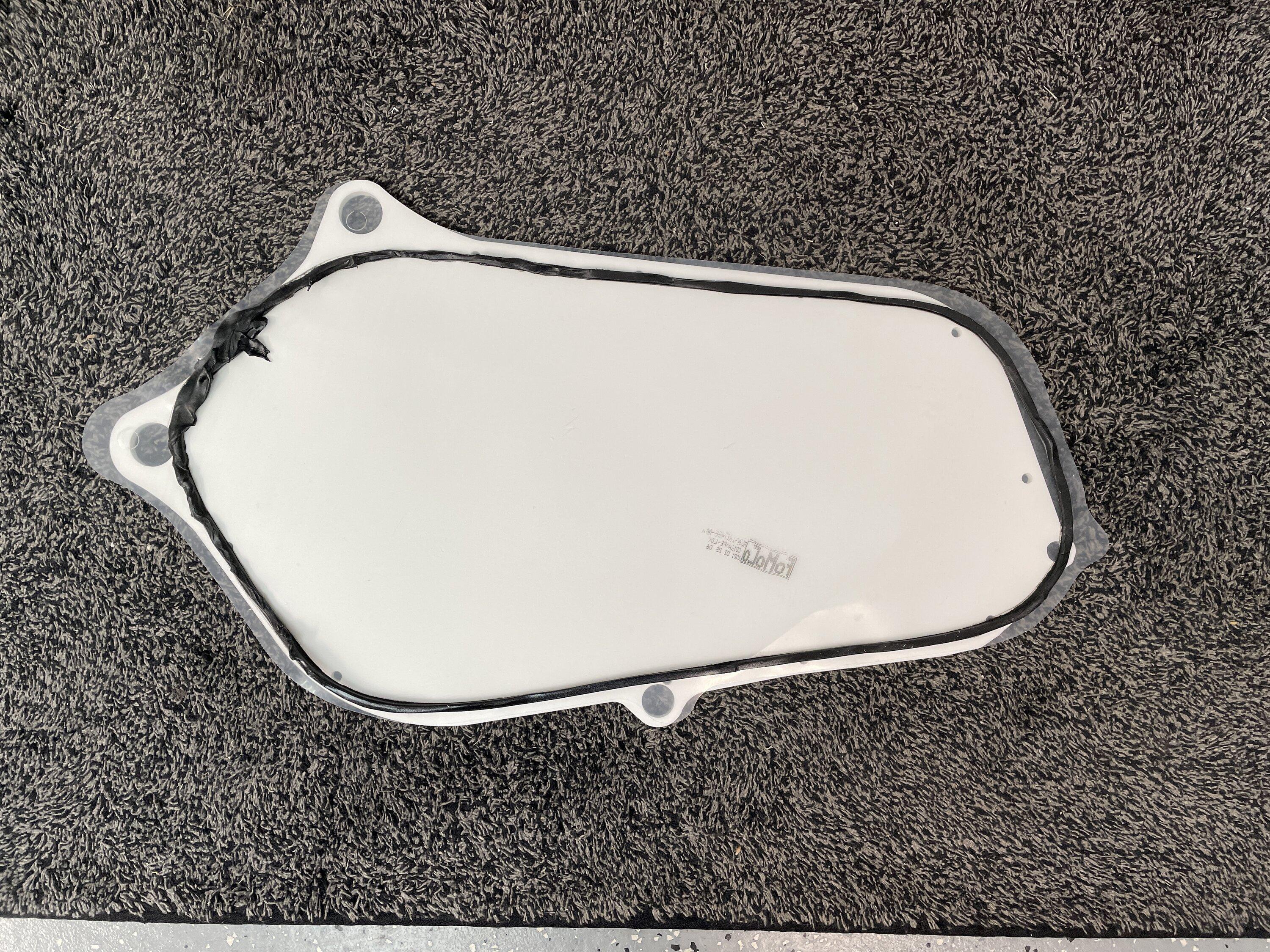

One pic has the same indentation and the others do not. When I had my door panels off I don't recall anything protruding into that space to need the additional clearance.
There are some words on the SGS version saying this:
"Multi-Piece Design that allows for proper door panel fitment"

Ah. Yes I should have checked their also for a description.

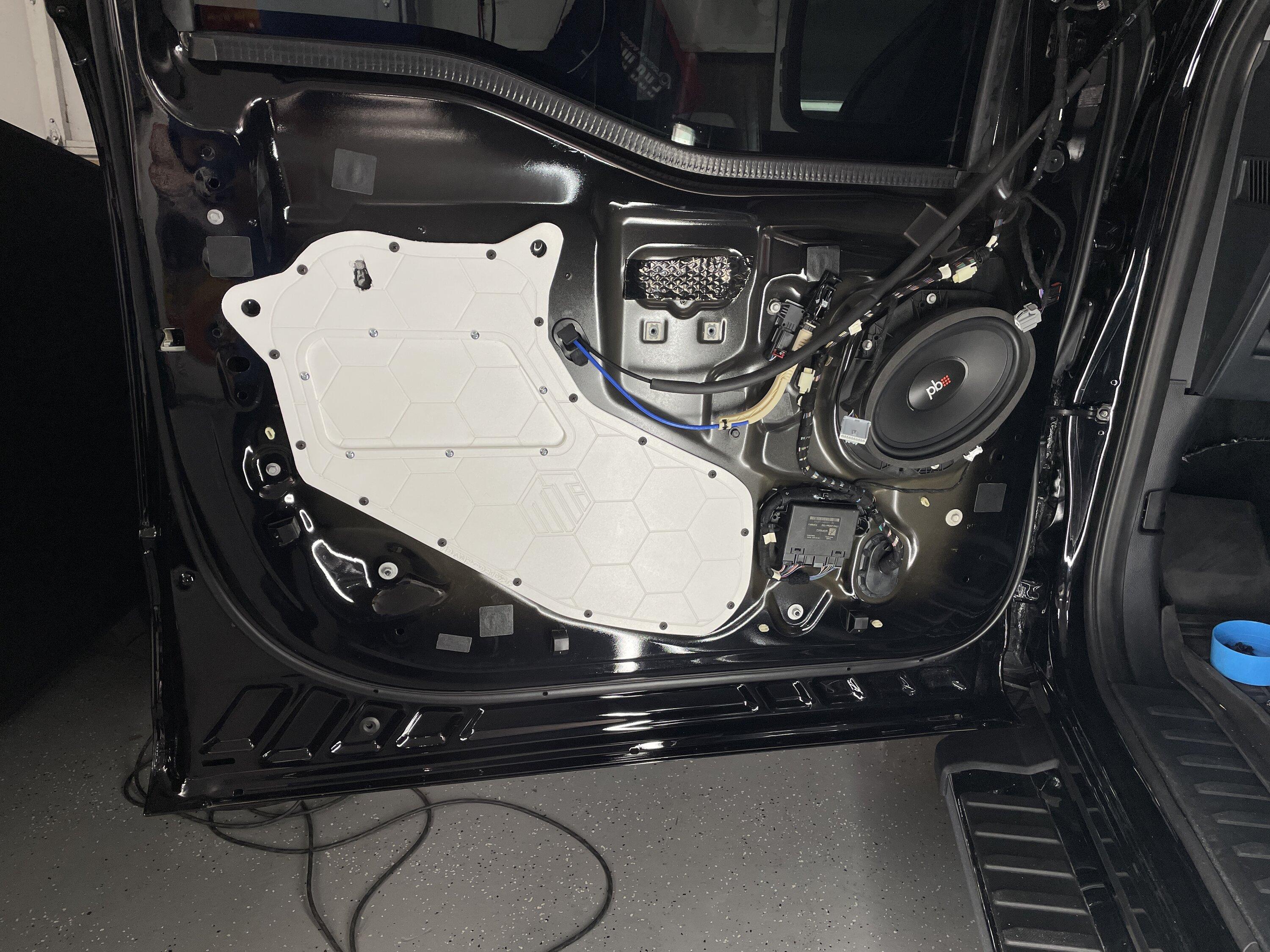

Has anyone else used the MTI fillers on the 14th gen? It’s really tight when you put the door panel back on. The clip under the door lock always seems to pop off. I have it on now, I will see how it goes.

Ok, I figured out how to get the door panel to fit back on normally with the blanking panels, I assume this works for the MTI ones or the SGS ones. First you have to trim the factory sound deaden/felt on the back of the door panel. What I did was just trim the heavy black stuff and not the felt, as the felt flexes more. Then put the door panel on and hang it on the top rail. Then you can reach you hand up from the bottom and route the door lock cable in between a spot above the lower pocket. See picture attached. That is also the route where I trimmed the sound deadener.
They almost got it, but their protrusion is not the correct depth. Needs a little more in that area to not add tension to the clips/panel. They are attaching a 1/4-inch plate to the cutout, where we are milling out a 1/2-inch plate so we gain an extra 1/4-inch for a total of 1/2-inch protrusion. From the photos, I guess they did not see that :)
