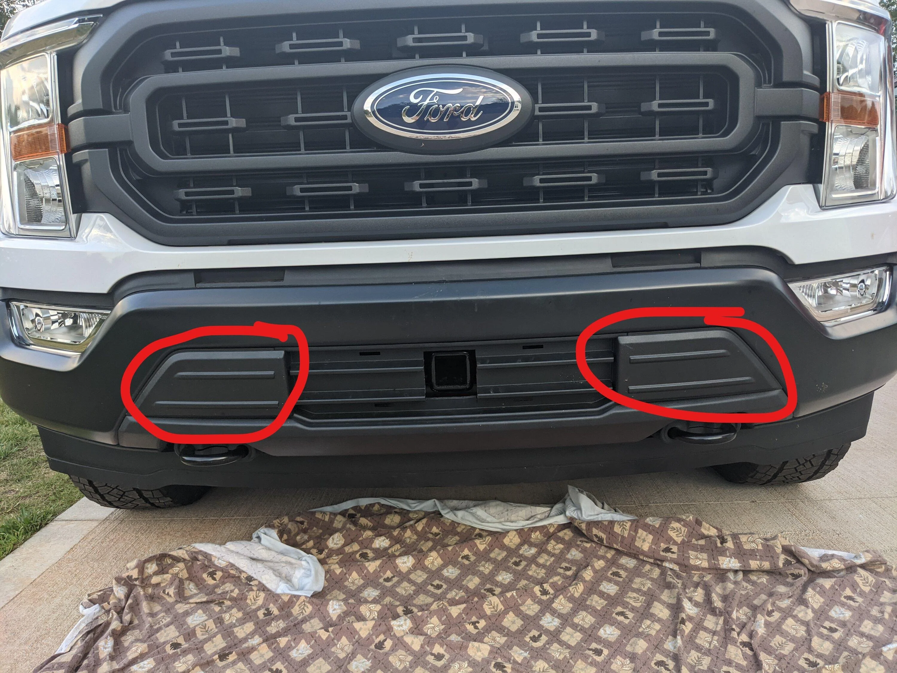

So I finally installed a front hitch this weekend and took some pics of the lower center panel removal:
First thing I did was pry the two side panels off gently. They just need a flat screwdriver to get them started.
(FYI The lower center panel is attached to the bottom trim panel so you need to remove this assembly together in order to detach the lower center panel.)

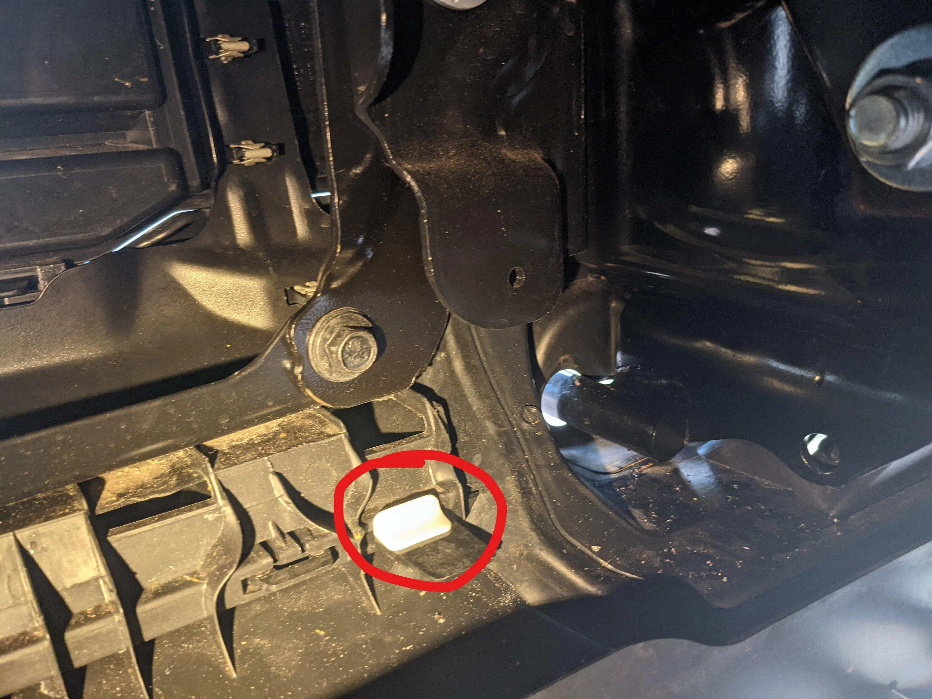

Then I crawled under the front to access the remaining clips holding the panels in place:
First, I removed 4 white clips directly behind the center and bottom trim panels
Then I loosened the bolts directly above the tow hooks. There is one on each side. These bolts hold the bottom trim panel in place:
I was then able to pry off the lower center and bottom trim panel from the bumper in one piece, being careful not to break any plastic or retaining clips. Once the assembly is off, you can detach the lower center panel from the bottom trim panel easily using a flathead screwdriver.
