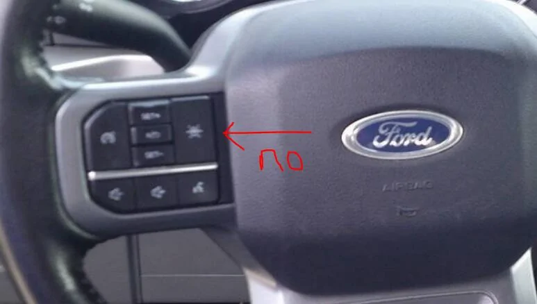

Adaptive cruise is simple to distinguish, but can also be added for ~4-500$
It's as simple as seeing the steering wheel.
Ford F-150 Looking to get back into an F150 1723356013655-cy
Yes
Ford F-150 Looking to get back into an F150 1723356097812-8k
