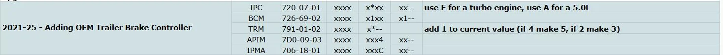

The changes needed to do this are in the common tab of the FORScan spreadsheet and seem very straight-forward.

Looks like I have correctly programmed the unit. I will tow with it tomorrow and see for sure. But the buttons change the gain on the dash! Thanks for the push...
