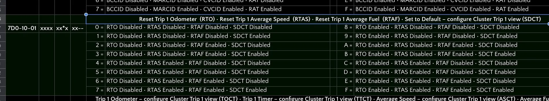

Hi, I have a 2023 XL. Recently, I have noticed that my dash display is reverting to the digital speedo. I would like it to stay on the four-square screen that shows mpg/miles to empty. Is there a way to do this either in the menu or with Forscan?

In FORScan, the only thing I can see that makes any sense to me might be SDCT in the APIM:
Ford F-150 Locking dash screen to certain setting help IMG_4728
I see nothing in the IPC. You could try it. Reset both the APIM and IPC to be sure it works or doesn't. Others may have a better idea ?‍♂
