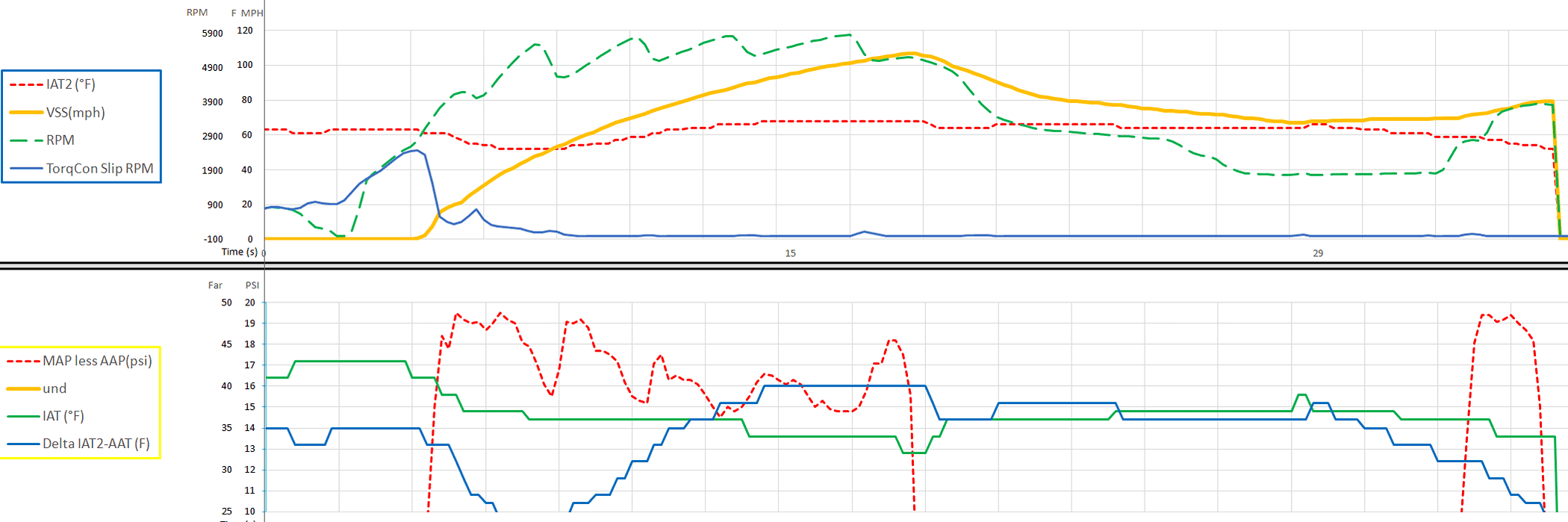

Using OBDLink. I found Charge Air Cooler Temp bank 1/2, Sensor 1/2 but they don't seem to work. temp 1/2. Searching for "temperature" didn't find with Manifold Charge or Charge air. Are the under SAE?
Observing IAT and ambient IAT seems to run 7-10 warmer at cruise. When ICE is off gets higher with heat soak. Serious throttle with turbos making boost pulls the IAT back to near ambient. Which I think someone mentioned earlier.
(The electric motor peaked at 161.9 amps at 272 volts, 44kW or 59hp)

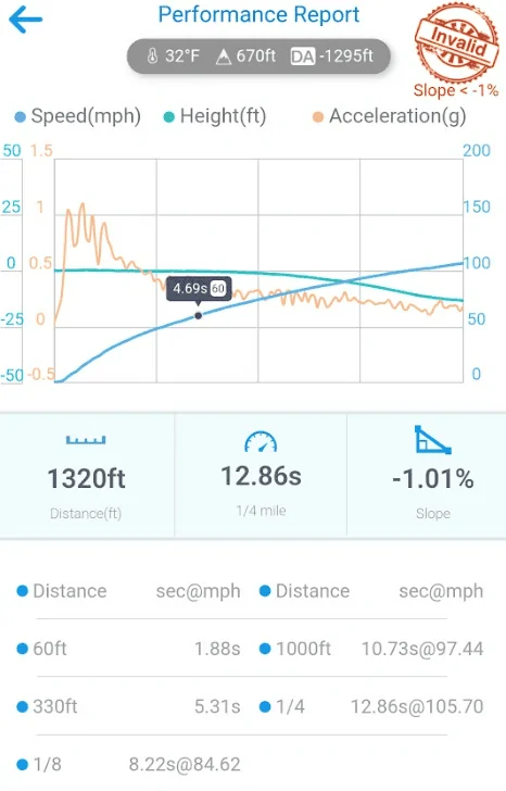

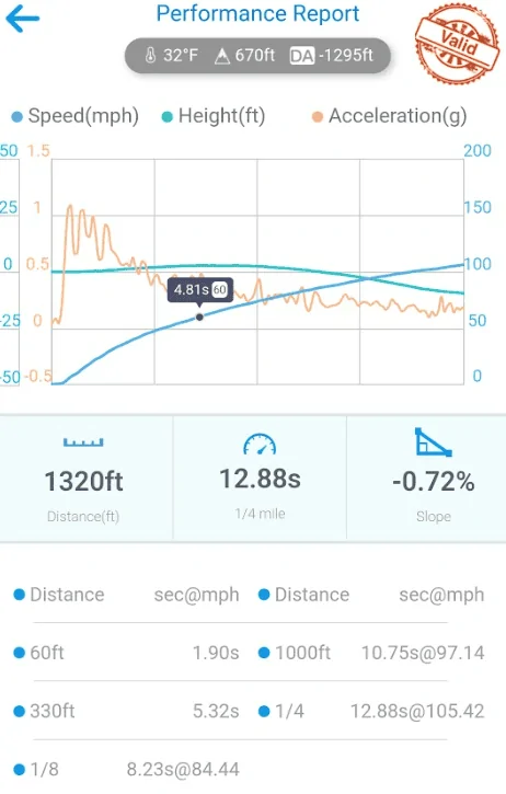

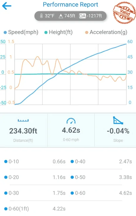

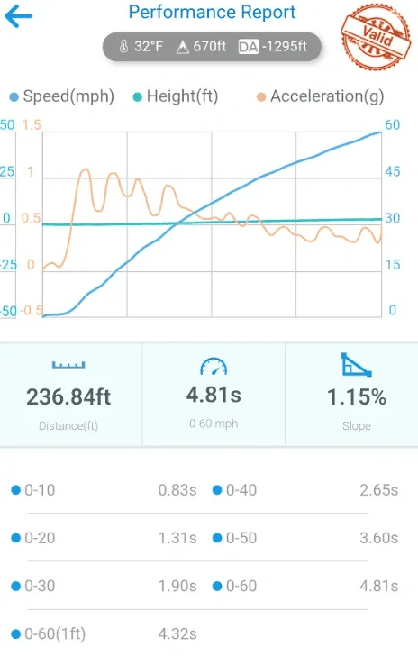

Data Dump -- Found a spot for quarters, starts out 1% up hill, else fails due to a dip. Traction limited, spins all tires on launch :( -- Grill slats are in-place, no intercooler slats. I suspect had I forced them open the engine heat soak described below would be mitigated.
The quarter 2 file I got back in it to check intercooler temp and it was already back to ambient. Not sure where IAT is, based on temp somewhere under hood, IAT2 I believe is behind throttle body. Not sure of the accuracy of the AAT from the mirror which is reporting to the ABS ?‍♂
Collected data points on heat soak, 95% sure it's NOT the intercooler, I believe it's everything else (turbos, charge pipes, intake, etc...). I shaved 4 degrees off by not letting the truck sit for 40 seconds or so (the faster I turned around and went, the cooler IAT was as everything just had 30 degree air moving through the engine bay).
This is a state highway and the truck was unloaded from 75mph to a stop, as soon as it stopped, ICE shuts off. Having such a low temp helps to remove ambient from the equation. I believe heat soak is indicated by variable IAT (PCM variable "IAT")
In the Q2 spreadsheet you'll see the hybrid motor regen the trans shifts helping spin down the ICE as it upshifts. Still entertaining to see.

Had to let out of this one due to oncoming vehicle, would have been the best run
Ford F-150 Livernois upgrades 1710844293991-ui
Basic chart Q1 -- inferred boost - MAP less 14.4 (amb air press) (let out early it seems)

Quarter 2

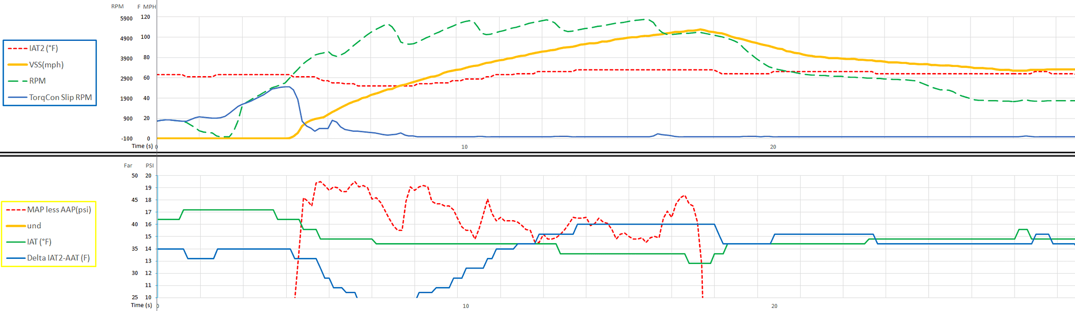

Extended where I got back into it to see intercooler temp Both mid run dip (52f IAT2) and getting back into it (also 52f IAT2) showed intercooler was already cold again as I theorized. As in by the time you stop after a quarter the intercooler is as cool as it will ever be. Intercooler doesn't "heat soak" at speed.
Ford F-150 Livernois upgrades 1710848997646-8z

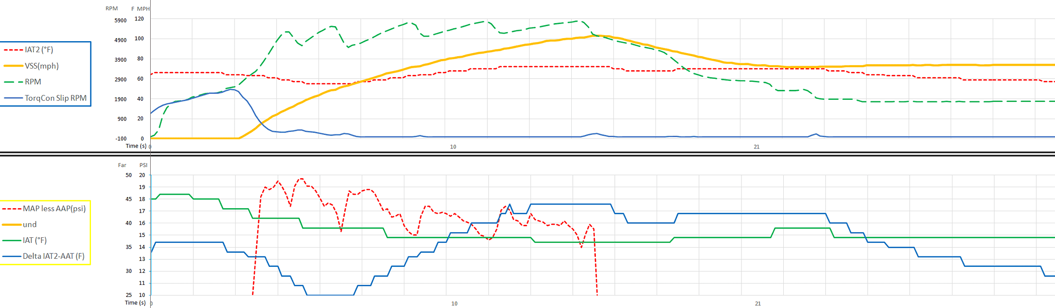

Q2 w/ the electric motor plotted -- you can see when I got back into the throttle and how long it took the downshift / boost build. See the hot air in the intake pipe? The 2nd I hit the throttle (shown by amperage), temps jumped up and then dumped. IAT must be near a turbo?

I felt this -- damn it. That's where peak torque is. There's a reason I was plotting slip RPM.
