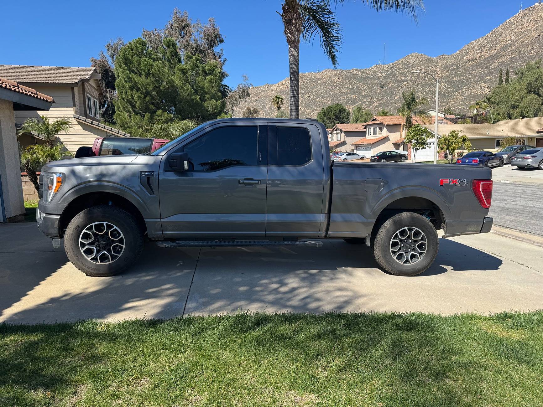

Possible to pre load them to 2.5” you think or will it affect the ride?
My truck was sitting about about 2.5" of lift over stock with the way these coil overs came setup, coincidentally the springs were also preloaded 2.5", and you got about .5" of adjustment in either direction. In my opinion if you are looking for 2-3" of front lift on these trucks any leveling coilover plus the tremor knuckle is the way to go.

Back together and that move brought the front down an inch, test loop felt much less topped out and better over small bump.

I was going to recommend a UCA to maximize that additional length (Travel), but looks like you handled it!
You stock front springs were probably 514lbs right?
Stock springs were 475. I don't think the OE upper arm limits travel before the CV on these trucks. The Icon upper added about 2 degrees of caster vs the OE at lift with net loss of 1 degree over spec. Truck corners more intuitively now, was my goal to keep tire wear reasonable.
Nice. You might want to look at the SPC camber and caster bolts too. I've got the HD kit that are much tougher than factory and allow adjustments.
That's solid advice, I actually setup the truck with that HD kit before I had the last alignment done. The factory bolts are really easy to shift.
Did some heavier towing this weekend, new suspension setup was killer for this load, incredibly comfortable and controlled.
