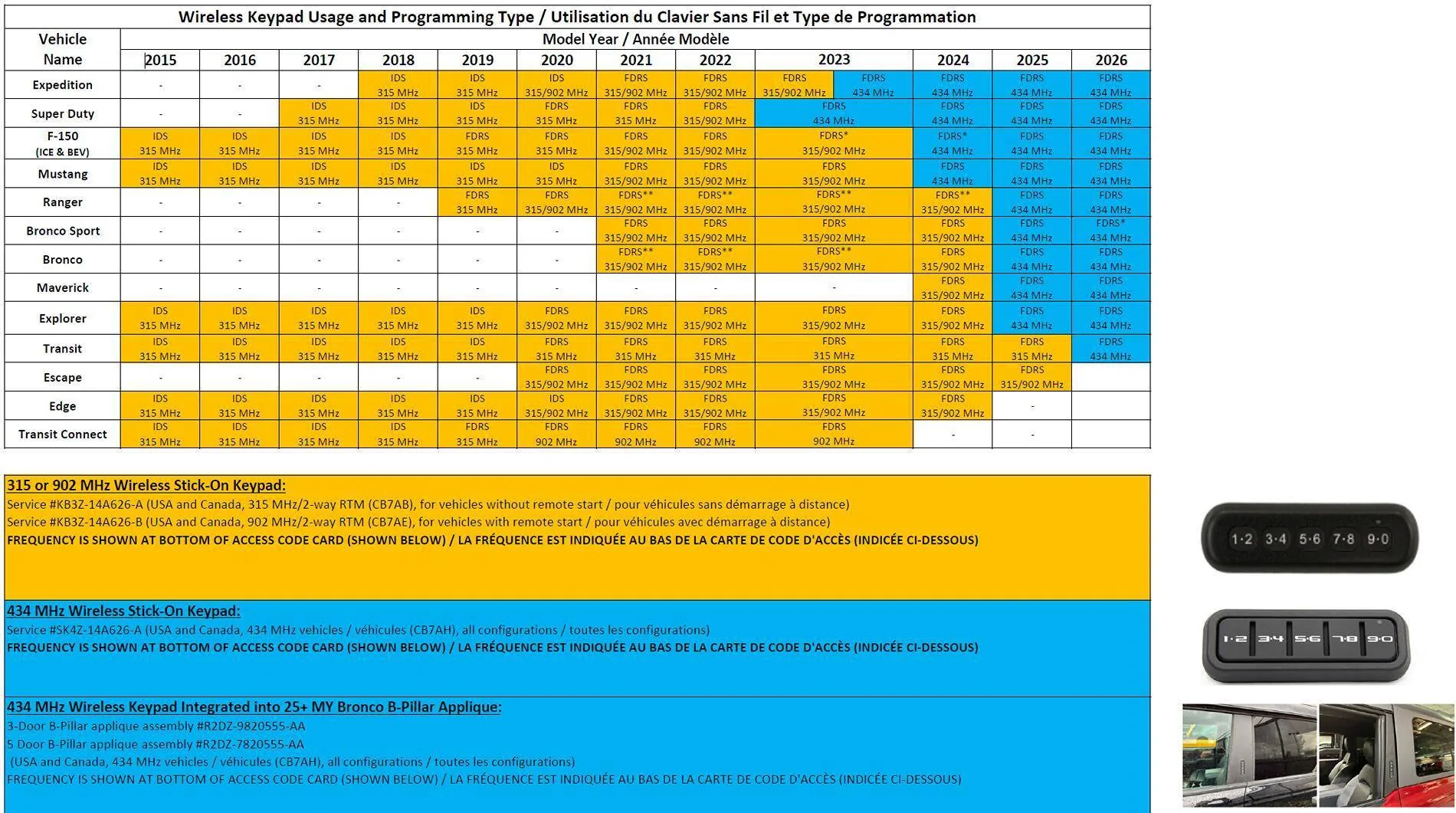

The two stick on ones in the link above won’t work on a 2024 or 2025 F150.
Ford changed the freqs that the keyless system operates to 434 MHz for the F150 In 2024. See chart below. You need to order SK4Z-14A626-A per chart below and then either have the dealer program it or do it yourself in FDRS using the linked PDF instructions below.
Don’t fret not ordering it, this is exactly the same stick on and exactly what they were going to do anyway as it would have been a dealer programmed option at delivery regardless, AFAIK.

yes but you need to buy a 2 day subscription for $50 and you need to have a Ford Mongoose cable ($575 last I checked on Amazon (or borrow one)) and also have a power supply capable battery charger.
I haven’t been able to find the 24+ stick on ones in stock, and I’ve recently had two orders cancelled when they seemed like they were in stock.
