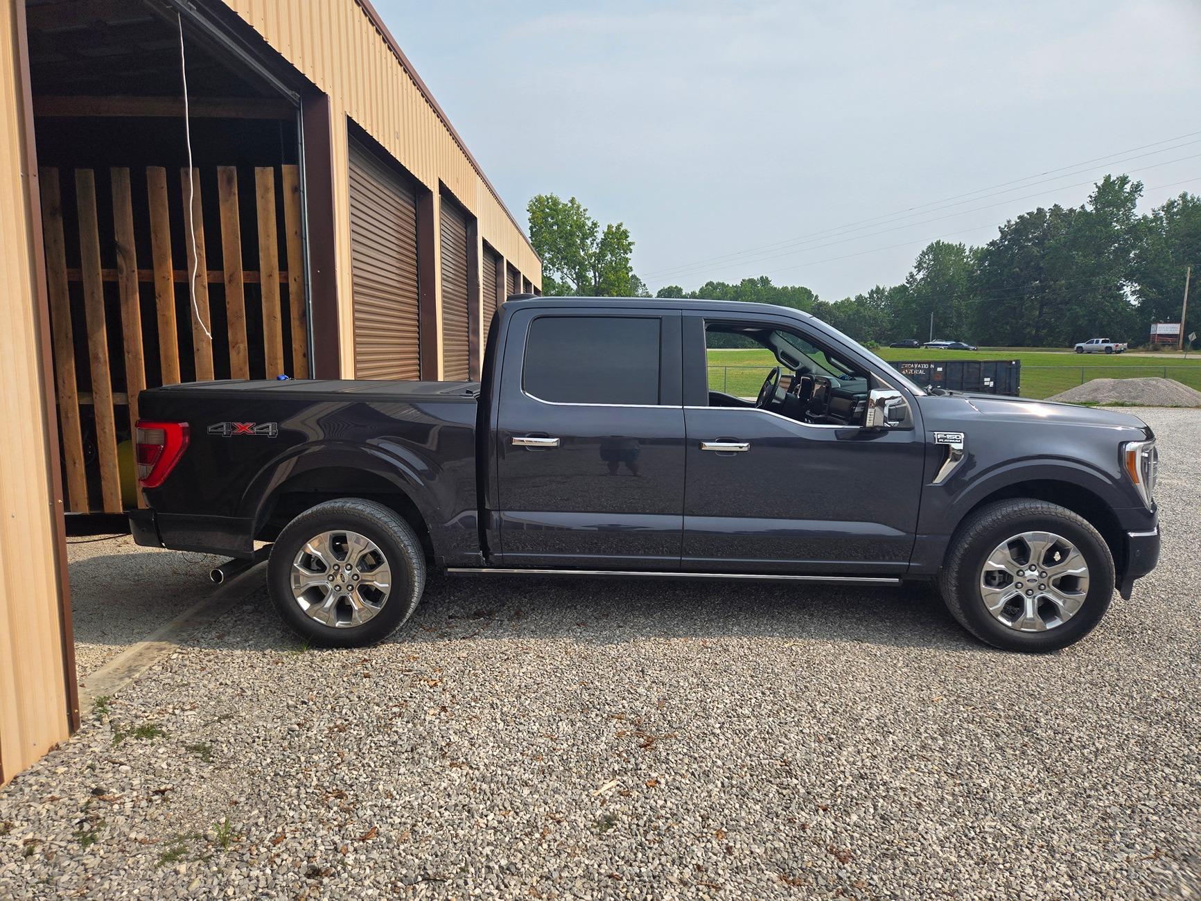

So wow, what a difference a custom boat trailer can make. Going forward I think we will just budget for a new trailer during boat purchases. A few pictures. First is the truck hooked up to the boat, boat still in the storage shed, but it illustrates the drastic drop in tongue weight. The truck is barely on the overloads.
Ford F-150 Just a Little Boat Upgrade & Towing Experience t
We went from almost 900lbs on the tongue to 350. I'm pretty sure I heard the F150 say thank you when we hooked up the new trailer. 350 is about 5% of the total trailer. Have I read that 5% is ok on tandem axle boat trailers? Sure have. Do I wish it was a bit heaver on the tongue? Sure Do. Not much I can do though and we don't tow on the highway so I will look at it as a great way to save some payload.
Second picture is a great example of how poorly setup the original trailer was. Note how much further the rear tandems are up on the custom trailer as compared to the junk universal it was sitting on.
Ford F-150 Just a Little Boat Upgrade & Towing Experience 20240726_160529
Hated spending the money, but think it will prove to be a great investment. It's crazy how many people buy six figure boats then put them on junk trailers. Doing it correctly isn't that much more expensive and will hopefully result in a much better and safer towing experience.
