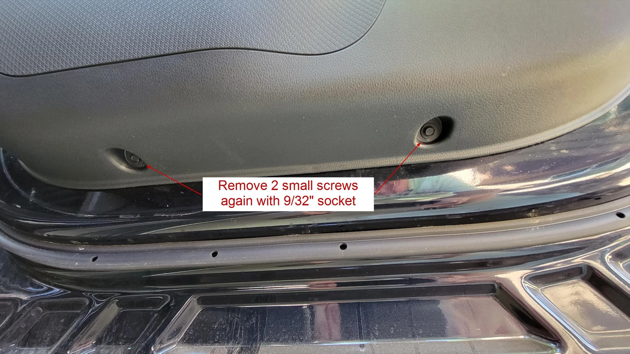

Bottom ofthe door panel has 2 screws

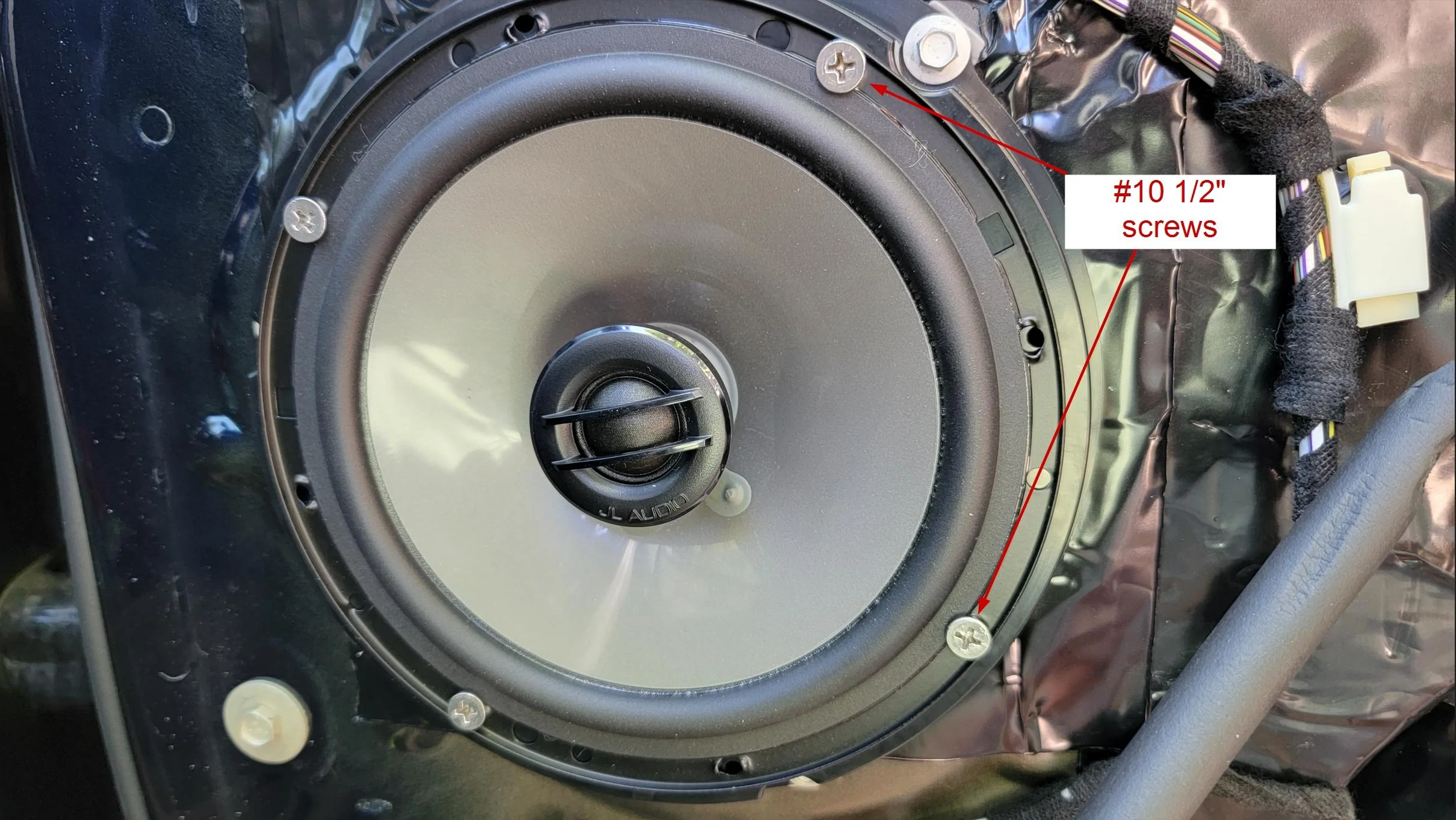

The #8 screws that came with the JL Audio speakers were too long and bottomed out against the door shell. I opted for thicker #10 screws with 1/2" in length. Four screws held the speaker very tight against the shell. Hard to see but I also Gorilla double sticky taped a ring around the speaker. (Optional and not necessary)

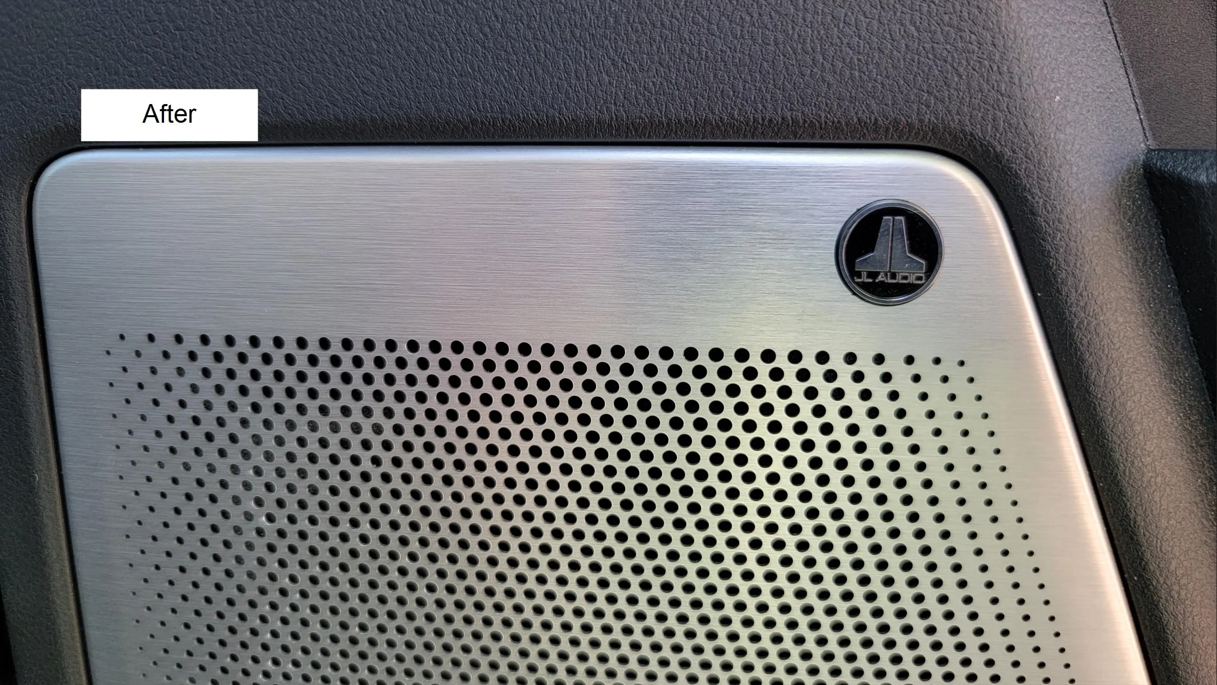

JL Speakers came with small little adhesive buttons, that JUST BARELY cover the B&O logo.... Why not right?
