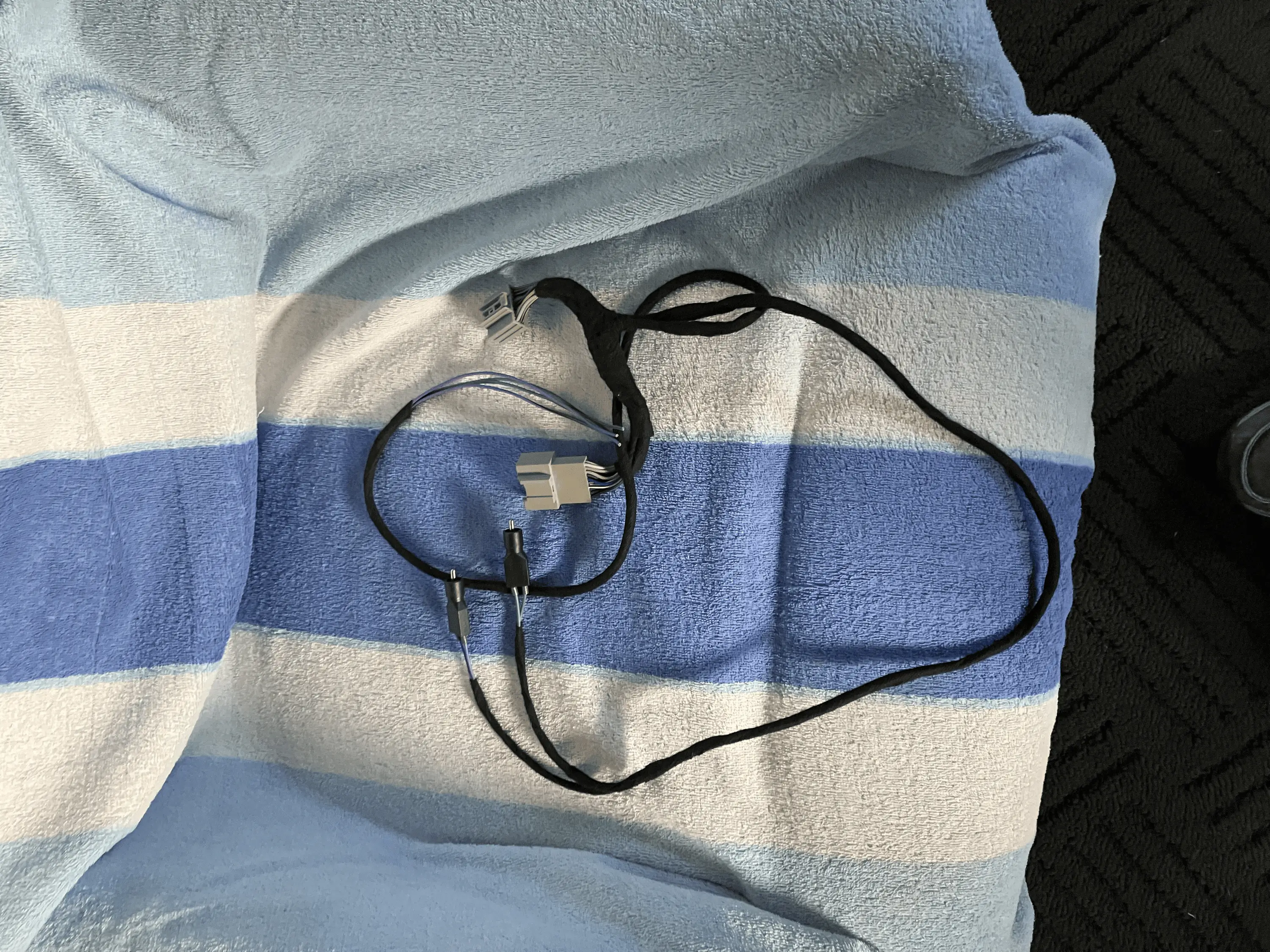

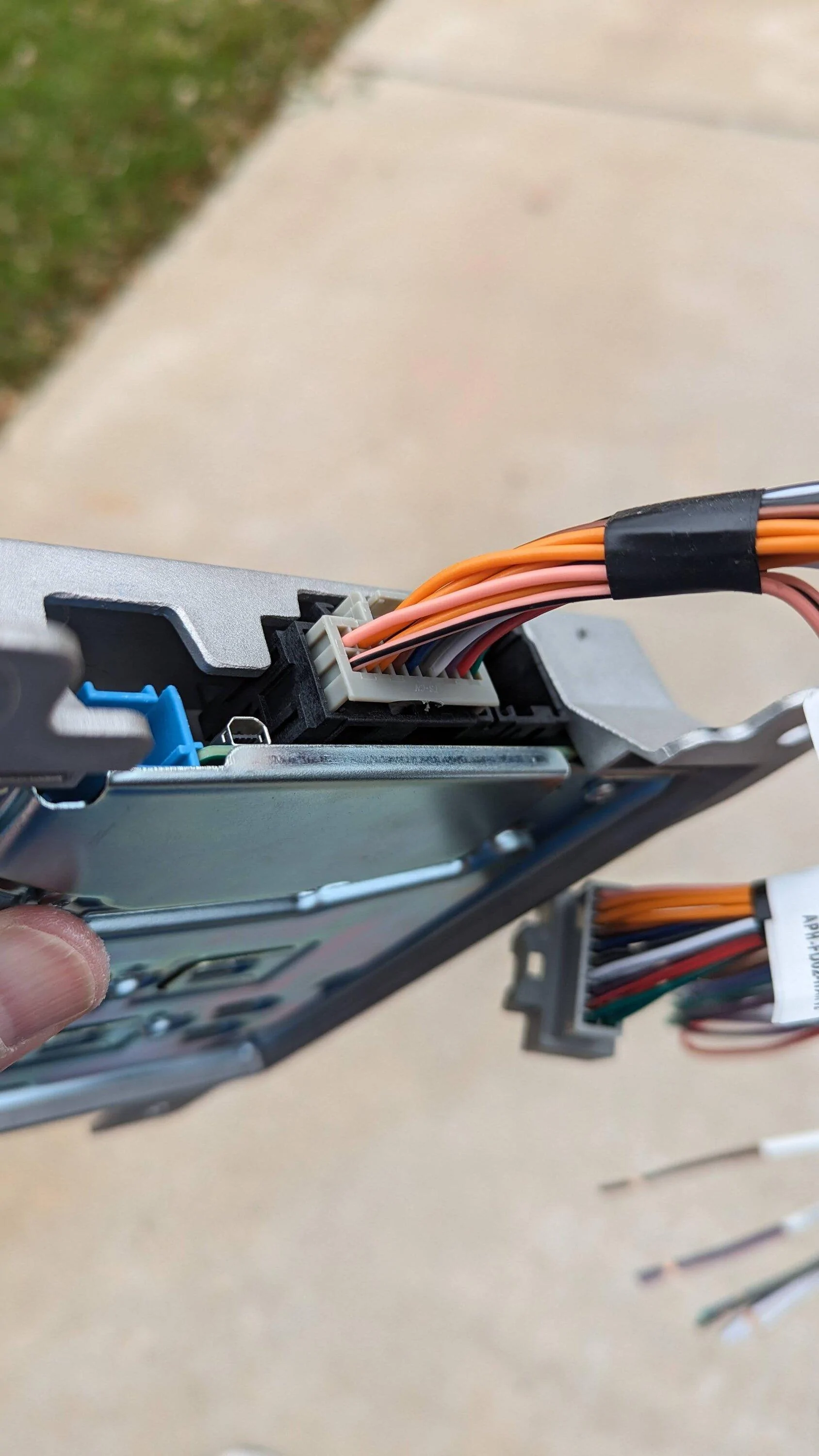

The no-splice harness listed at the top MUST BE SLIGHTLY MODIFIED to plug into the stock B&O amp. You must remove the piece of plastic circled in red. I used a Dremel.
Yes, it's ugly, but it will never be seen.
Now fits into the stock B&O amp.

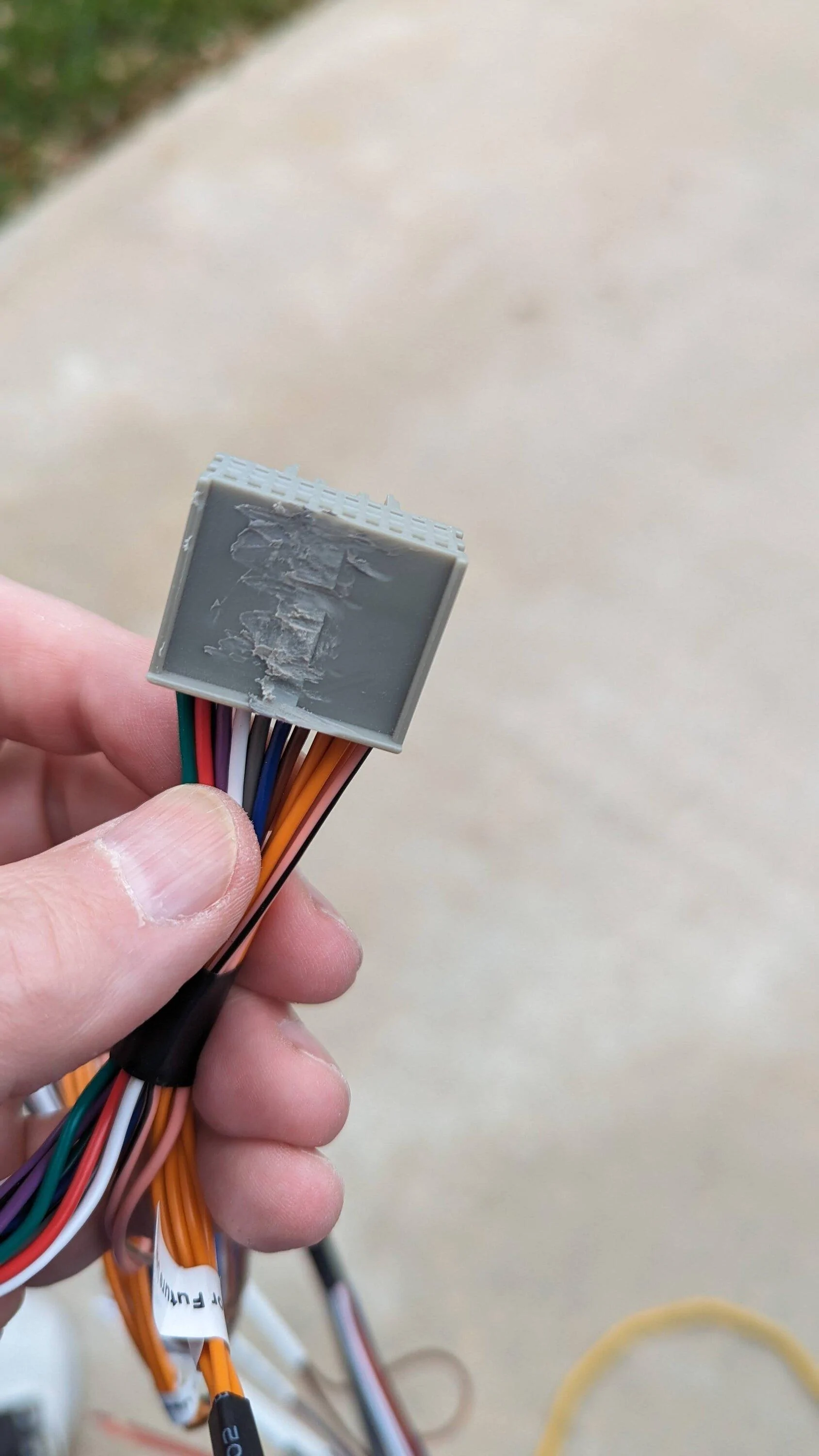

You MUST ALSO SLIGHTLY MODIFY the stock harness so the the other end of the no-splice harness will fit into it.
Again, used a Dremel.
Plugged into the no-splice harness.

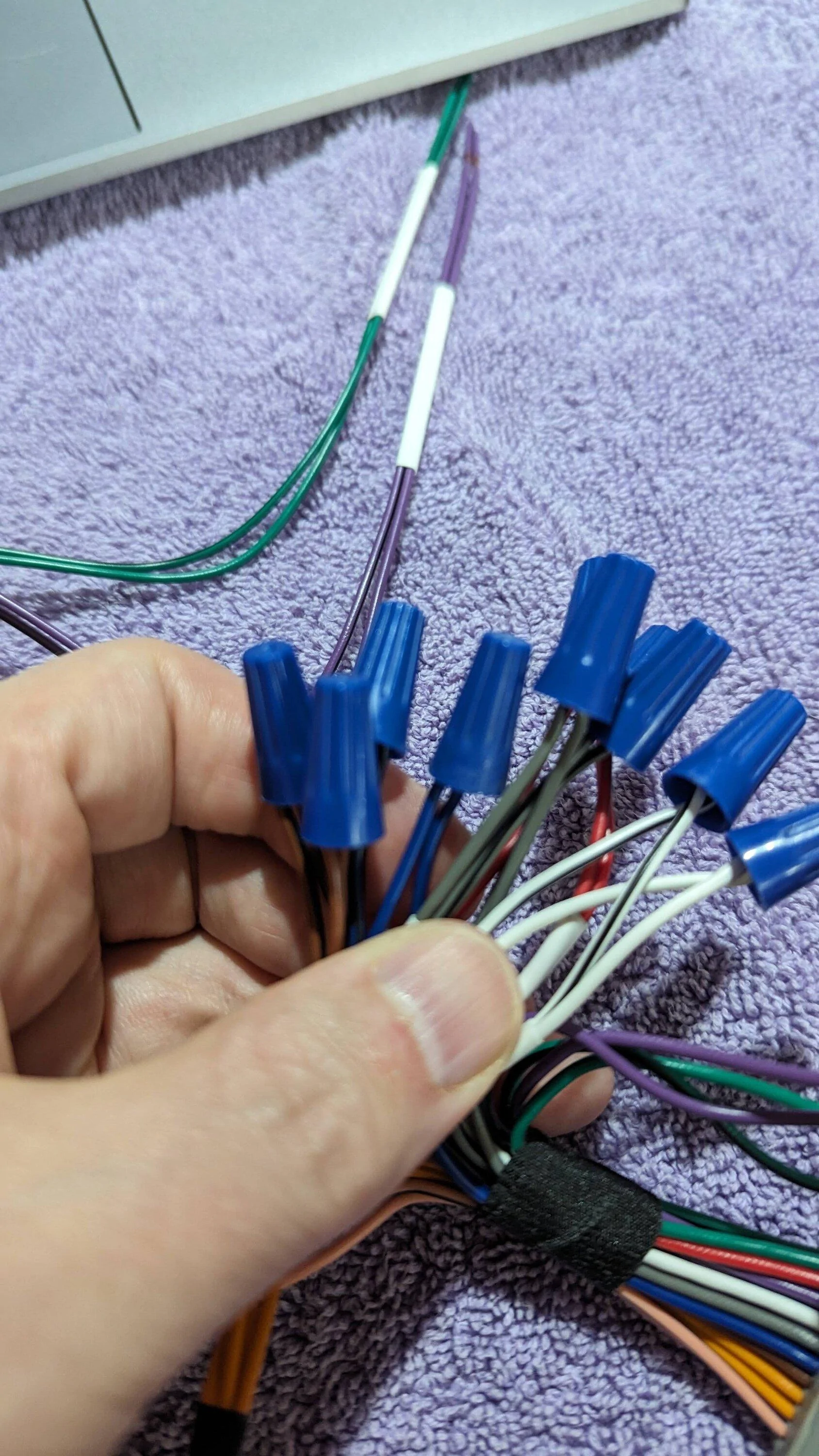

Since the JL amp only accepts RCA as an input (although they are high-level), you must connect the pigtails listed above to the no-splice harness on the B&O amp side.
Assuming you are only powering the two rear door speakers, all other loose wires on the no-splice harness must just be patched over. This allows the B&O amp to continue to power every other speaker except the two rear doors. I used wire-nuts just for the testing phase. Later, I cleaned everything up. Note that every wire labeled on the no-splice harness was correct (left, right, front, rear, sub, center, etc). There are also leads for Subwoofer 2, which obviously doesn't exist in my truck, but I patched it through anyway.
