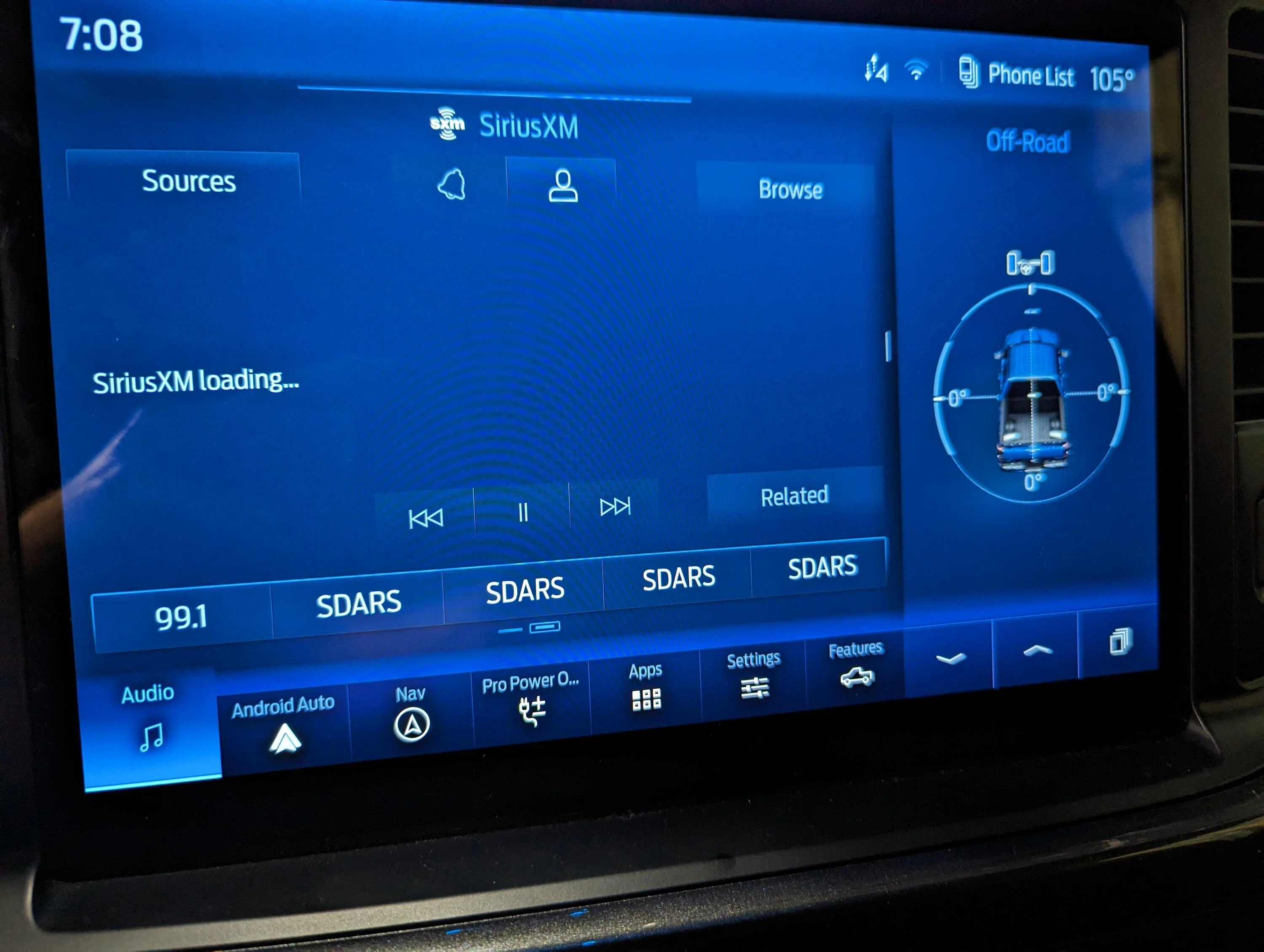

Has anyone else had this issue? When I try to change audio source to SiriusXM, there is no audio and it continually displays "SiriusXM loading...". In the SiriusXM area of the settings, it doesn't provide my radio ID. Seems to have started after receiving the 4.2.1 update. I have a 3 month paid plan with SXM and was working before. I've tried switching between sources, restarting the APIM, and attempted a refresh via the SXM support page without success.

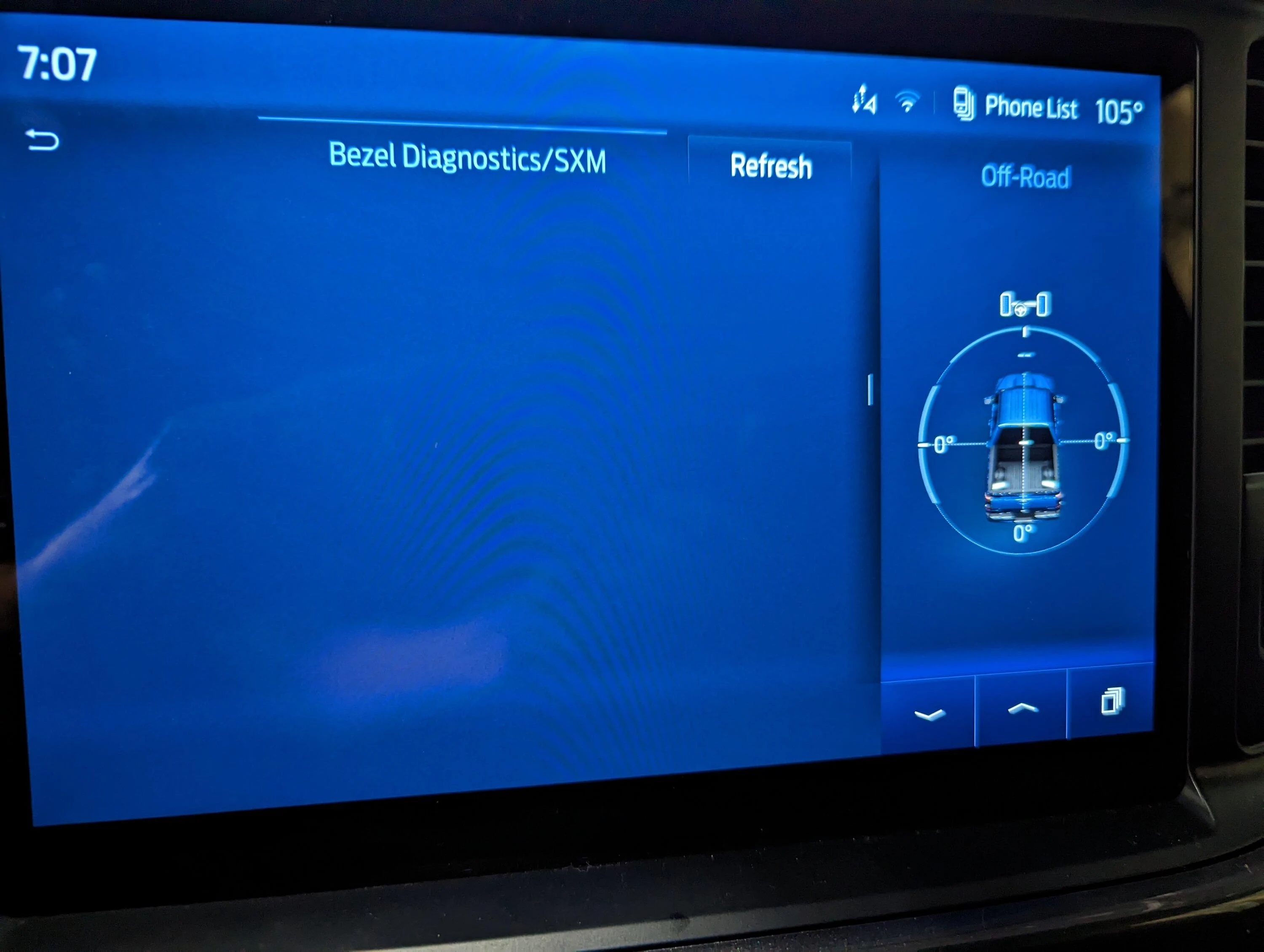

In diagnostics, the SiriusXM menu is blank.
All my previous SiriusXM presets now show SDARS:

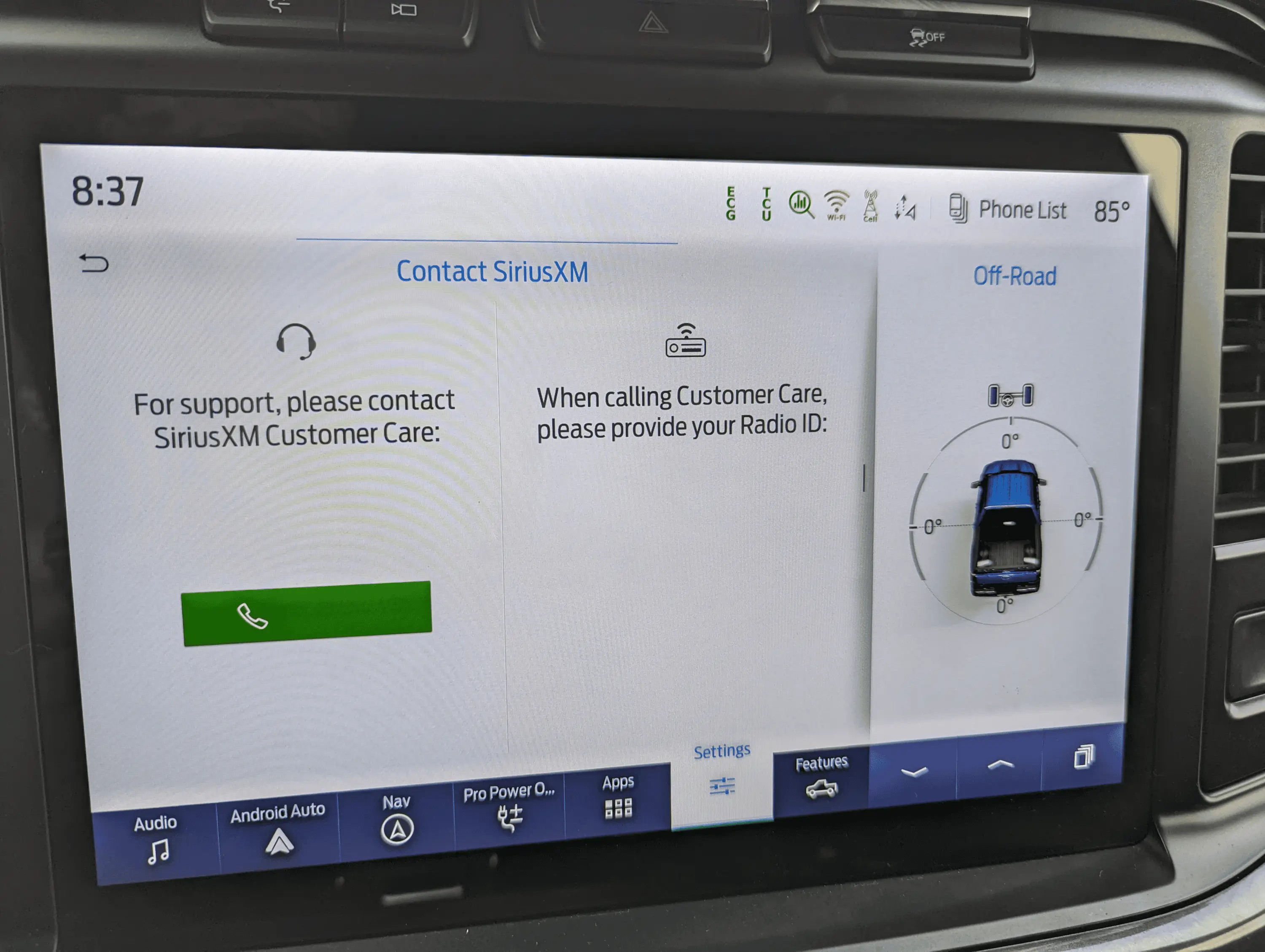

Radio ID is missing:

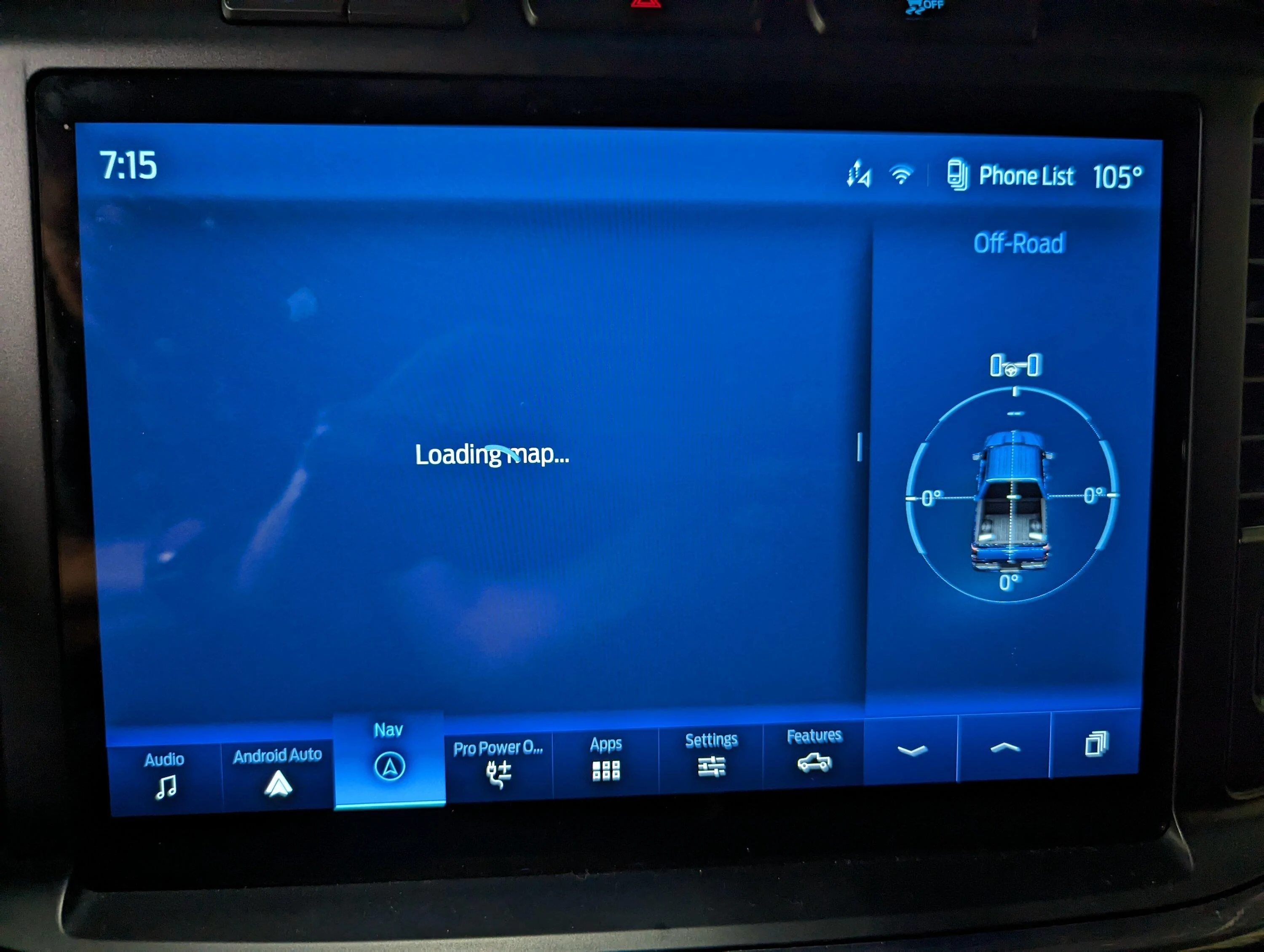

And navigation is still loading:

I still don't have Navigation - tried to go Settings then Nav back and forth several times.

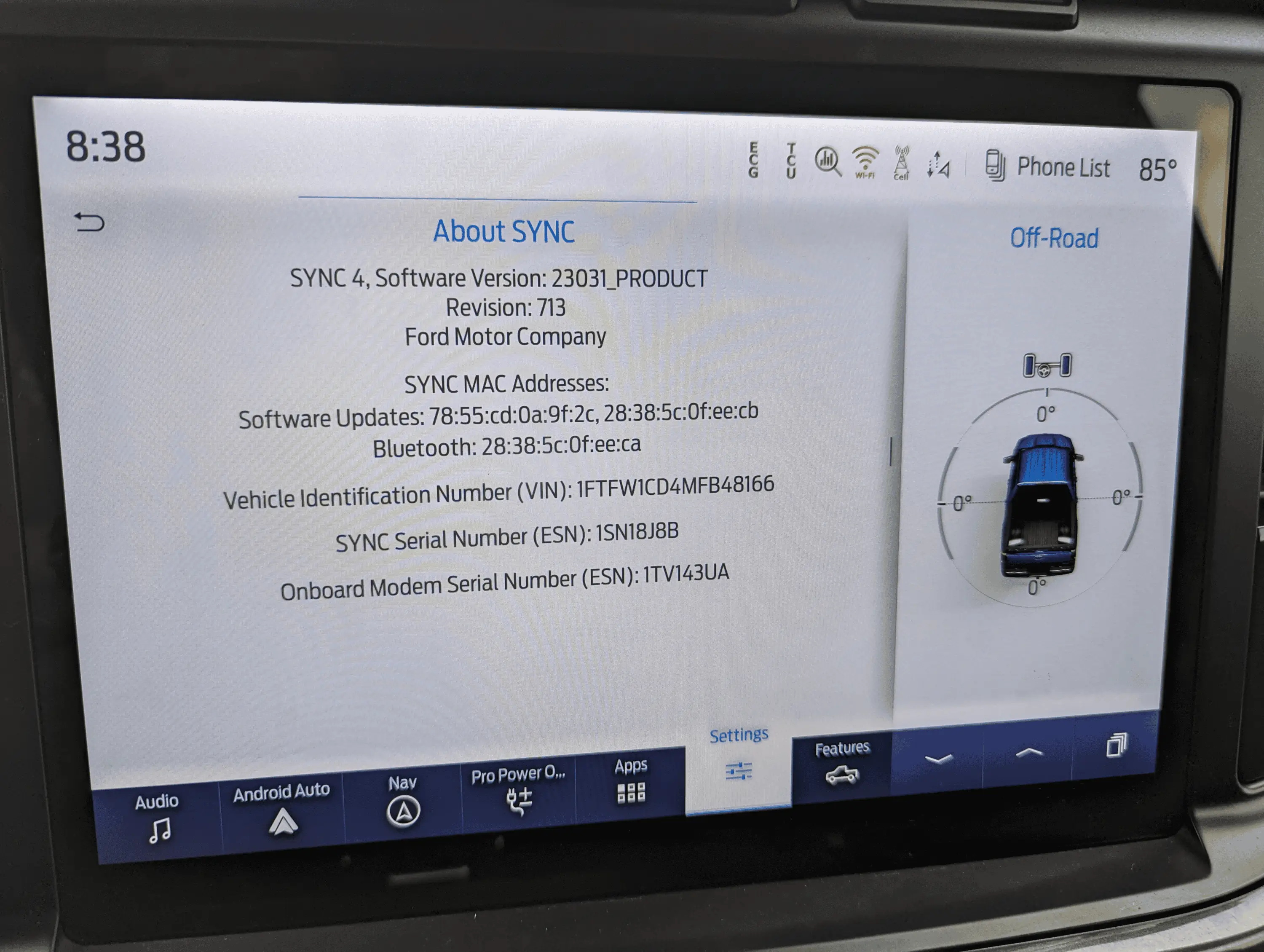

Exploring FDRS and looked up my VIN while not attached to the vehicle. Software version is partially missing (but based on a search that's normal for APIM?):
