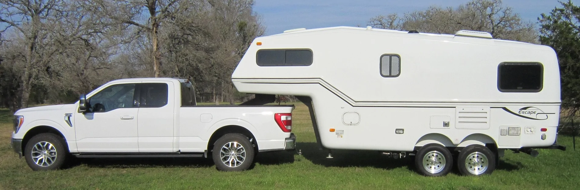

Is your trailer too long?
Nope.
Not just because the nose-to-tail length of my 5500# GTWR trailer is only 21', but the 'rules and equations' are completely different for a 5th-wheel with the pivot-point over the rear axle instead of behind the bumper. Yes, I'm well-within my truck's payload and all other load / tow ratings including frontal area.
My overall rig-length is actually 2 inches less than with my previous 17' bumper-pull RV.
I've towed in some really obnoxious wind situations .... "sway" just isn't in my vocabulary, the rig is always as steady as a rock. Gotta love a well-matched 'fiver'! 🤣 :wink: :)
