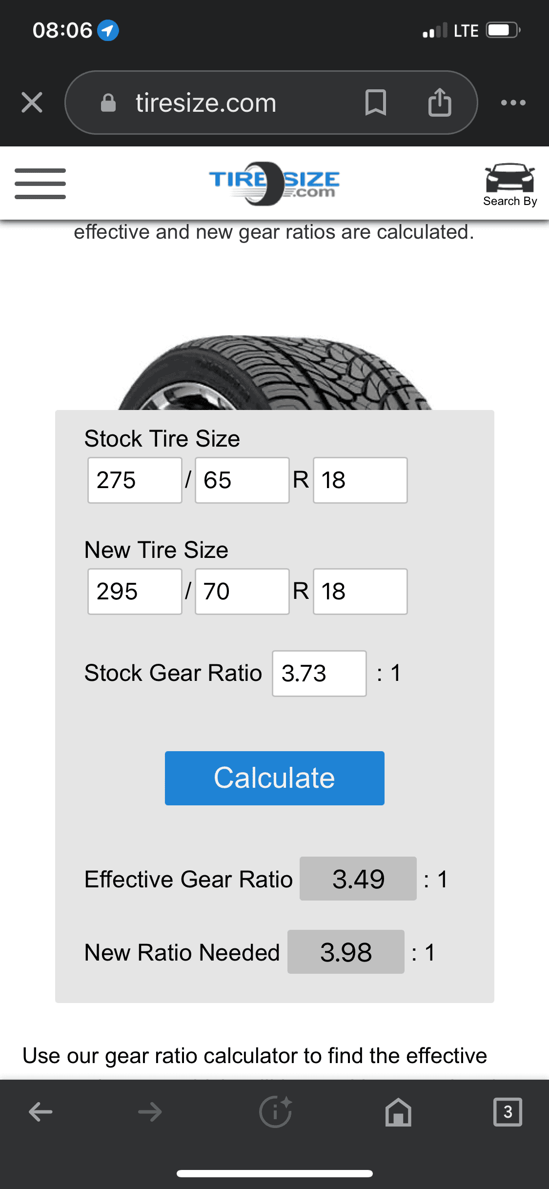

I s been posting alot guys because I am new to the whole lifted trucks and big tires. I was reading that when you go up in tire size you need to re do your gearing so the truck will run at it’s optimal with the new bigger tires. My 2021 F 150 Powerboost FX4 with a 3 inch lift. The stock tires were 275/65/R18 and the new tires I went with are the Nitto Recon Grapplers LT295 /70 R18 129R E1 BSW. We enjoy taking the RV out is why I went with E rated tires. I found this gear ratio calculator and this is what the results were. Is this really necessary, will my truck perform normal. I managed to get my speedometer within 1 mph under so I’m good with that. So If I do need to make the changes, can I change it using Forscan? Oh truck came with 3.73 gears. Any help would be appreciated.

I am not sure why- or how- you would modify your gearing for new tires. You want to adjust for any difference in rolling circumference for multiple reasons- but unless you are going extreme I think you should be good to go once that is accomplished.

Aired up load range Es will help stability and sidewall squirm. Not sure on trailer weight but keep an eye on payload as you will run out of that capacity before you hit GCVW (check driver door placards).
With the 10 speed you will be fine... May not run in 10 or in electric as much but there are a lot of gears to work with. Enjoy!
You can't modify/change gearing through technology. To change gear ratios, you must physically change the ring and pinion gears in the rear axle.
