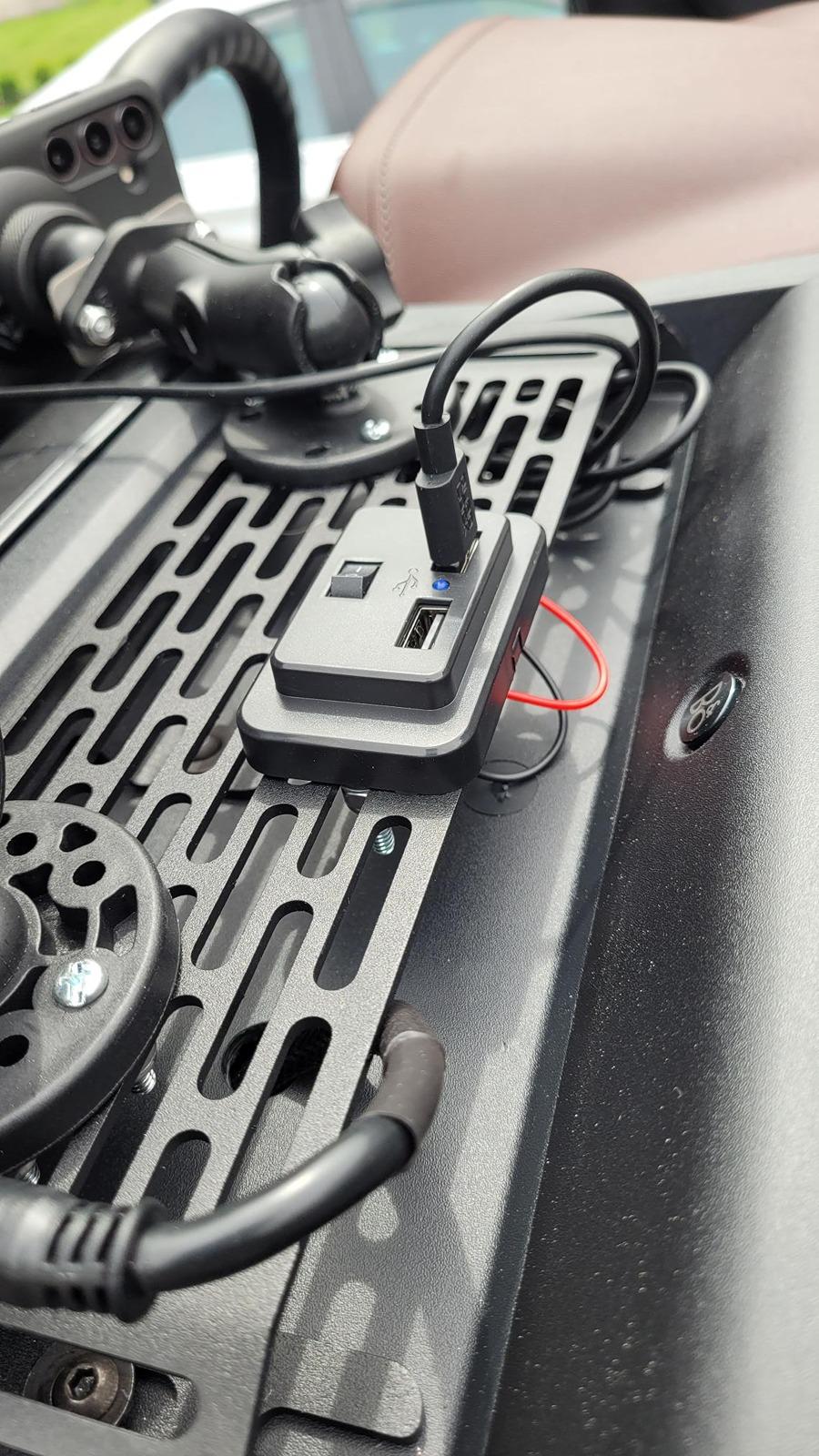

Tap the fuse panel under the passenger kick panel, run a wire to a USB switch or plug, then run it up to the cubby on the top of the dash. It's easy to get that cubby off and the glovebox comes out real easy - making it simple to fish a wire through. I added a Builtright dash mount and mounted the switch to it, but you can simply mount a USB switch to the cubby if you like. Super easy.
Ford F-150 Is there a way to run a usb cable through the dash easily? 20240514_135029
Ford F-150 Is there a way to run a usb cable through the dash easily? 20240514_134932

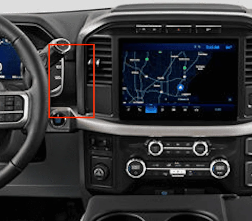

thanks! your charger is mounted to the right of the steering wheel? where did you mount the charger itself - into a cutout in the dash somehow?
I purchased this charger based on the recommendation of another forum member, it mounts with some VHB tape to the area marked in the red box of the photo below.
The screen is slightly obstructed by the wheel so if you want full visibility thats not the location for you but for me it was more for convenience and not about seeing the screen. My other requirement was I didn't want to block airflow from the vents in summer (I like my AC) or blow hot air on it in the winter making the phone even warmer than it already gets wireless charging.
I have the factory wireless charger but I didn't like the location and would frequently end up forgetting my phone in the truck, so it's more about being visible for me than anything else.
Ford F-150 Is there a way to run a usb cable through the dash easily? Screenshot 2024-05-23 at 1.55.13 PM
