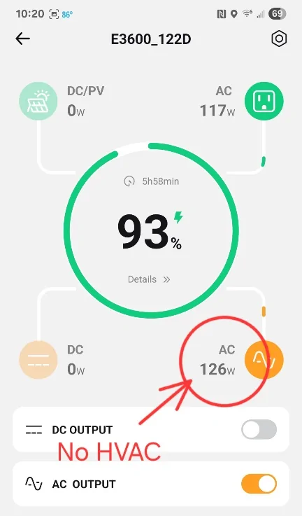

Well it's been just short of a couple of weeks since you asked. The first thing I did to prepare to collect data was to insert the 30 Amp solar generator between the Furrion Chill Cube and any shore power or the Powerboost.
The Solar Generator has a management app that makes it very convenient for monitoring inout/output current.
I quickly found that the RV is so surprisingly energy efficient that I decided to set the RV up this way semi-permanent.
The entry closet is a convenient place to just keep the generator "indoors", and I re-routed the RV 30A chord under the couch and into this closet. You can see it plugged into the front 30A receptacle.
I am charging the generator with a traditional 120V 15 Amp power chord and it is now the official external shore power port of the RV. So much easier to manage and handle, and available in every length imaginable.
After several days of running the RV like this, and in 100F ambient, I have found that I can set the charging rate on the solar generator to 10% (max charge rate is 3600 watts) and never need to be concerned with depleting the battery.
So
What you really want to know is how efficient is the Furrion Chill Cube?
First I had to establish what the baseline draw of the RV is without the Air Conditioner. That way we can at least deduct that value from the overall draw.
It's about 125 watts. That's basically the 12V fridge and a couple of 12V ceiling lights.

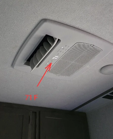

So I turn the Air Conditioner back on and the temperature was set at 71F
The current draw is now 475 watts.
Subtract the 125 and the AC is drawing 350 watts. It's amazing!
Admittedly I hadn't had the AC off for more than a couple of minutes, and the RV internal temp hadn't risen.
