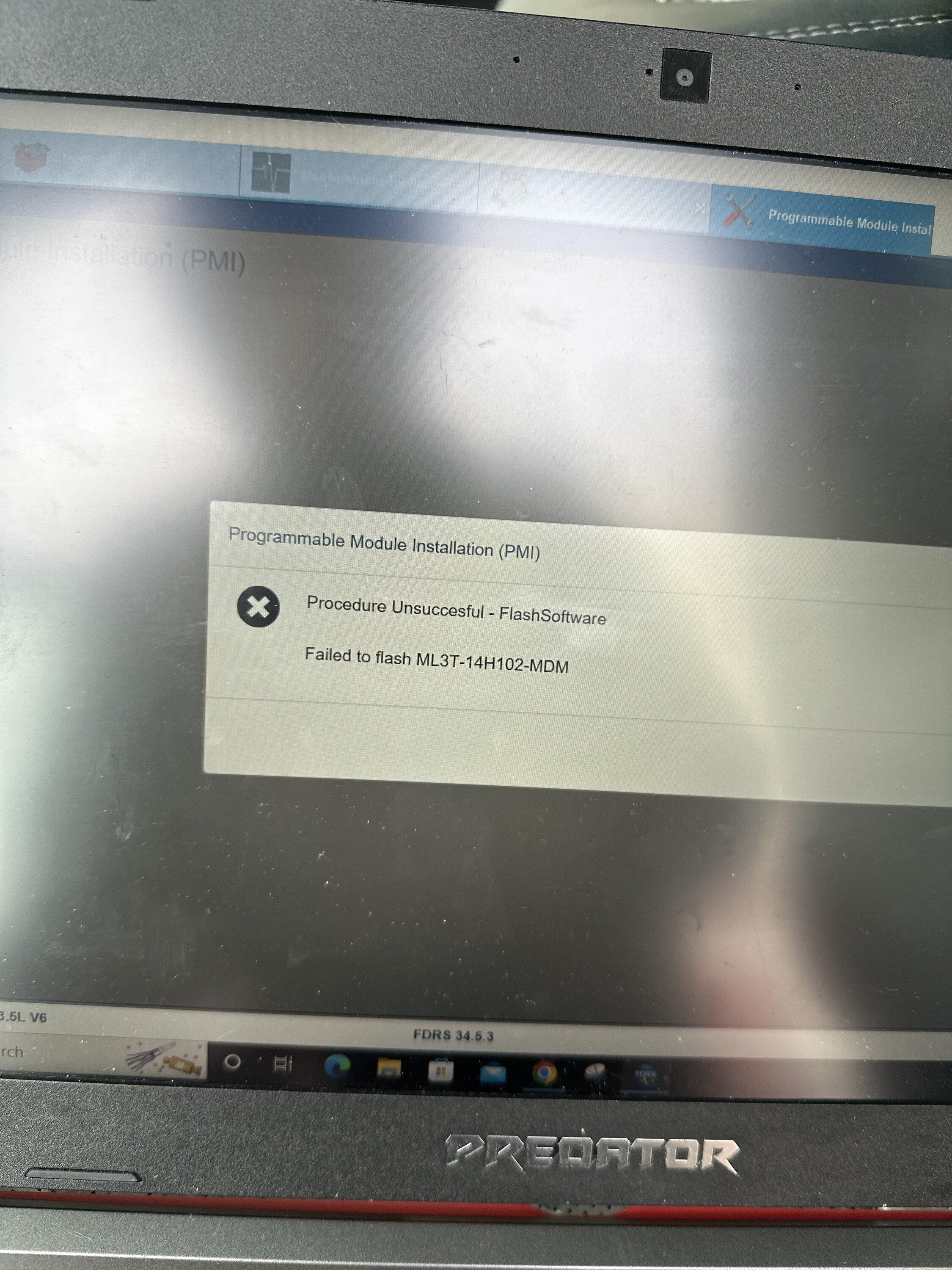

2021 F150 Powerboost Hybrid. So I tried doing a software update on my IPMA module and it ended up failing using FDRS, tried a PMI afterwards to try to get it back to where it was, programming fails, any ideas why it wouldn’t work? The module is purple now in FDRS, meaning it responded negatively, so it’s not completely dead. Getting codes from other modules because of the IPMA, the IPMA is at fault because of the update failing. Any ideas?

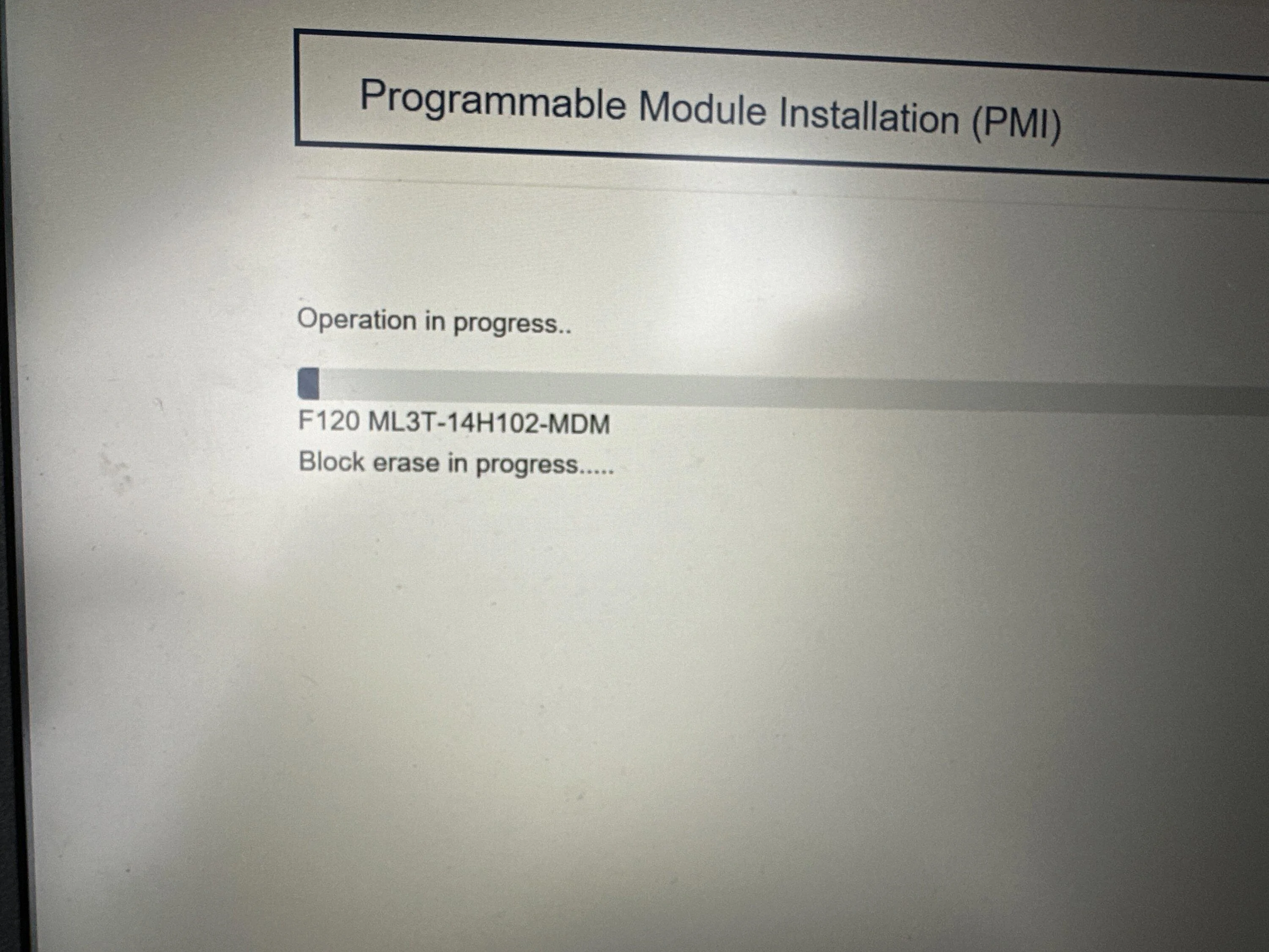

It completes the 5 steps with the blocks but then says it’s failing after “block erase in progress”. In hindsight, it makes me wish I never tried updating anything.

What pass-thru are you using? Battery voltage? SSM 50388 wants a minimum of 12.6VDC for flashing the IPMA.
Also it's the weekend when FDRS is known to go down for maintenance. No need to panic just yet.

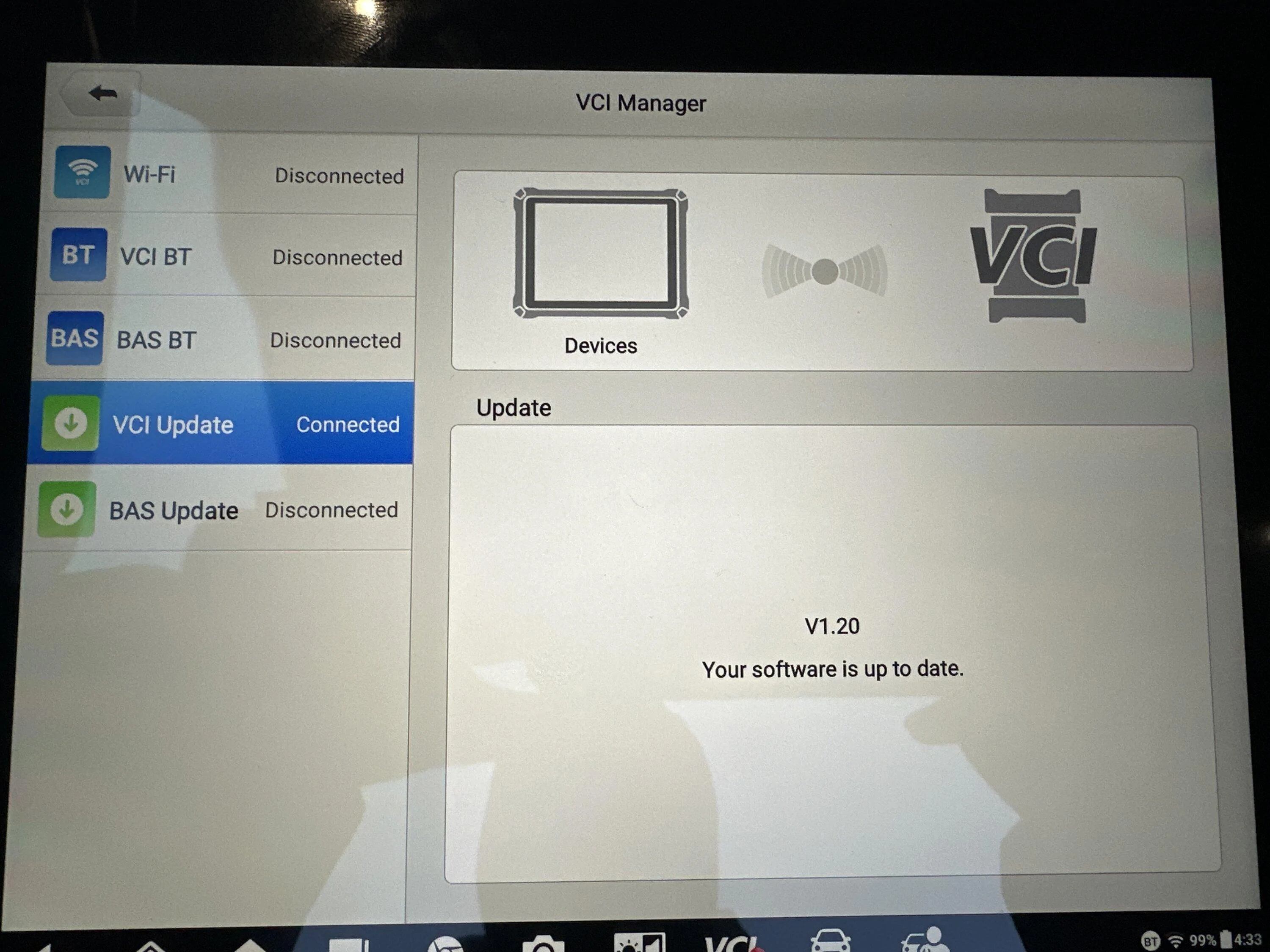

Is there any driver update available for the Autel?

It’s up to date according to the autel scanner, I also just downloaded FDRS yesterday so everything should be latest version
