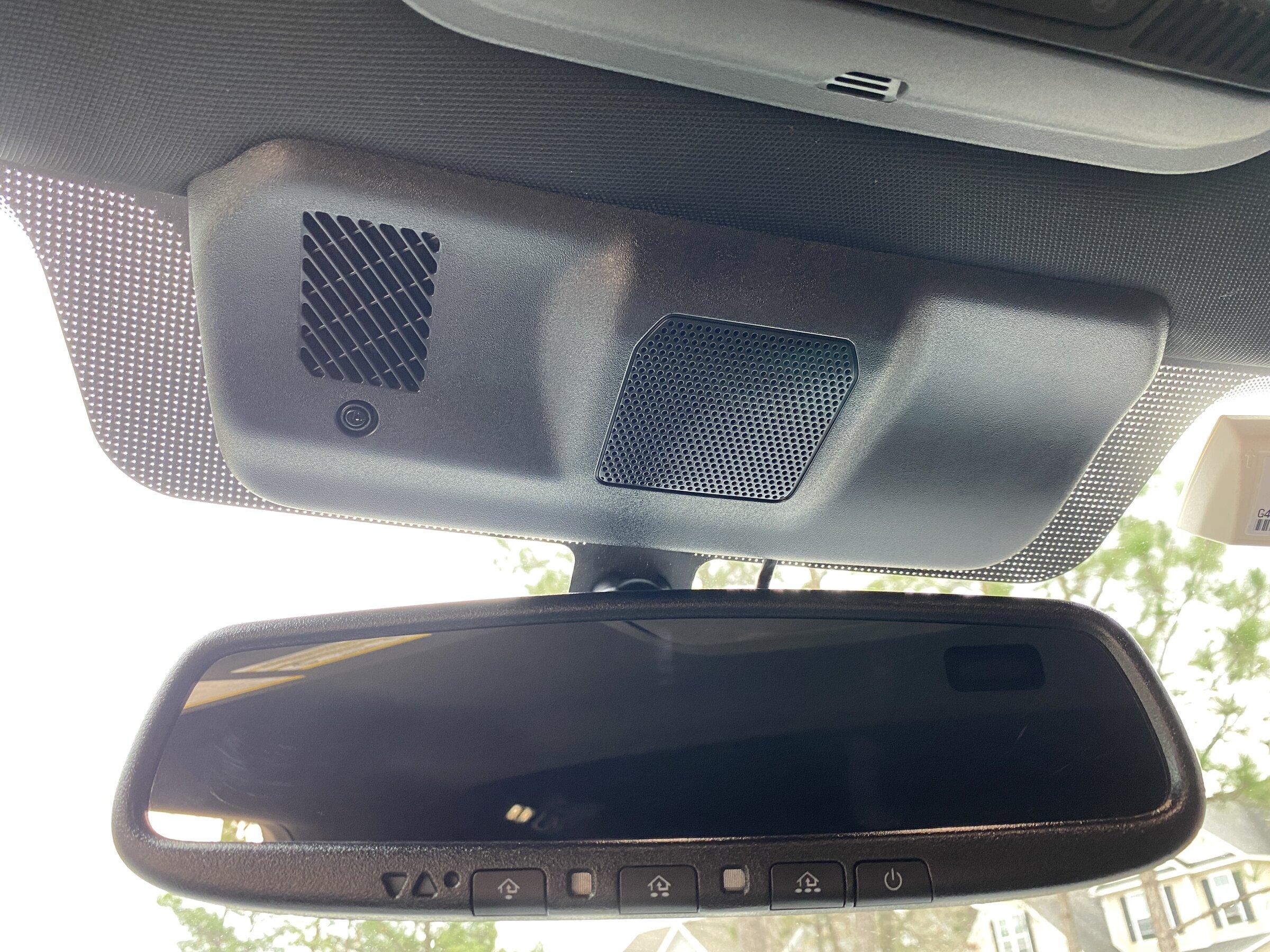

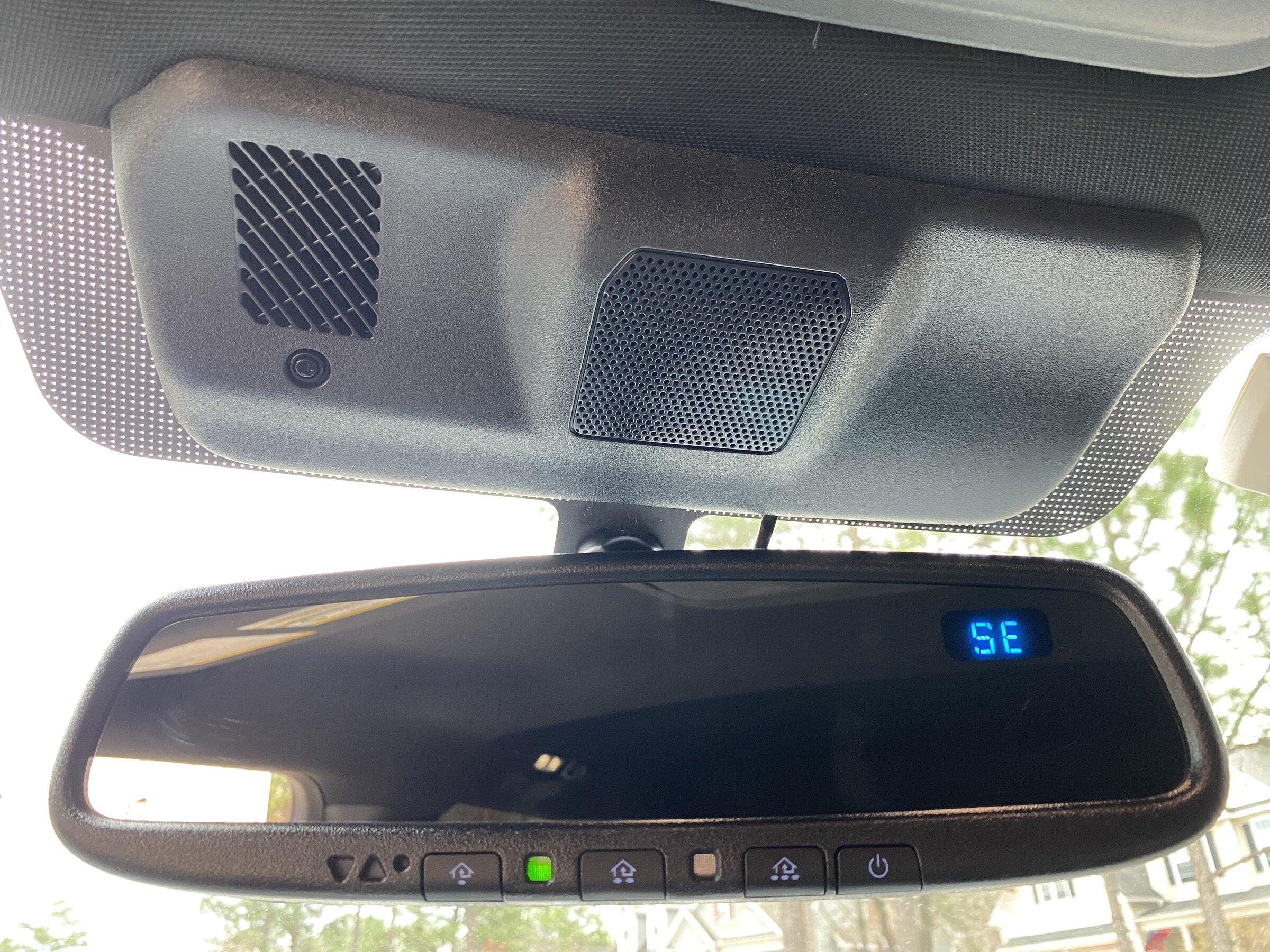

Gentex homelink V5 from bob's automotive mirrors.

You happen to remember how many pins are in the connector? Also, any idea where the compass information comes from? Is it built into the mirror or coming through one of the pins in the connector from the truck's compass/computer info? Thanks!

I think the compass information is in the mirror because when i hooked mine up i had to drive in circles to calibrate it. Here is a link and one of the pictures it shows the adapter.(not sure if thats what you are looking for)

1)The kit i got from bobs comes with a adapter to make it plug and play. Maybe the adapter has something to do with it working and not working when the truck is off or on. My homelink does not work if the truck is off. Pretty much when the light is on on the mirror homelink works. Check and see if you have the correct 12v source. if its always on or on with key. 2) I never knew these two things were connected. I never really knew the sides dim. Everybody's lights blind me at night no matter what. I'll have to pay attention to this. So if are truck came with auto dim rearview the sides should be auto dim also?
