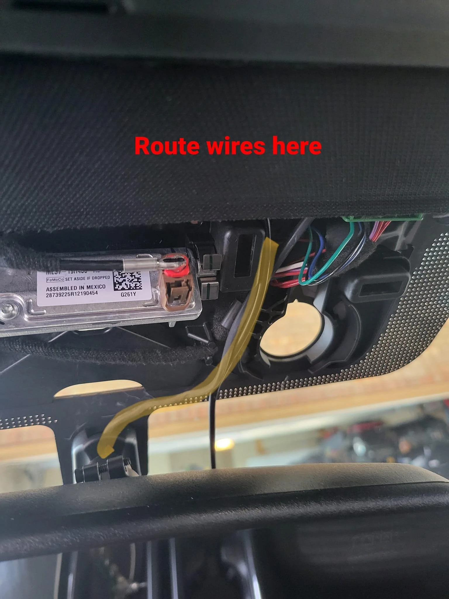

Ford F-150 Installing Ford's HomeLink in a XLT. 267583973_4948648561826259_2564257309193344068_n
Ford F-150 Installing Ford's HomeLink in a XLT. 267402512_4948648958492886_8318354594129573895_n
Ford F-150 Installing Ford's HomeLink in a XLT. 268034886_4948649155159533_6550703234147985548_n
Ford F-150 Installing Ford's HomeLink in a XLT. 267851870_4948648341826281_3035857038734299521_n

I'm guessing the thing that says set aside if dropped is the camera?
Nah, all of the comments are either; thanks installed it was easy, how do you pop the covers off, or poor 'pheasants,' should have got a loaded lariat.
Im not following, sorry. You do have to remove the cover which as the lane keeping camera in it.
You can read sticker on the camera in the one pic. It says if dropped set aside . Must be really fragile. Thanks for getting back. Looks like they are on backorder now. Everyone thinks it's a good idea.
