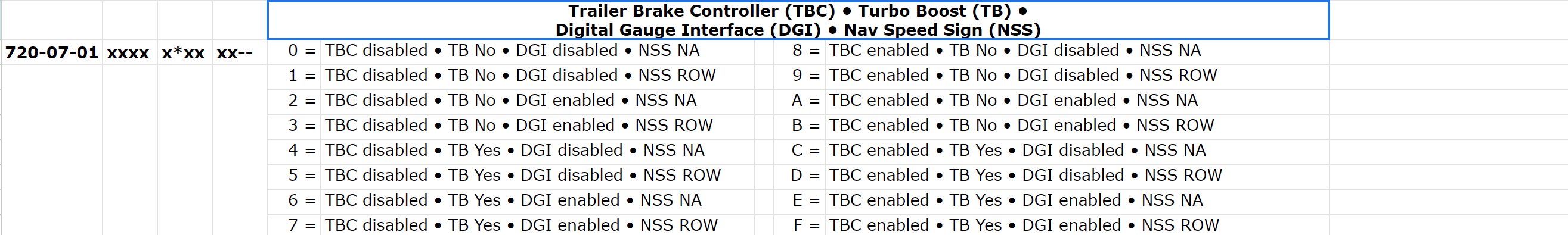

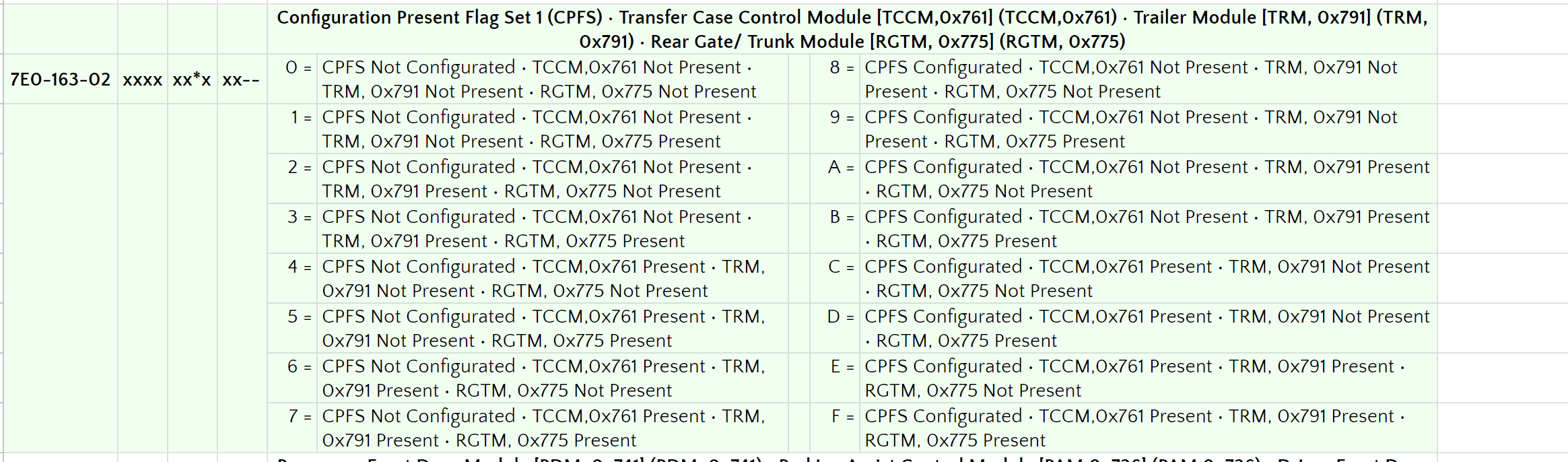

You do need to enable it in the IPC.
In the PCM and BCM its to enable the module is there so all of those modules know. THe IPC is to display the gain settings.
THere are even more things you could enable like the trailer settings if you dont have them in the APIM.
In the PCM you need to enable the TRM. There may be a user friendly Im not sure
Ford F-150 Installing factory brake controller? 1704718597784
In the BCM you need to enable
Ford F-150 Installing factory brake controller? 1704718948563
Ford F-150 Installing factory brake controller? 1704718683528
The IPC
Ford F-150 Installing factory brake controller? 1704719169372
Ford F-150 Installing factory brake controller? 1704719198702
Ford F-150 Installing factory brake controller? 1704718734234
If you have Bliss
Ford F-150 Installing factory brake controller? 1704719233688
