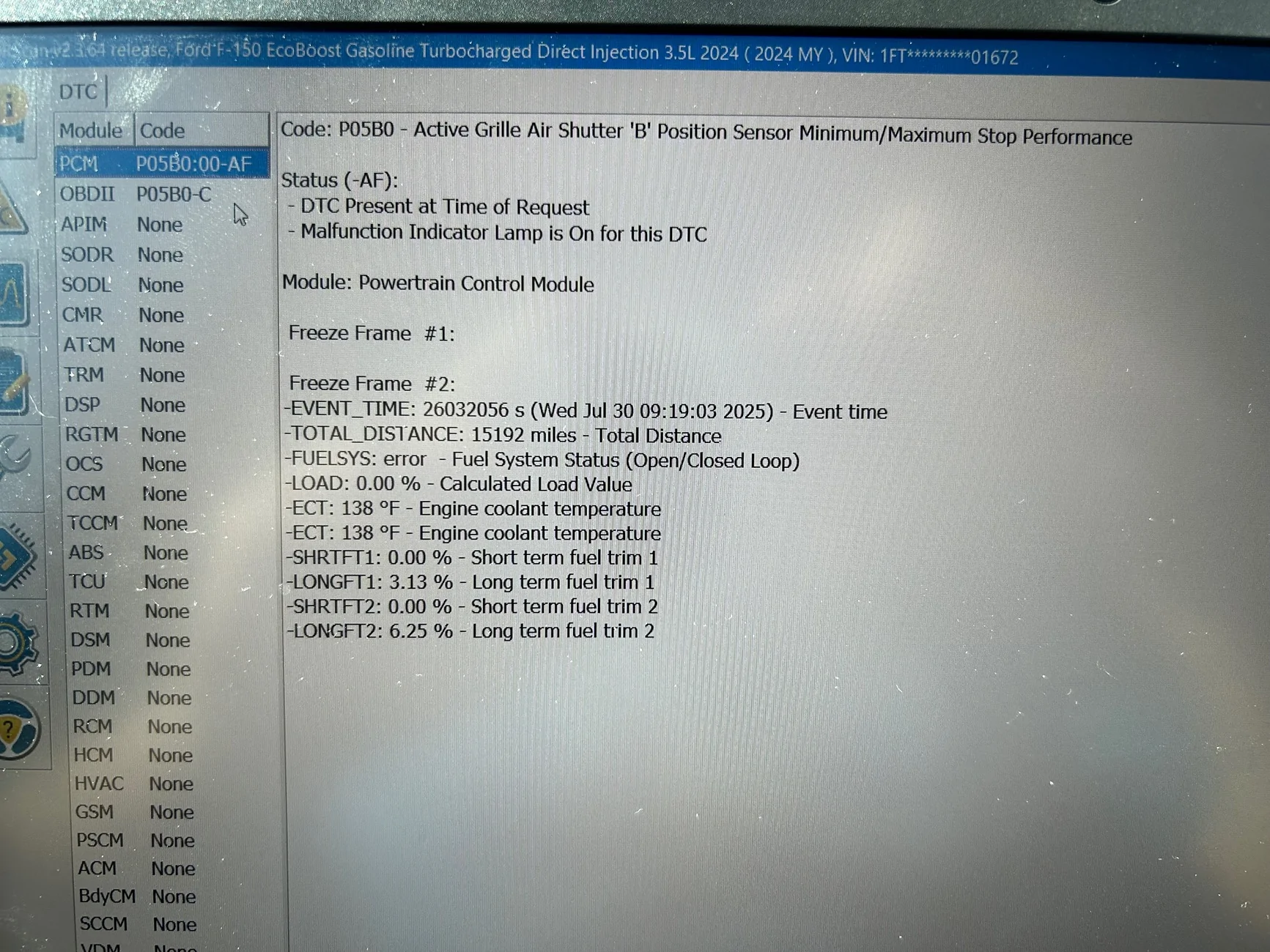

I recently installed the CVF Titan V2 intercooler on my 2024 powerboost… part of the install process requires removal of the lower AGS (active grill shutters). I had a check engine light pop up after install and it is P05B0 which is related to the AGS. I’ve looked for information on this and it seems the previous years may not have triggered a CEL. Anyone have experience with this and know how to fix? Thanks!

Same here, installed new V2 intercooler last night, left the actuator plugged in and just removed the slats. CEL is illuminated on the dash

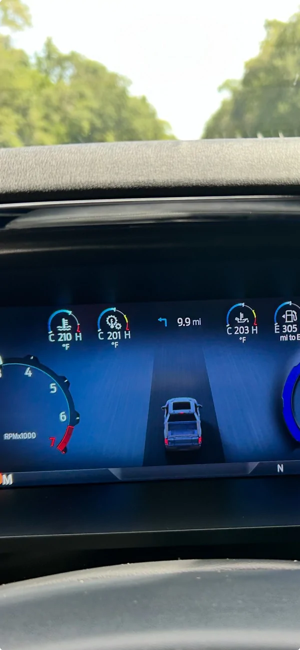

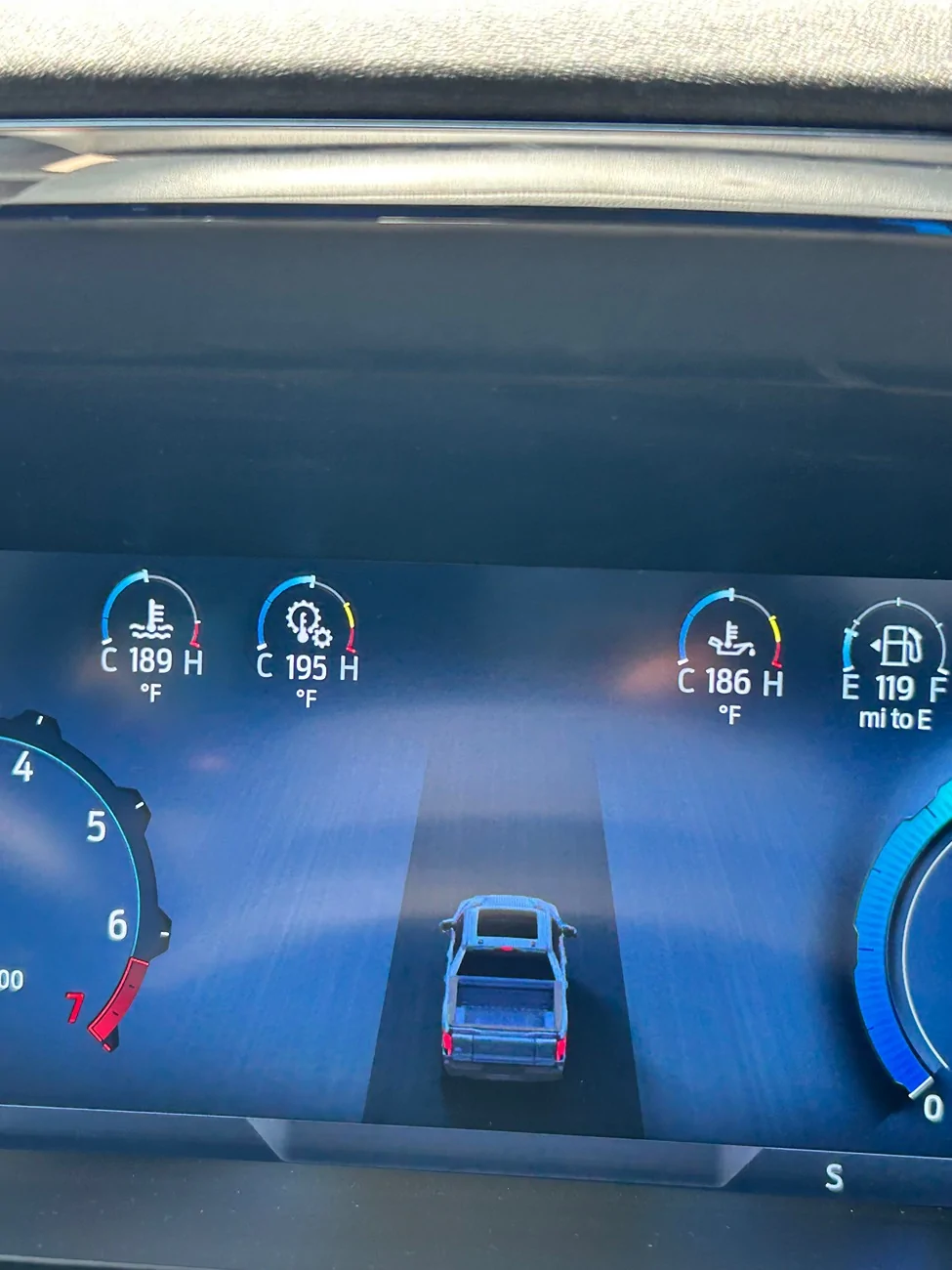

Don’t mean to hijack your thread OP but the people want pics! The CV Fab intercooler made a huge difference in these 100+ degree days in Florida
Ford F-150 Installed new Intercooler - P05B0 CEL IMG_1695
Ford F-150 Installed new Intercooler - P05B0 CEL IMG_1694
Ford F-150 Installed new Intercooler - P05B0 CEL IMG_1684
Ford F-150 Installed new Intercooler - P05B0 CEL IMG_1685
