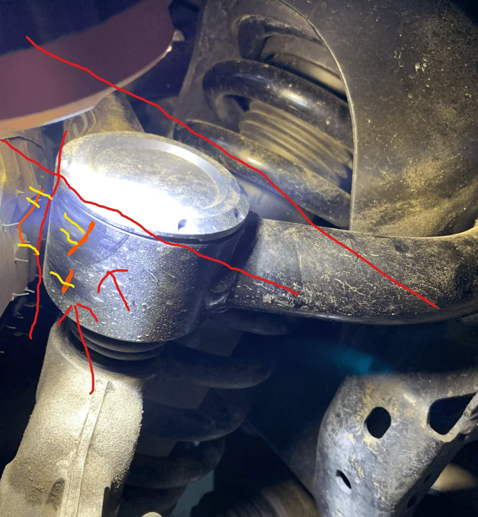

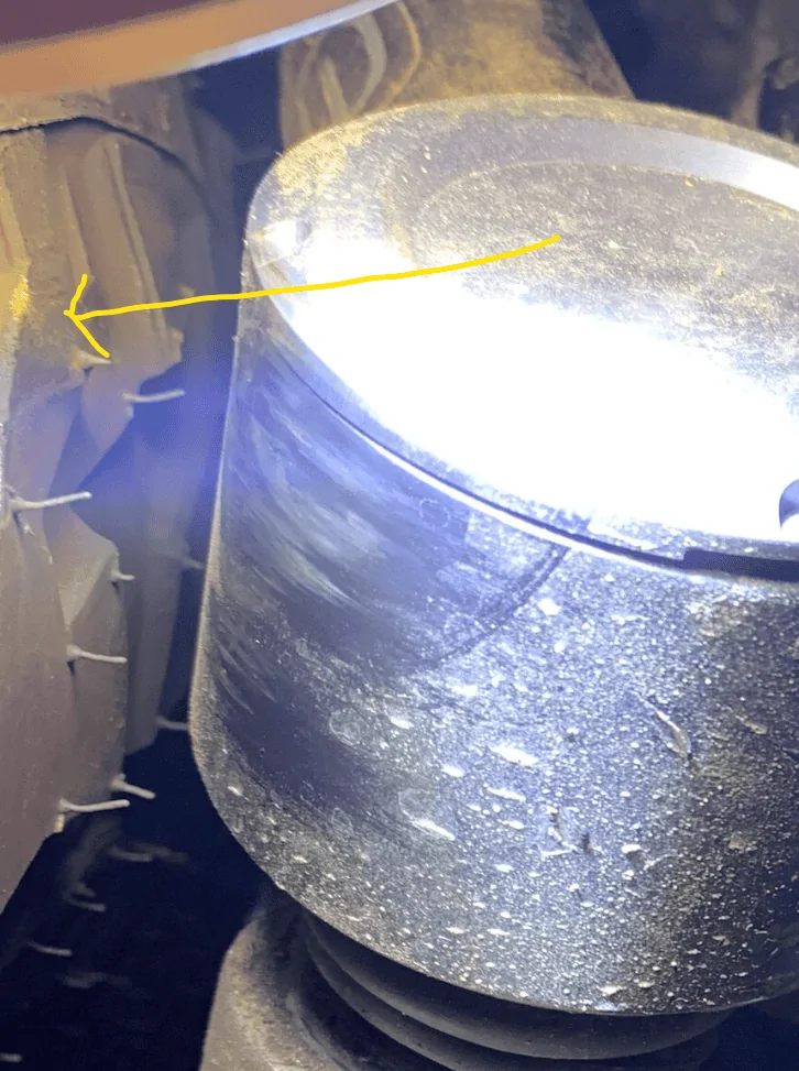

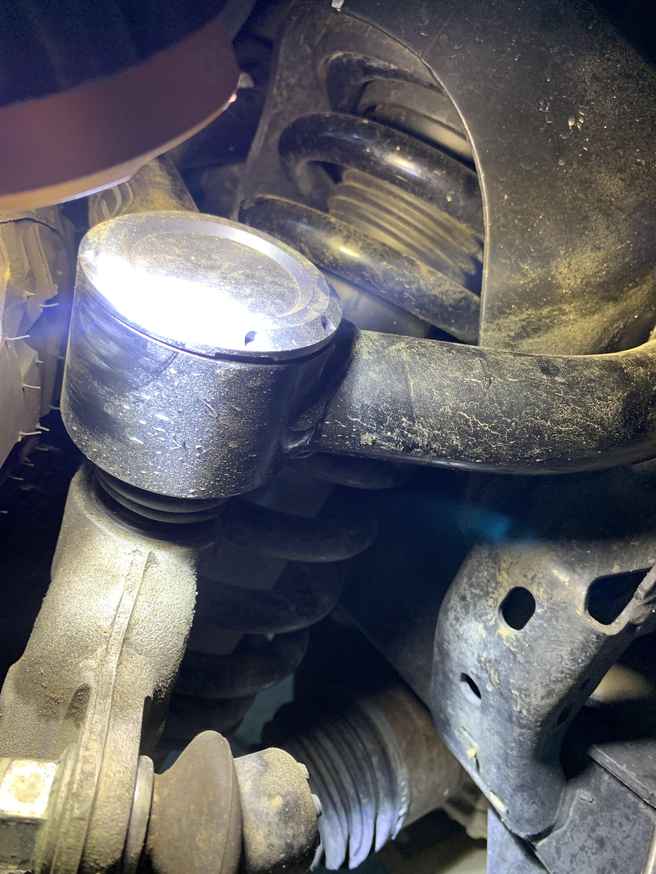

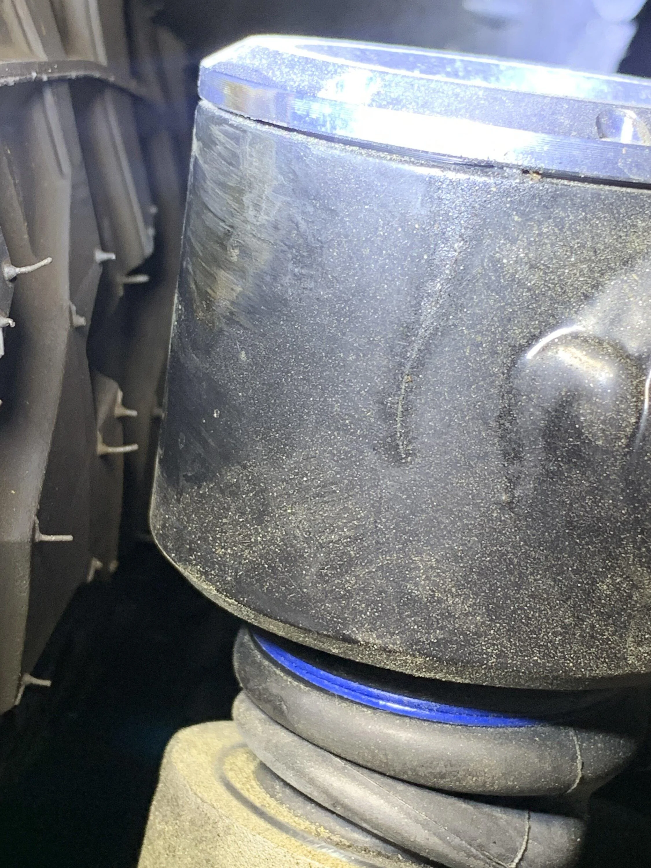

I’m running 35x11.50 tires on stock +44 mm offset wheels with JBA UCAs. My tires rub the front portion of the UCAs at full lock and only at full lock. I have added 3/8” spacers which is the absolute max I am comfortable with using my stock lug bolts.
The spacers helped but my tires still kiss the UCAs at FULL lock but no other time.
I've shared this vid a couple times but it's important to understand what's going on especially with 'thicker' tires (more distance between ID (rim) and OD). It's not so much that it's touching because of lock, but touching because the deflection of the tire under cornering forces. However there is a component of camber gain at play as well and that varies between differing suspension geometry. You can see this when you turn the wheel to full lock and the tire's angle noticeably changes to assist in cornering due to the above mentioned slip angle. Tires with excessive lugs can cause them to rub as well due to being wider than other tire designs. I'm not a fan of spacers due to the additional load it places on bearings as they begin to move the load forces away from the center of the tire. It leads to premature bearing failure but if you want aggressive wide tires, you've got to choose your battle.
