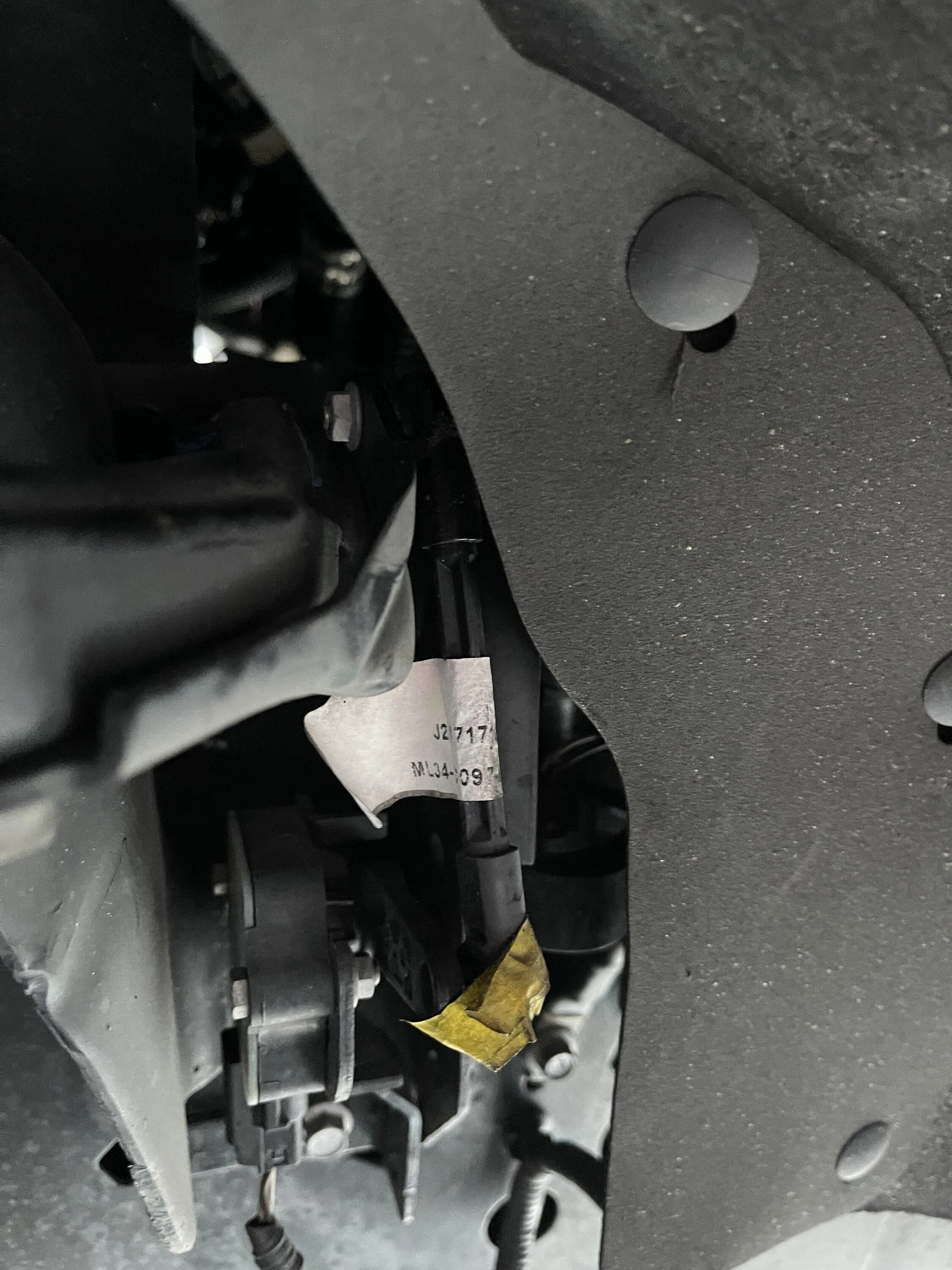

Recently had the 4” BDS SR Coilover kit installed on my 21’ Lariat FX4. Had a set of the BDS Upper control arms to install. Since I have the 502 package I made sure to get the BDS set for the headlight sensor. Shop called and told me the passenger side also has a sensor. I’ve looked everywhere but I can only find a sensor on the driver side. Also called BDS and they were confused.

Did you ever figure this out? I am dealing with the same issue with my 2024. I called BDS and they were aware of the passenger side sensor but the guy didn't know when it would be updated.

It looks like rancho updated their upper control arms to include the sensors on both sides.
