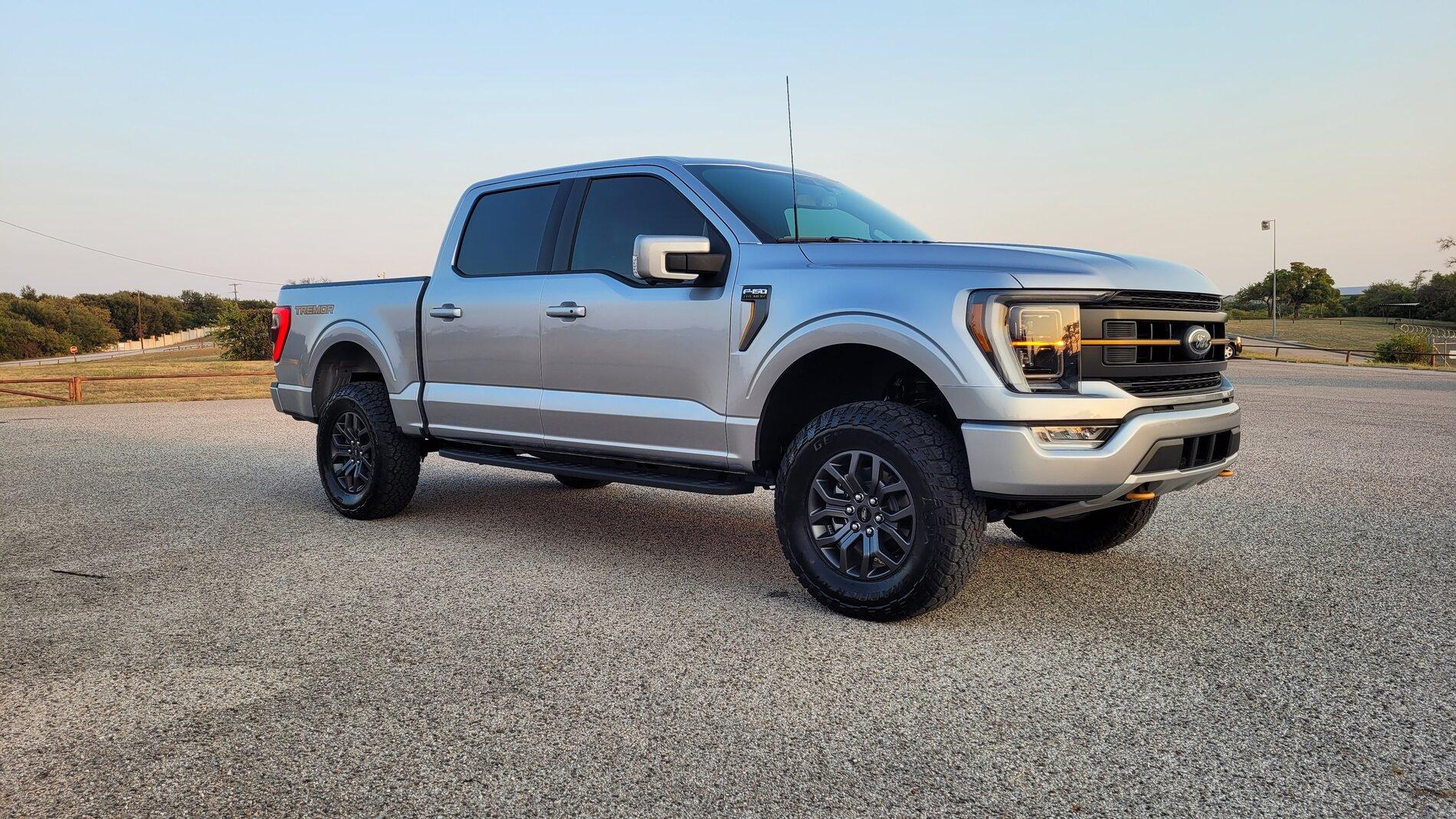

I used Pro Comps 2.5in level kit. I drive too much to not get some use out of the Tremor shocks and UCAs before I probably replace them in a year with some ICON stuff.
^ I was going to order a Lightning, but after seeing your Tremor. I am almost certain I want a Tremor instead. Your Tremor looks awesome leveled. The perfect truck, basically level and done ! Maybe tune it too :)

Now that you've been driving it for a month, I'm curious:
Have you had any issues with your headlights in terms of needing to adjust them downward to compensate for the level? I know you've got the LED projectors and that they have some limited self-adjustment....I'm just curious if all's well after you've had more time behind the wheel.
Looks fantastic, btw.
Just crossed 4200 miles, no issues. The ride height sensors that control the headlight level are connected to the upper control arms, so as their angle increases, the headlights tilt further down. The LED cuttof still stays below other people's windows.
Are the control sensors at a different place on the Tremor compared to the non-Tremor?
I thought the sensor on the Lariat and above were on the drive-side rear springs.
As far as I and the 4WP tech know, it's this thing on the upper control arm. I may be wrong, but the headlights definitely still auto level to the correct angle.
That looks like the same sensor but on the non-Tremors, it is on the rear spring
maybe there are two of them?

The ND MX-5 has a similar auto leveling sensor. Many who lower those cars get one of these to ensure the lights stay at the correct location. Wonder if something like this can help us get our trucks level not blind others or light up the ground.
https://www.flyinmiata.com/default/nd-headlight-leveler.html
I've been really close to small sedans and coupes in the dark, and my lights always shine below their rear window. Even leveled I've had no issues, nobody flashing me, where as my leveled ranger was shining straight into everyone's eyeballs.

Hello, I am curious if you had to go with a 2.5 block in the rear since it comes with a 4 inch block from factory from what I was told when I took my truck to get leveled. Unfortunately, I was not able to level it since the rear is too high. I came across this post and saw you were able to level it. It looks great and would like my tremor to look like this.

After some back and forth with 4wheel parts, I was able to get my Tremor leveled. A standard kit does fit despite what I was told early on in the process, all the suspension angles remain in spec and it drives the same.
Which 4wheel parts location in TX? I'm currently trying to get the Pro Comp 2.5 Inch Leveling Lift Kit - 62206 installed on my F-150 Tremor at 4wheel parts in KY. The local store said if I could track down the store in TX. They would call and confirm to complete my installation.
He went to the Lake Worth location. I called there and confirmed when leveling my tremor with the same pro comp kit. Works great, no issues so far and ride quality is same.
