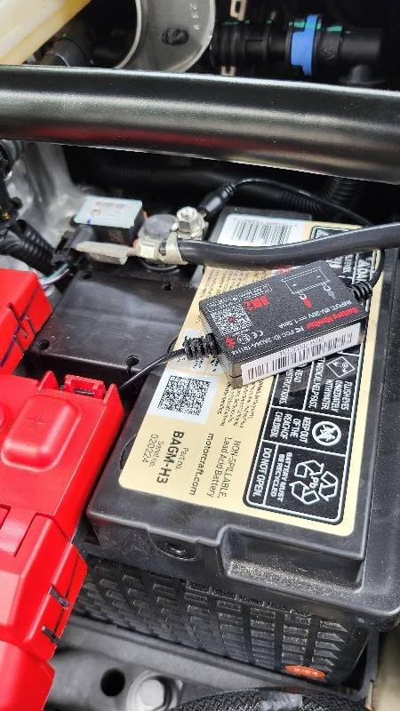

I have installed a small inexpensive Bluetooth voltmeter in my 2022 Powerboost and 2023 Mach-E. (Both vehicles are notorious for surprising the owner with a low voltage issues)
It mounts directly to the +- posts of the AGM
And don't worry, it has an almost imperceivable draw itself.
It allows you to get a voltage reading without disturbing the vehicle. You don't even have to approach it.
This is real time, and I simply opened the app on my smartphone. The Mach-E is parked just outside the RV I'm sitting in.
