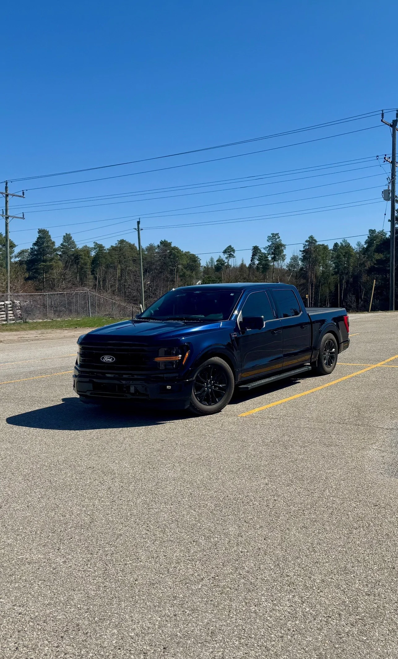

pic of my truck so attention:
Ford F-150 Helper Bags and C-Notch Kit combination parked
