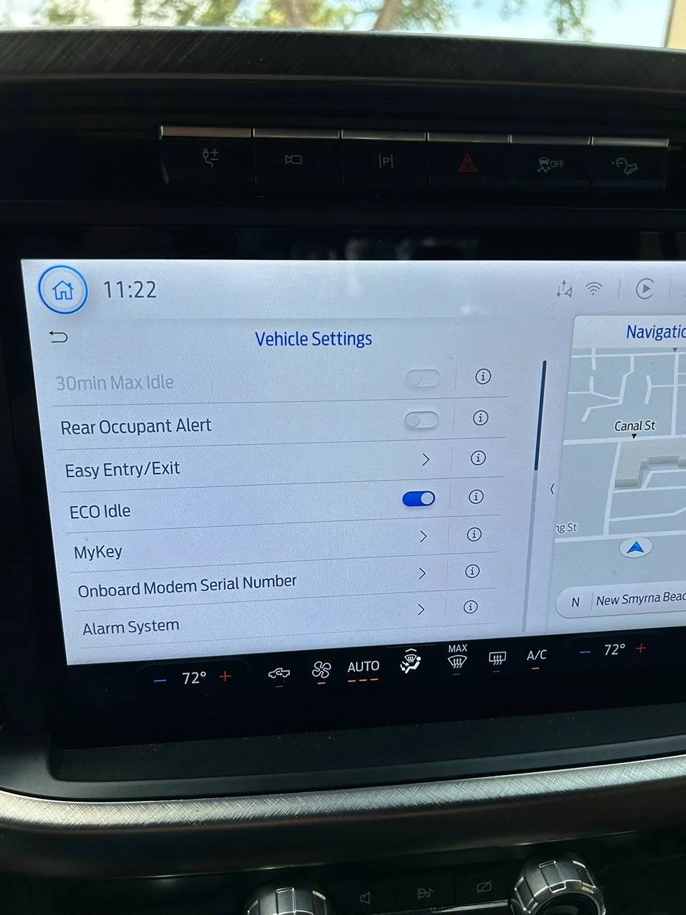

I have a 2022 Powerboost and had the same question. I found this on a Reddit Post and it worked for me. You must turn the toggle on the 30 minute idle off before you make the change though. I didn't and it permanently left the 30 minute idle on . Once the change occurs it grays out the toggle option so you can't change it. I had to do it a second time with the toggle off for it to permanently keep it off. DM me if you have questions. I assume your 2024 would be the same as my 2022 model. Here is the instructions I found on Reddit:
IPC 720-01-01 x*xx xxxx xx -Subtract 8 from the value that is in the second position denoted with *. -In the second position, there will be a letter A to F that represents a certain value. A=10, B=11, C=12, D=13, E=14, F=15.
-IE: if your second value is A, then you would replace it with 2. -IE: if your second value is F, then you would replace it with 7.
NSBFLORIDA
Dec 27, 2024
New Smyrna Beach, Florida
2022 Ford F-150 Powerboost King Ranch
Once you make the change it will look like this. I also made some other changes to add A/C controls at the bottom of my Sync Screen.
