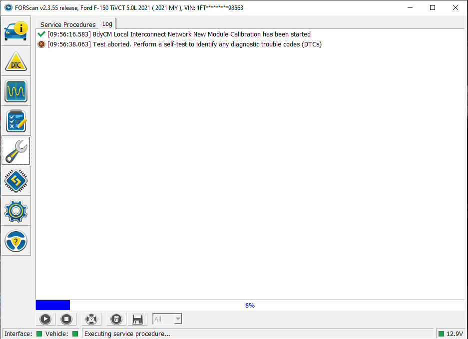

Headlights and foglights were purchased new along with the conversion harness. Forscan changes and pinning/depinning were completed as per installation instructions. The issue I am having is with the final step.
When I try to Run the "BdyCM Local Interconnect Network New Module Calibration", it gets to 8% and prompts me to cycle the key off and on. When it comes back it gives me the following error and aborts.
"Test aborted. Perform a self test to identify any diagnostic trouble codes (DTCs)."

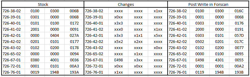

Changes to BCM are as follows:
726-38-02 xxxx xxxx x1xx
726-39-01 x0xx xxxx xxxx
726-40-01 x3x3 xxxx xxxx
726-41-02 xxx0 xxxx x1xx
726-42-01 x3x3 x1x1 x5xx
726-42-02 x5x2 x2xx xxxx
726-43-02 xxxx xxxx x0xx
726-65-02 xxxx x1xx xxxx
726-67-01 E498 x3xx xxxx
726-72-01 x0xx x0xx xxxx
726-76-01 x1xx xxxx xxxx
If I load my stock BdyCM file and reset the DTCs they dont come back. Then I write the forscan changes and run the Module Calibration its gives the abort and DTCs come back. Even if I try to clear the DTCs with the forscan changes in place they do not clear.

OK.. I cant tell what you have at the values you have x'd out.
726-72-01: 0001-0000-01xx This is for the DTCs. You may already have these values. I dont know what you have other than what you have pasted.

OK I will try this one. In the mean time, this is my stock vs. changes I made vs. what the written forscan shows. Seems as though once some of the changes are made and written forscan automatically changes some of the last two number. Kind of odd but may be normal.

The last 2 digits are just a checksum. Forscan auto calculates them. Totally normal.
