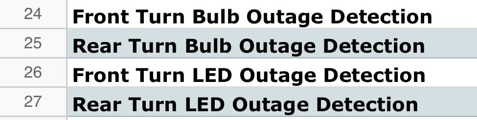

The only thing is see in ForScan is:
Ford F-150 XLT Halogen to LED Issue…Help! 1499D546-373D-441D-8E84-93125359D8CD
And I thought I remembered reading those settings ONLY apply to hyper flash ?
