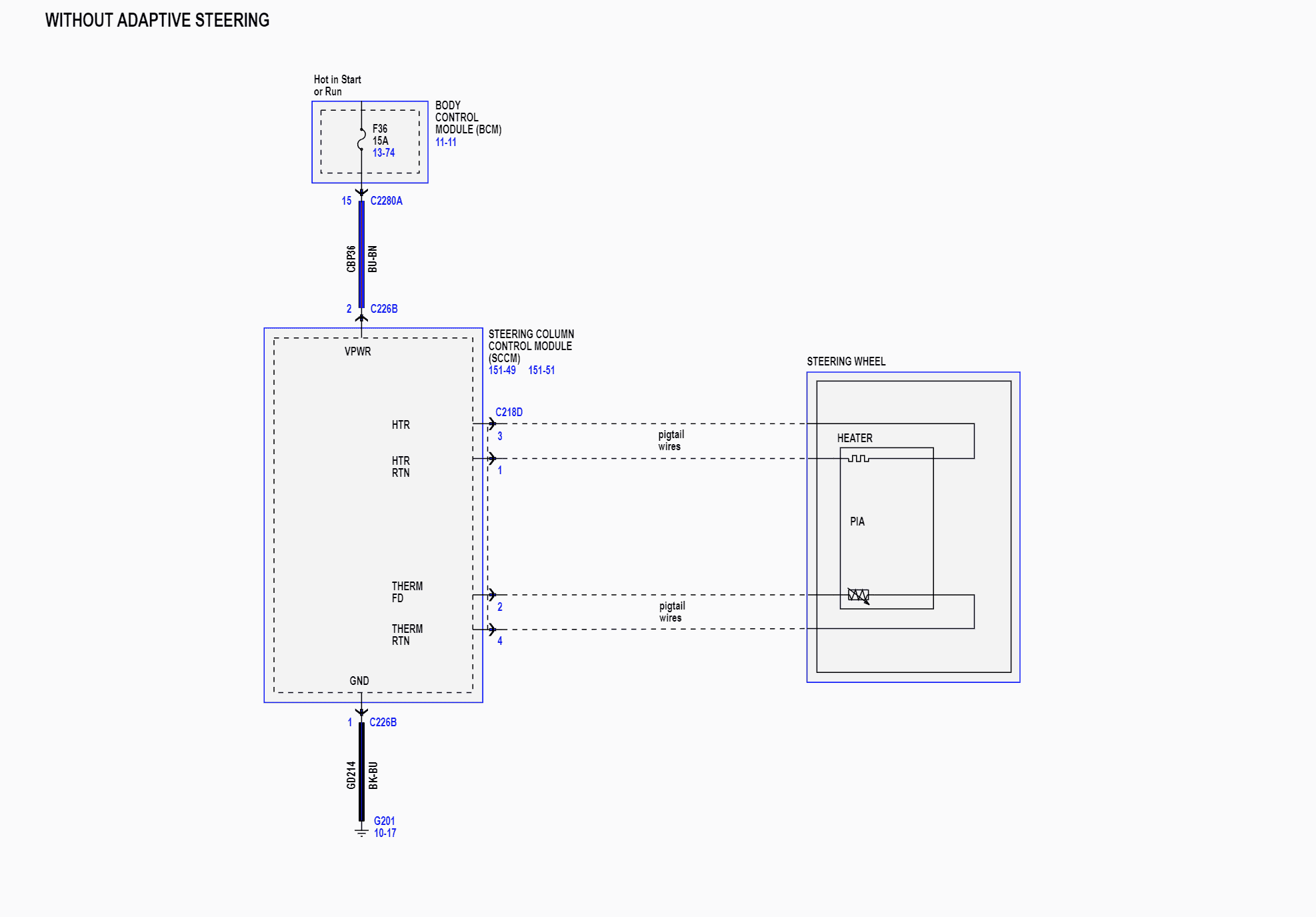

I have a 2023 power-boost Lariat 501a with a build date of 8-23. I want to install the heated steering wheel with the soft button on the screen. I am about ready to order the parts. I have the wiring harness visible but no wires from the steering wheel.
I found the ford bulletin 22G06 a few pages back that give the numbers for needed parts.
My truck calls for the sccm assembly # PL3Z-3F791-AB. Steering wheel PL3Z-3600-PA and steering wheel bolt W721079-S437 .
I see the recommended sccm on this site is ML3Z-3F791-BB. That part is about $100 less than the recommended one from ford's bulletin with the only difference being the power adjustable column which I don't have. I think it's worth 5 minutes of my time to swap out the wiper arms to save $100. I can't find a photo of the recommended steering wheel but I am going to have to trust that it will work. Unless anyone can chime in on a better choice. I do not have adaptive speed control or adaptive steering.
