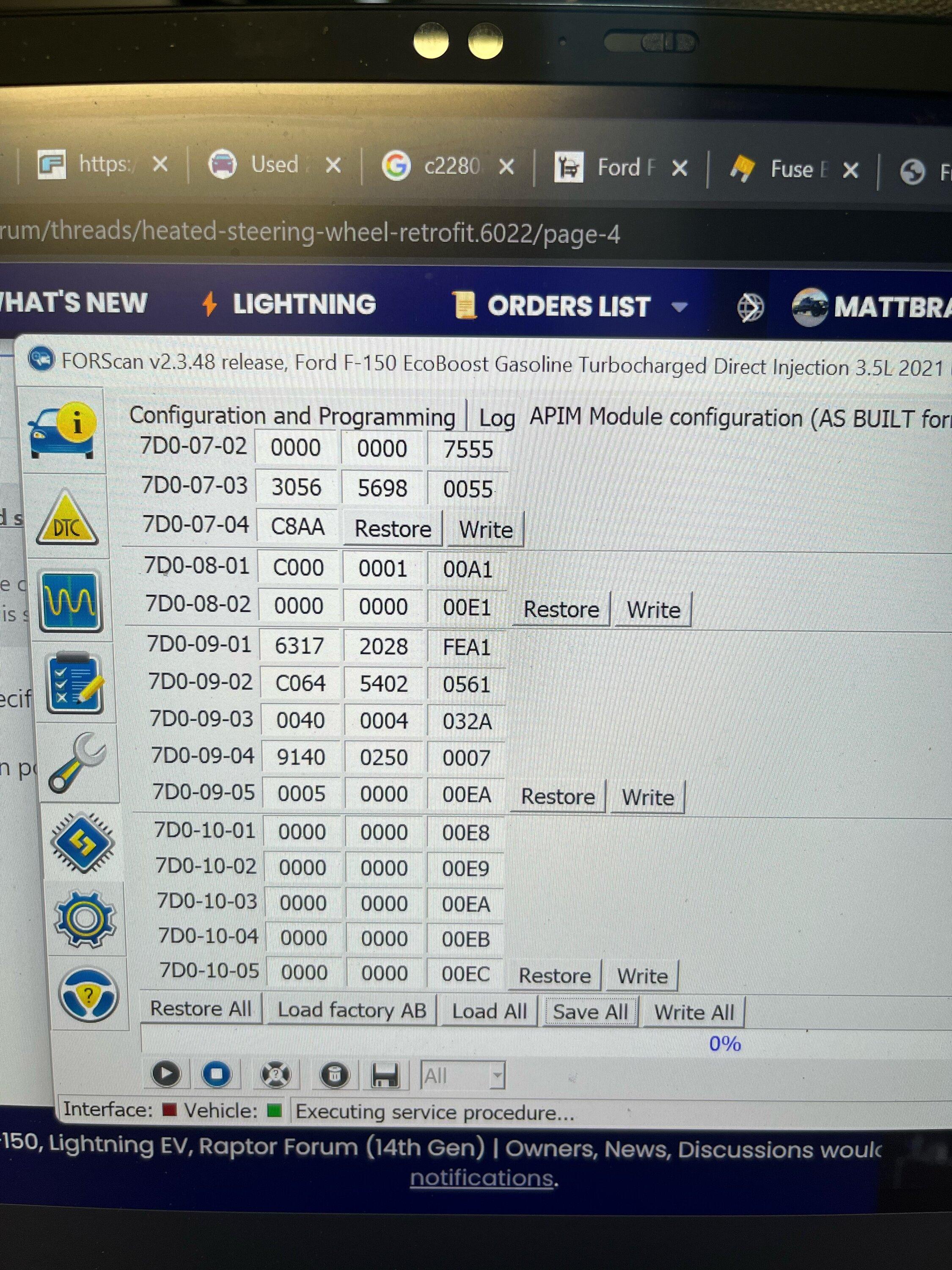

Ok.. Yeah then you can try this with your HVAC module you have but
733-01-02
XXX8 XXXX XXXX
Add 8 to whatever is there. Probably a 1 so make it a 9
See what happens

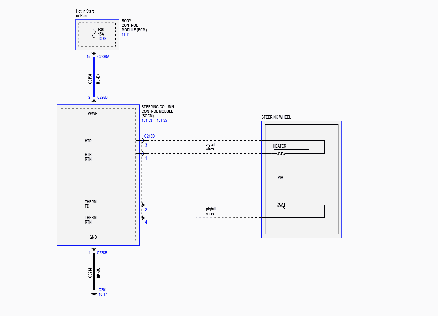

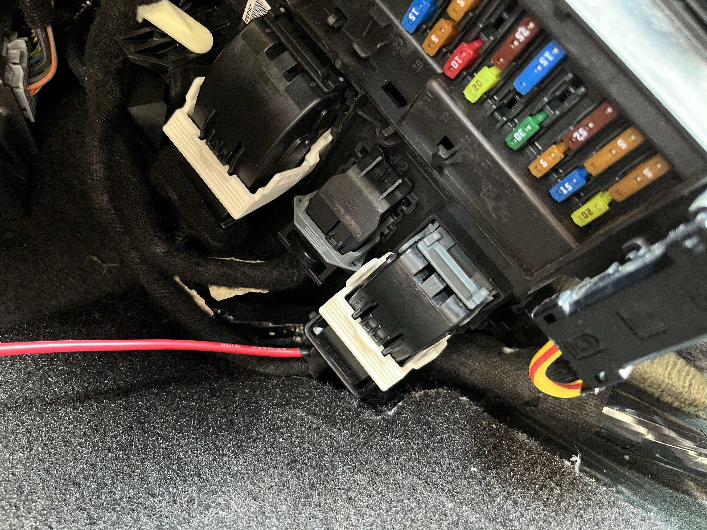

that gave me the option to switch in the button, thank you but now I still have the problem of constant heat, I’m using pin 15 on the lowest connector on the BCM is this the right one?
I think you may have swapped positions at the sccm. Double check the PIN numbers and what they are at the sccm

You may have to wait some time to actually tell if you have heat or not. Its not exactly like it gets frying egg hot. I dont know what temp it is where you are at also it may not be super noticable until its cooler. Make sure you have Pin 2 as Power. It may have been getting super Hot before because it wasnt limited by the temp limits in the SCCM

You were right i had the wires swapped, i appreciate all the help. The new wheel heats up nicely.
