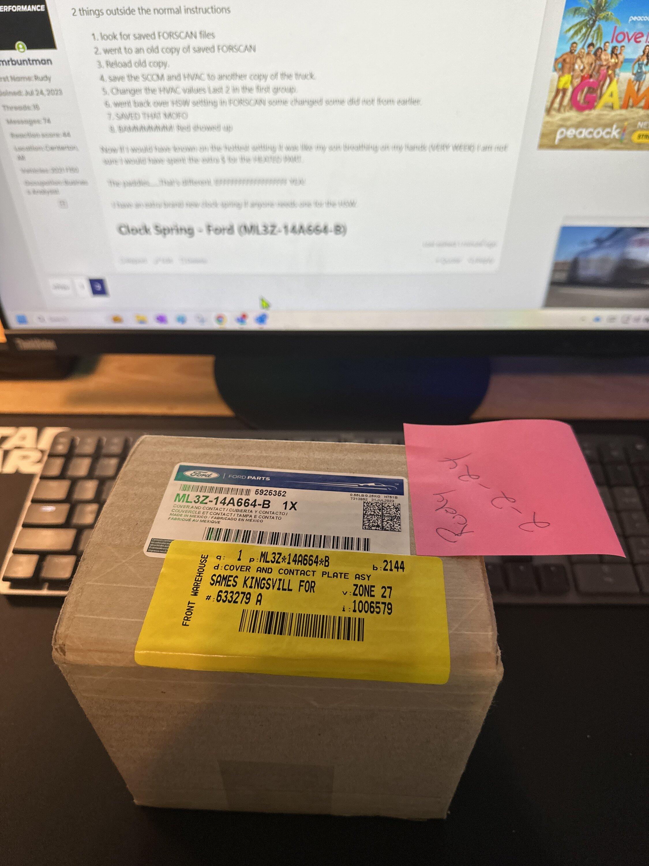

I have an extra brand new clock spring if anyone needs one for the HSW.
Clock Spring - Ford (ML3Z-14A664-B)
