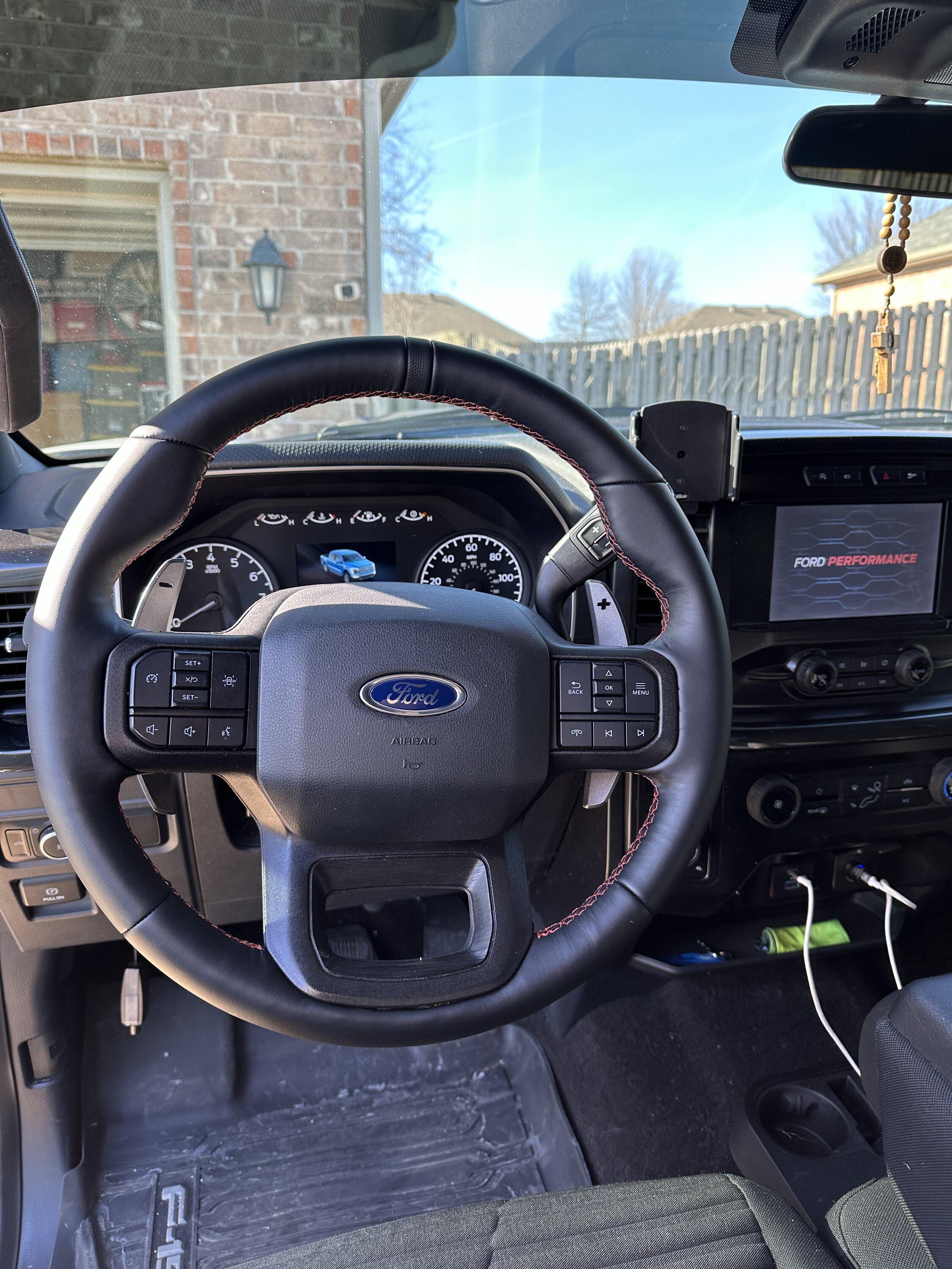

21 F150 STX
Hello NEED HELP!

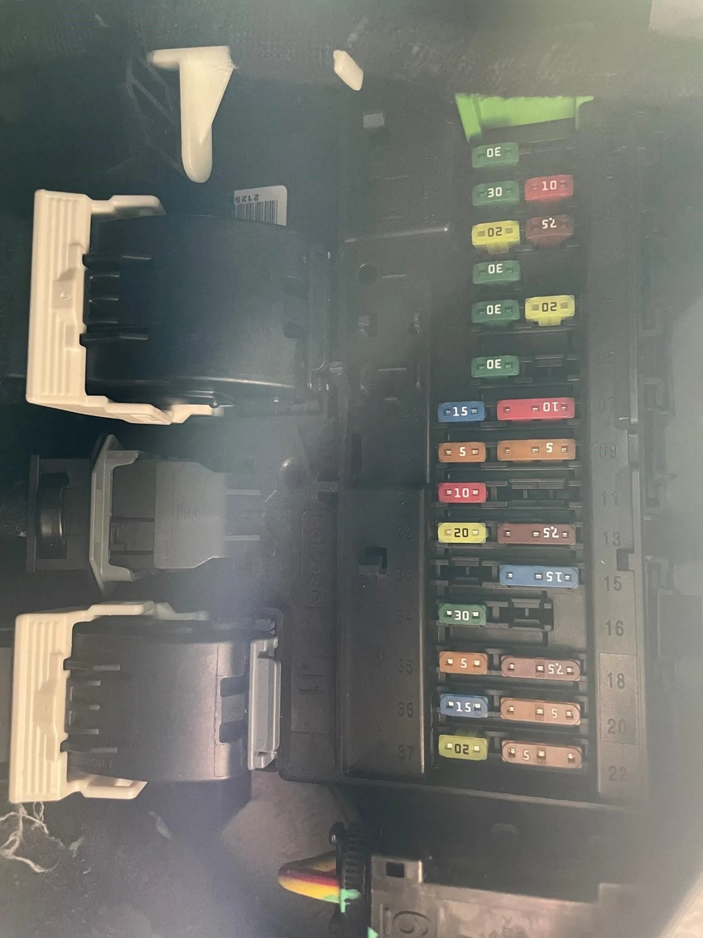

I have been at this all day; I have done every step 3 times. I went over each connection, each fuse. I think I did “restore” correctly. Still, I have the GREY out heated steering wheel for the HSW.
Have the raptor 2024 steering wheel so it’s heated.

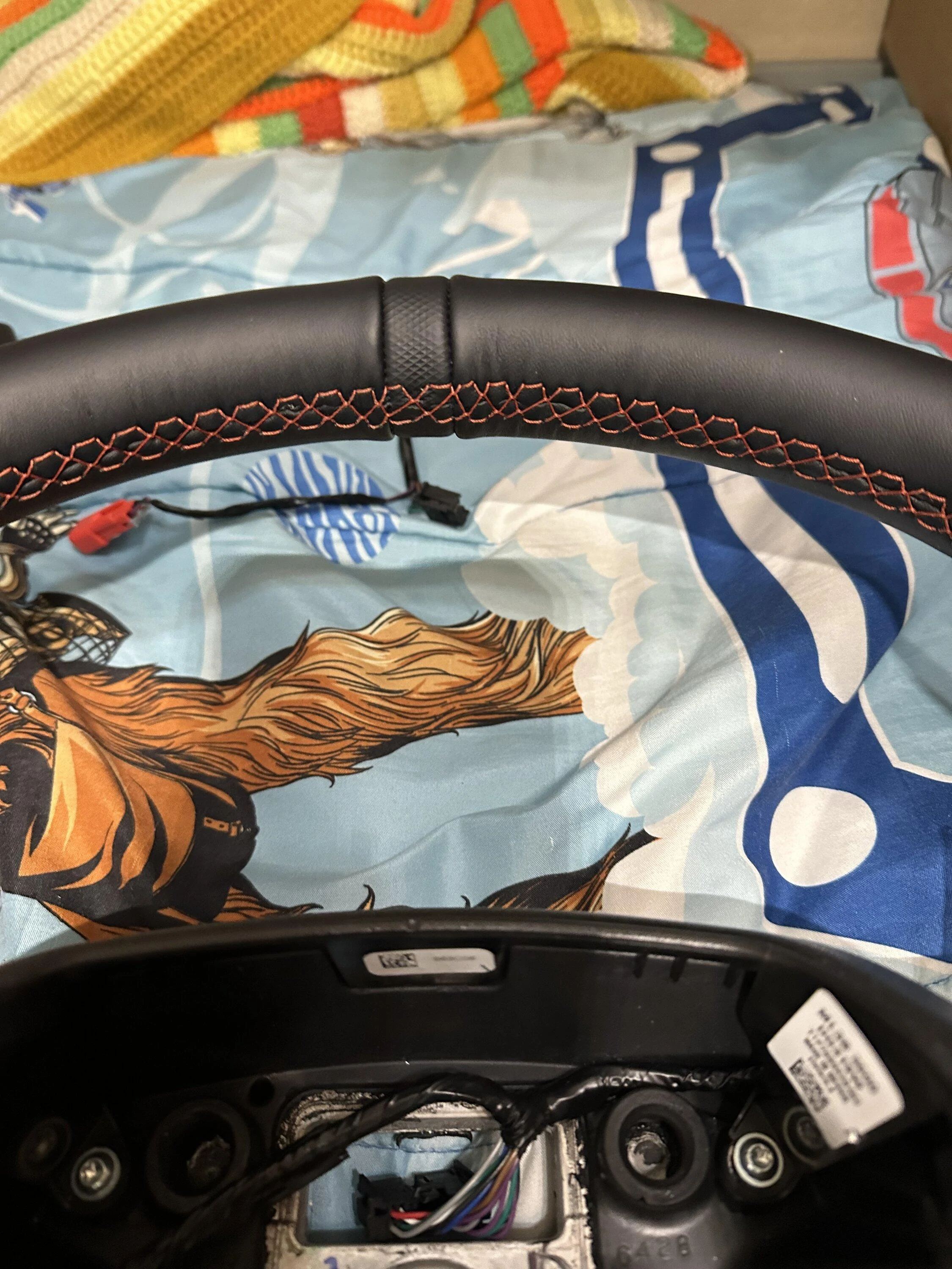

Could be out a new one with the black loop on top.
Ford F-150 Heated steering wheel KILLING ME! IMG_3180
Ford F-150 Heated steering wheel KILLING ME! IMG_3178
Ford F-150 Heated steering wheel KILLING ME! IMG_3177
Ford F-150 Heated steering wheel KILLING ME! IMG_3179
Do all of your blinker / wipers work properly? All indications point to not enabling the SCCM's HSW control. Not sure what you're referring to in regards to "backed up". It's not natively enabled and you must do it as instructed in the forscan changes. While wise to backup your values before each mod and even each OTA / FDRS update for the module being updated, you must still have the proper 'new' settings for the mod being installed.
Some modules when purchased new need to be 'programmed' with the proper software in the first place which is why it's important to verify other functions are working properly before worrying about 'new' functions.
