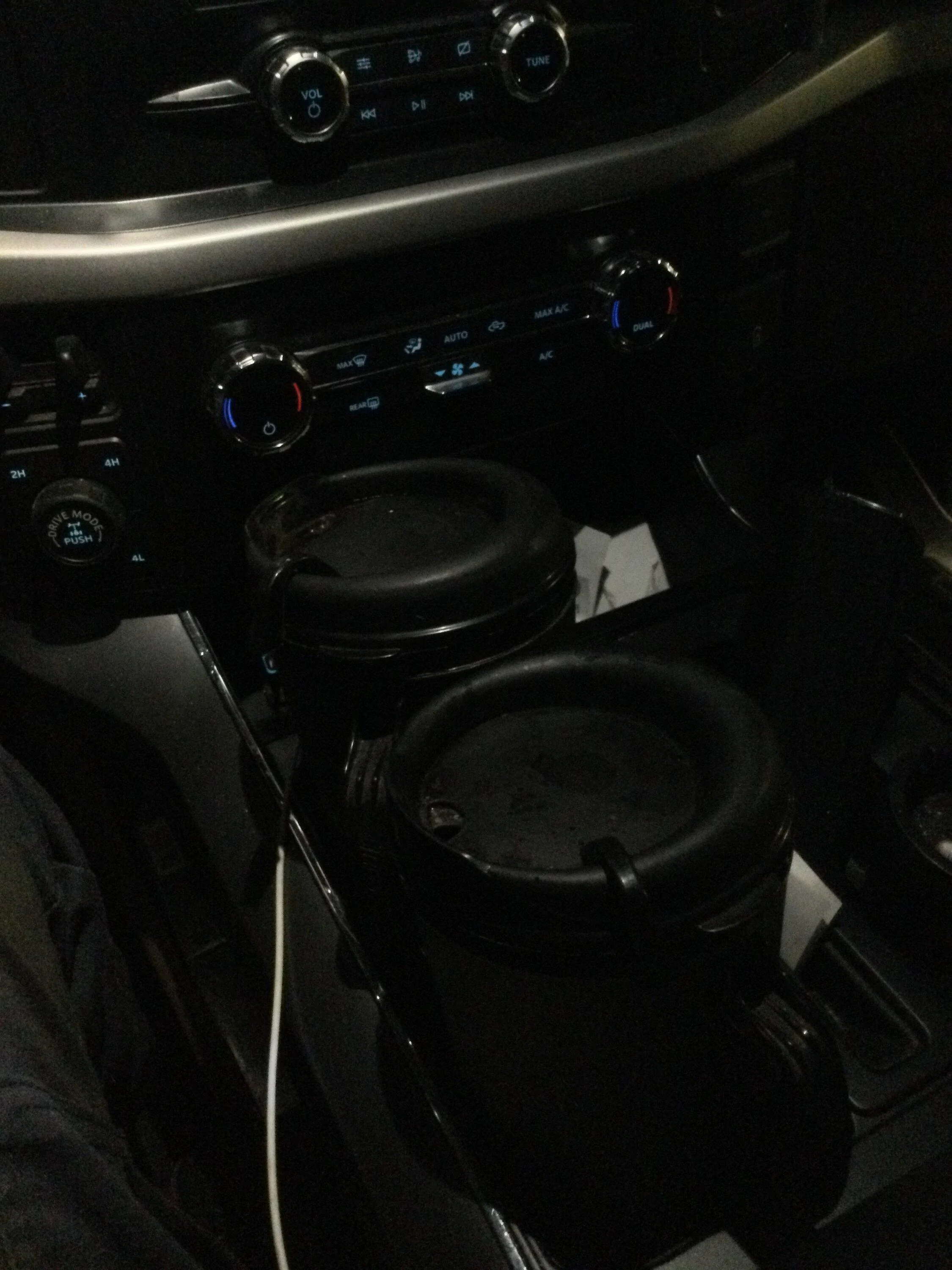

Hey guys, I tried to be thorough here but if anyone has any questions or if I forgot to mention something let me know I’d be happy to explain further. I saw this mentioned a bunch of places but didn’t see it done anywhere so I thought I’d post.
$90 Brand New on eBay
Ford Escape 2020-2022 Shifter - Part # PZ1P-7P55-AC
$50 for all 3 parts
Main Console Tray - ML3Z1513530AA
Console Rubber Mat - ML3Z15045G34JA
Console Plastic Insert - ML3Z15045G34EA
The shifter dial finish is almost an exact match to the dial on the 15” screen and is illuminated. The blue light matches the rest of the interior lights. The dial functions exactly as it should and is very smooth. If the car is in drive and you shut the power l, or you open the door, it will immediately shift into park for you without the dial physically rotating. Additionally, the L button in the center functions exactly like the N button for the 30 min neutral mode.
After pulling out the screen, the trailer brake has a few small tabs holding it that just snap right out. You can either throw it behind somewhere, since there’s plenty of space, or if you plan to use it, you can cut out a space for it somewhere else or possibly mount it in the compartment with the USB ports. I don’t ever plan on towing anything so I tucked it behind out of the way
The round part of the dial is exactly 3 inches in diameter. I used a 3 inch hole saw to drill out the trim and then a dremel to make the notch for the bottom part. I cut it out on cardboard first to get the exact size then I traced it in its final place before cutting.
The plastic mounting holes on top and bottom of the shifter need to be cut off to allow it to fit snugly and stick out like it’s supposed to. I used a hacksaw to get a smooth clean cut. I also needed to cut some plastic behind the hole to allow it to fit. After fitting the shifter into the trim, I tried pushing the screen back in and was able to see which plastic pieces were interfering. I used a utility knife and dremel for most of the plastic cutting. At the end the shifter was held snug and almost squeezed exactly into place so that it doesn’t need any fasteners. The screen is still snapped in and very sturdy. I was afraid it might be shaking after cutting the plastic but it’s totally fine.
Removing the old console shifter is really simple. The side trim pieces, left and right of the cup holders, pull right out by hand. Then the top of the cup holders plastic trim piece pops up. You can take it off without removing the screen but there are two tabs that are tough to squeeze out. If the screen is off the top plastic trim of the cup holders pulls right up. It’s all connected with plastic tabs so by hand or with a trim tools it’s really easy to take out. After you remove the plastic there are 4 10mm bolts holding the shifter housing. One is underneath the small plastic door in the front, and the other 3 are easily visible. Once you remove them you can slide out the shifter and disconnect the wires. In its place you can put the Console Tray for an OEM finish.
You may want to keep the shifter inside the tray which is as easy as making a small hole for the wire and securing it down and then getting some sort of trim to go over it. I think it’s a total waste of space which is why I put it next to the screen. It does fit inside the tray deep enough to open the workspace for anyone interested.
At this point, all I need is to get the wire in the right place. I’ve followed the wire back and it looks like it comes from somewhere underneath the center console. I’m not sure where it goes after that but if anyone is able to find a wiring diagram or if anyone knows a way I can get it to reach let me know. I would even make my own harness to just extend it a little so that I don’t have to touch the factory wiring or sheathing. Ideally, I’d really like to avoid cutting and splicing any factory wiring so if anyone has any suggestions I’m all ears.
