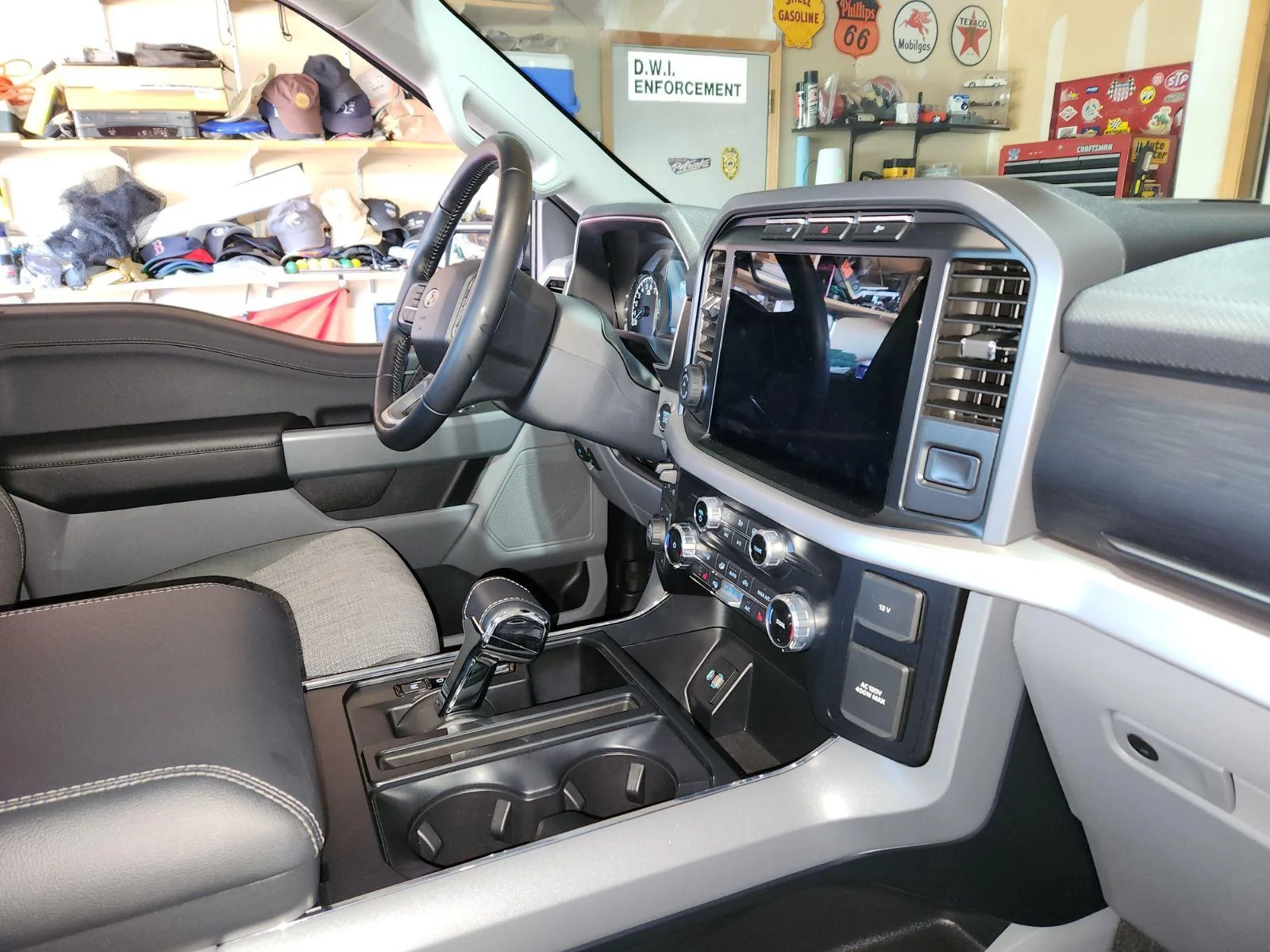

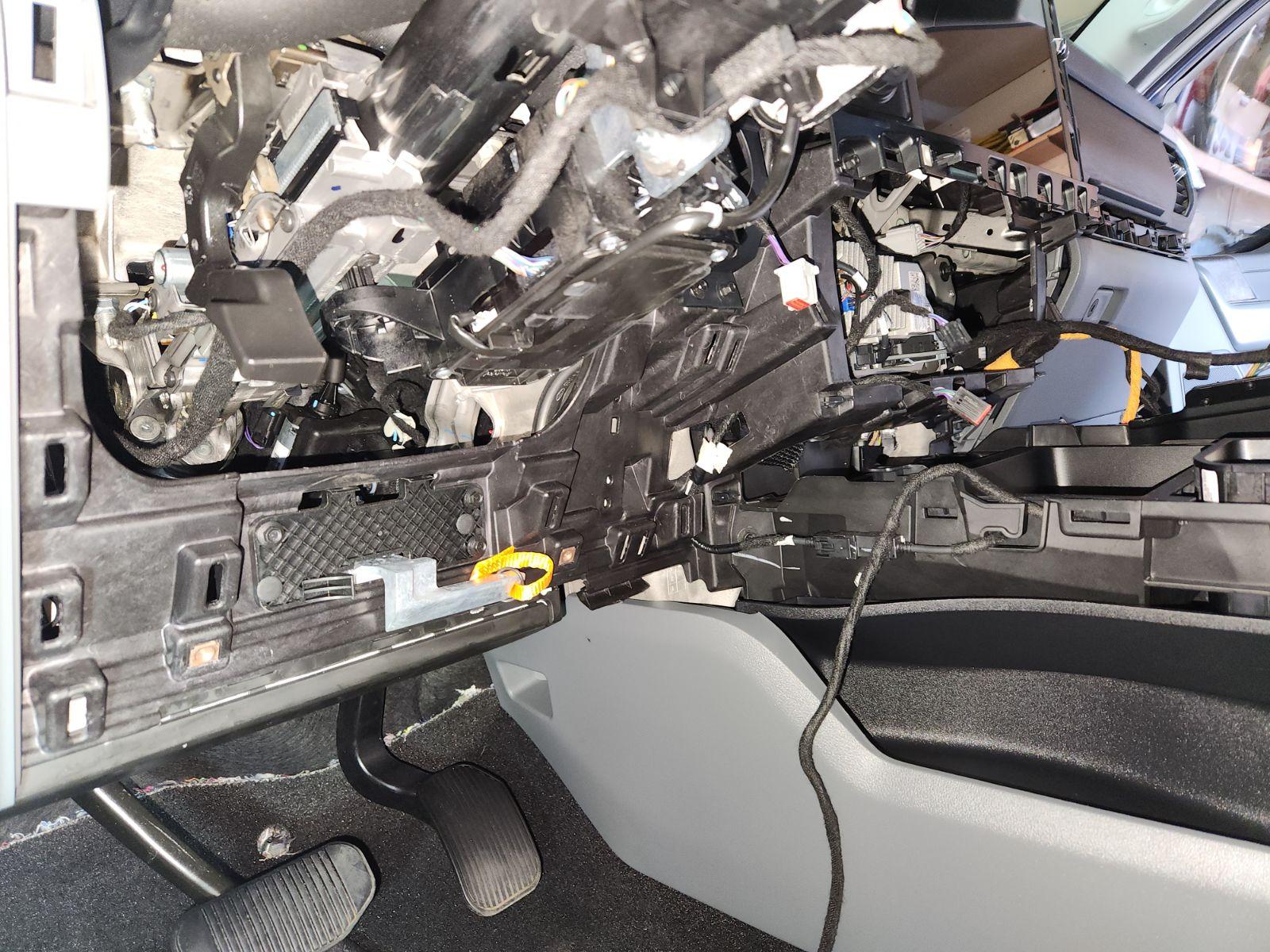

I completed the changeover last weekend using a kit from Infotainment. It contained all the parts required, they also provided a youtube link for the installation video. Install went well, took approximately two hours. I'm very happy with the results!
Ford F-150 '22 F150 Column to Console Shift IMG_20230722_084836
Ford F-150 '22 F150 Column to Console Shift IMG_20230722_084841
Ford F-150 '22 F150 Column to Console Shift IMG_20230722_084904
Ford F-150 '22 F150 Column to Console Shift IMG_20230722_084908

Power for the shifter?

Hi did you update any codes using forscan or FDRS because the said you need to update the TRON using FDRS

No required code updates. I plugged it in and it worked flawlessly. Shifter plugs into the same connector that column shifter did within the column.
