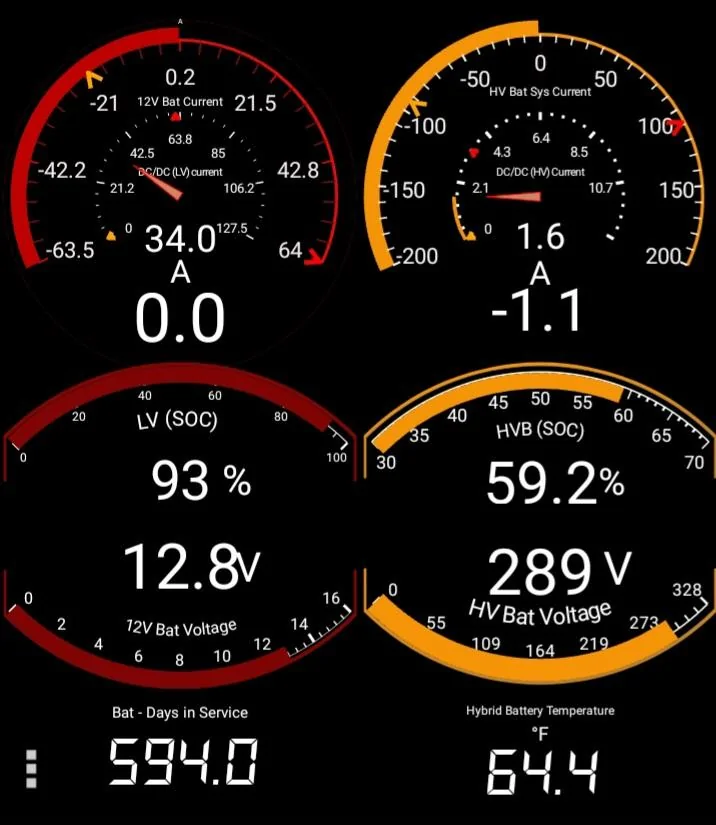

Fan speed 5 simply triggers a 14V output from the digital alternator (DC/DC converter) on the Powerboost. If the battery management strategy already was calling for 14V, then fan speed 5 isn't necessarily getting you a boost. Although you also would need to compare the current (amps) being supplied since it's possible that there is 14V being supplied but not enough excess current above what the truck is consuming.
Below is a screenshot where the SOC is 93%. The charging strategy is basically ZILCH. The DC/DC converter dropped to 12.X Volts and ZERO amps for charging the AGM. (34 AMPs are being supplied, but that's what the truck is consuming)
At this moment if the fan speed was increased to 5, the voltage would be increased to 14V. I wouldn't know the amount of AMPs unless I did the procedure. But it would be a trickle charge quantity, which is better than 0.
Ford F-150 Having issues with electricals 1000018548

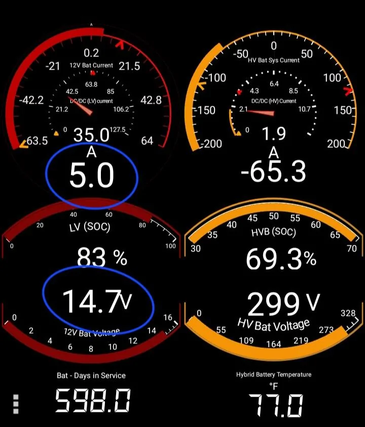

Below is the SOC at 83%, and the DC/DC converter is supplying both 14.7V and 5amps of charging current
Ford F-150 Having issues with electricals 20231227_114051
