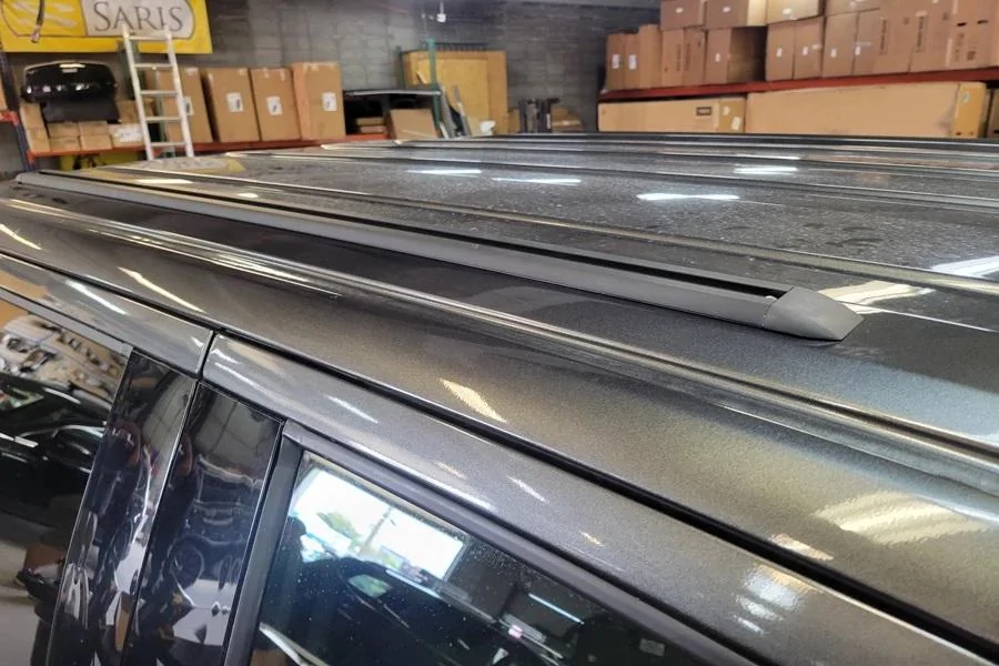

Here are a few pics from the Rack Attack website showing permanent mount tracks on the roofs of our generation of F150. They all seem to be mounted on the ridge with the green arrow as outboard as possible.
Ford F-150 Has anyone drilled into their roof yet? bde37dba-9cdf-4e7b-992d-b1e14d0f74b7
Ford F-150 Has anyone drilled into their roof yet? b8041042-efb7-4734-812f-24163b6c344
Ford F-150 Has anyone drilled into their roof yet? 20220930_122734

Hello again all, this is still a work in progress for me but here are a few updates:
  • I've been communicating a lot with Rack Attack and am settling on the idea of using a Thule/Yakima 54in track with plus nuts for a permanent mount cab roof system.
  • As of now the parts list is:
    • Yakima Track Tower
      • Seems to be a newer product, not much info out there. I like that it is lower profile and stronger than the traditional Yakima landing pad + skyline tower setup
        • I do not yet know but I am concerned that the track tower option is so low profile there will not be enough clearance between the top curvature of the roof and the bars I mount. I use the Rhino Rack Side Loader to solo load my huge canoe on the cab. I rate the use of this particular product to be essential for my setup so if I there is not enough clearance to brace the side loader without damaging the roof then I will revert to the more traditional landing pad + tower setup
          • A big advantage of the landing pad + tower setup is the ability to quick release the crossbars. As stated earlier in the thread I found the wind noise to be quite annoying and really like the idea of a quick disconnect option.
      • Yakima Track with Plus Nuts
        • Rack Attack tells me that the Thule tracks are more low profile than Yakima. I cannot find the exact dimensions of the Thule tracks anywhere. Nor can I find if there is any difference in strength with the lower profile option. To be determined.
      • Yakima HD Bar with appropriate adapter
I am ~still~ trying to talk myself into/out of doing this install on my own. I consider myself a competent DIYer and there is a sense of pride/satisfaction out of doing most the work on my truck myself. However, Rack Attack said they could do it for $275. Not bad considering I would need to buy a few extras to be able to complete the project on my own.
  • I would get a piece of sheet metal to do a few practice runs on. I don't want my first time using a plus nut to be on the roof of my truck. On that note, does anyone know the thickness of our roofs?
