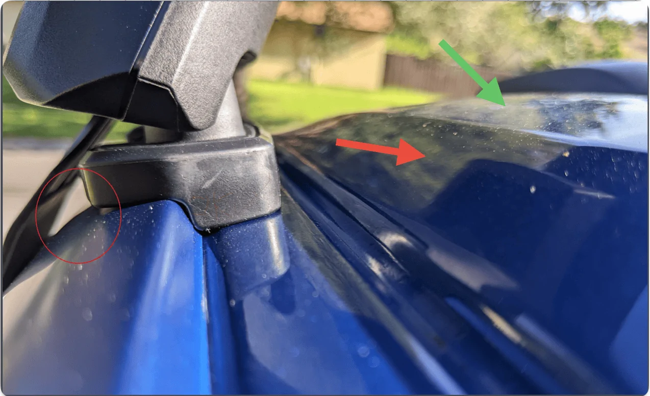

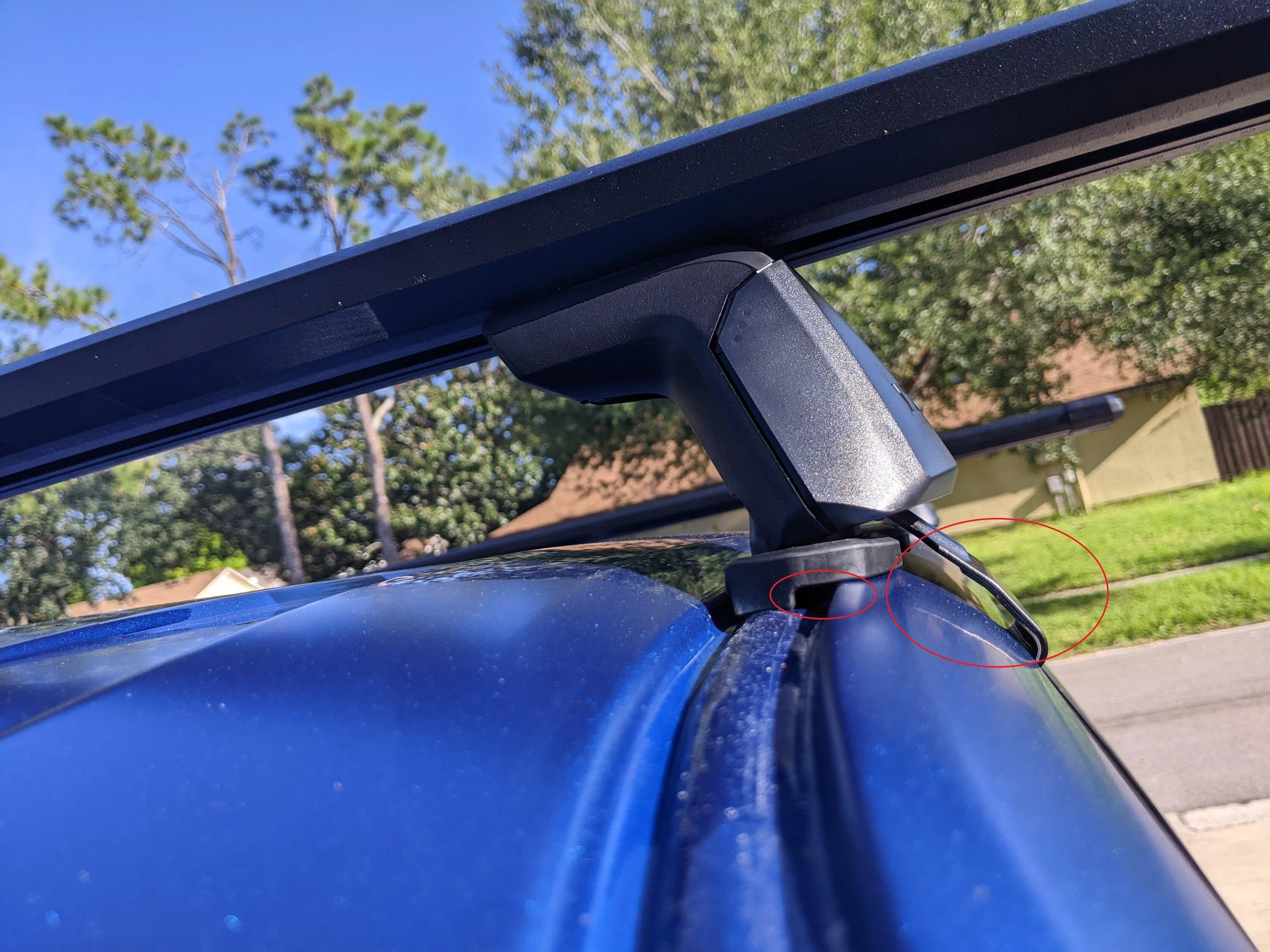

After checking my measurements/instructions/videos/forums several times these are the pics I send to ETrailer asking for verification. This is NOT what the proper setup should look like. The protective coating on one of the baseclips came apart during the install. Lame. The feet of the rear baseclips seem to fit in the gutter better but the actual clamp portion is still off. Photo bomb incoming:
Ford F-150 Has anyone drilled into their roof yet? Drive Door landing pad
Ford F-150 Has anyone drilled into their roof yet? Driver Door damag
Ford F-150 Has anyone drilled into their roof yet? Driver Door landing pad 2
Ford F-150 Has anyone drilled into their roof yet? Passenger Door landing pad
Ford F-150 Has anyone drilled into their roof yet? Passenger Rear Door landing pad

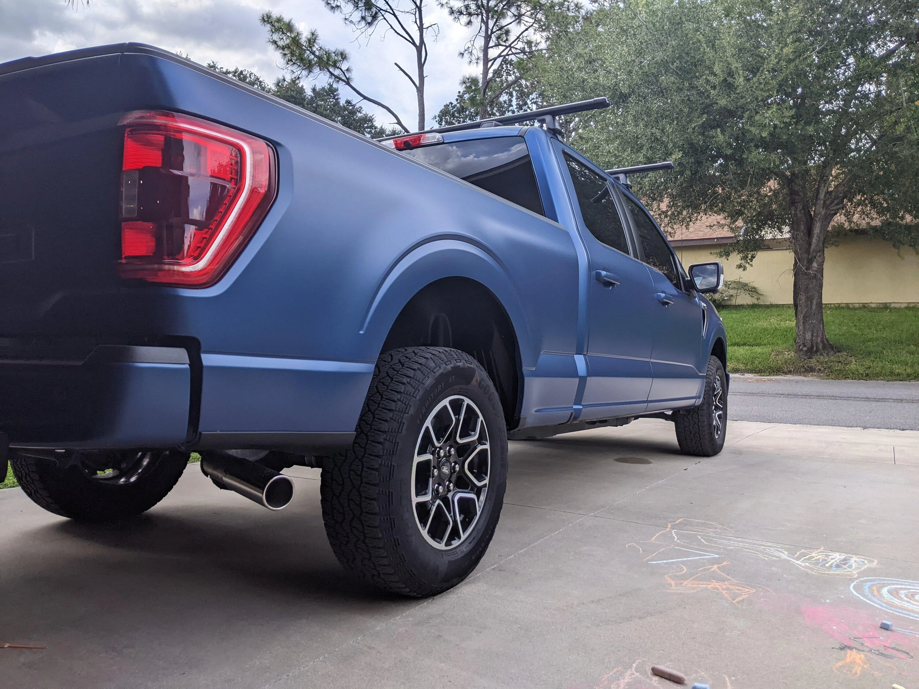

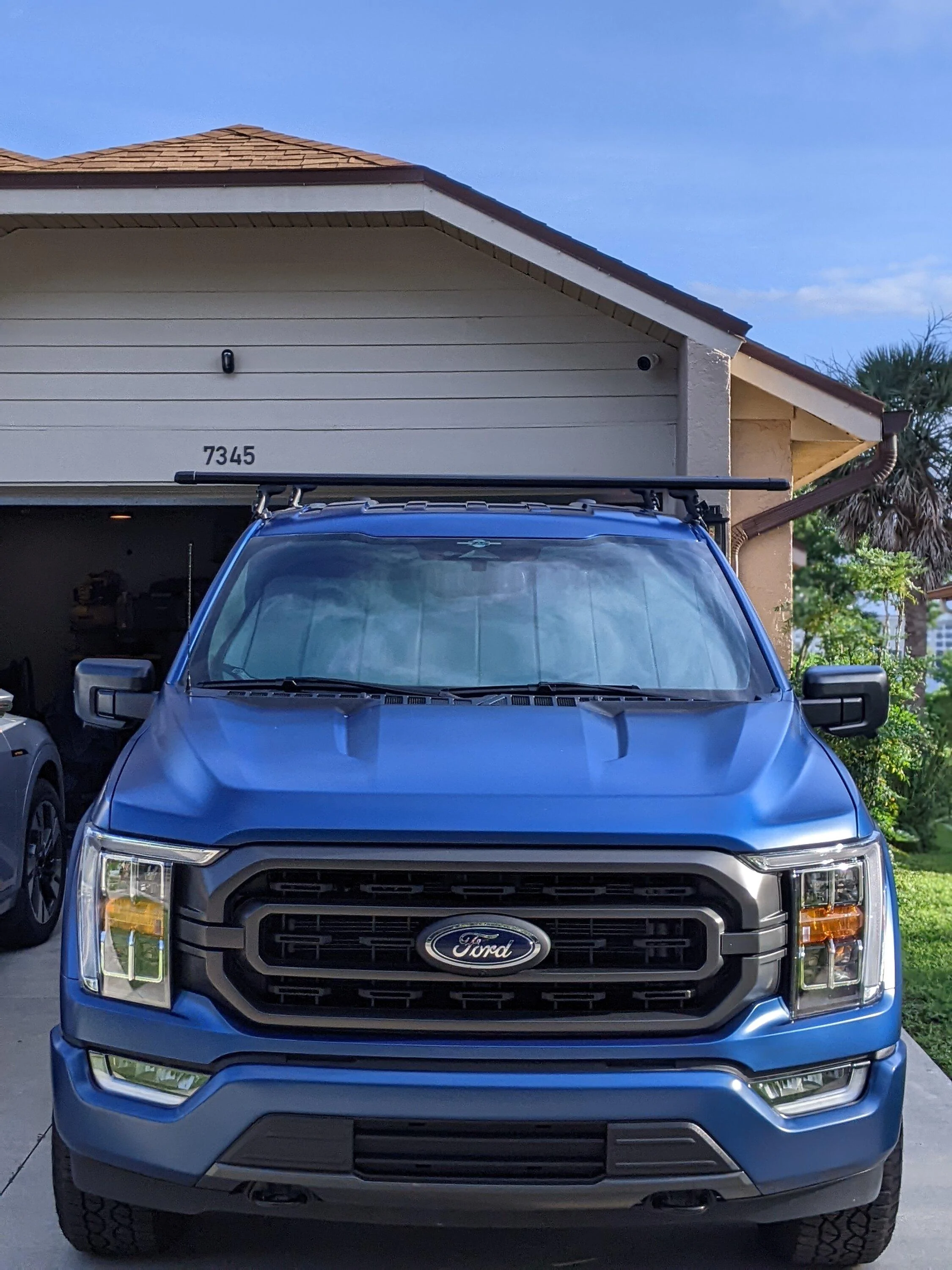

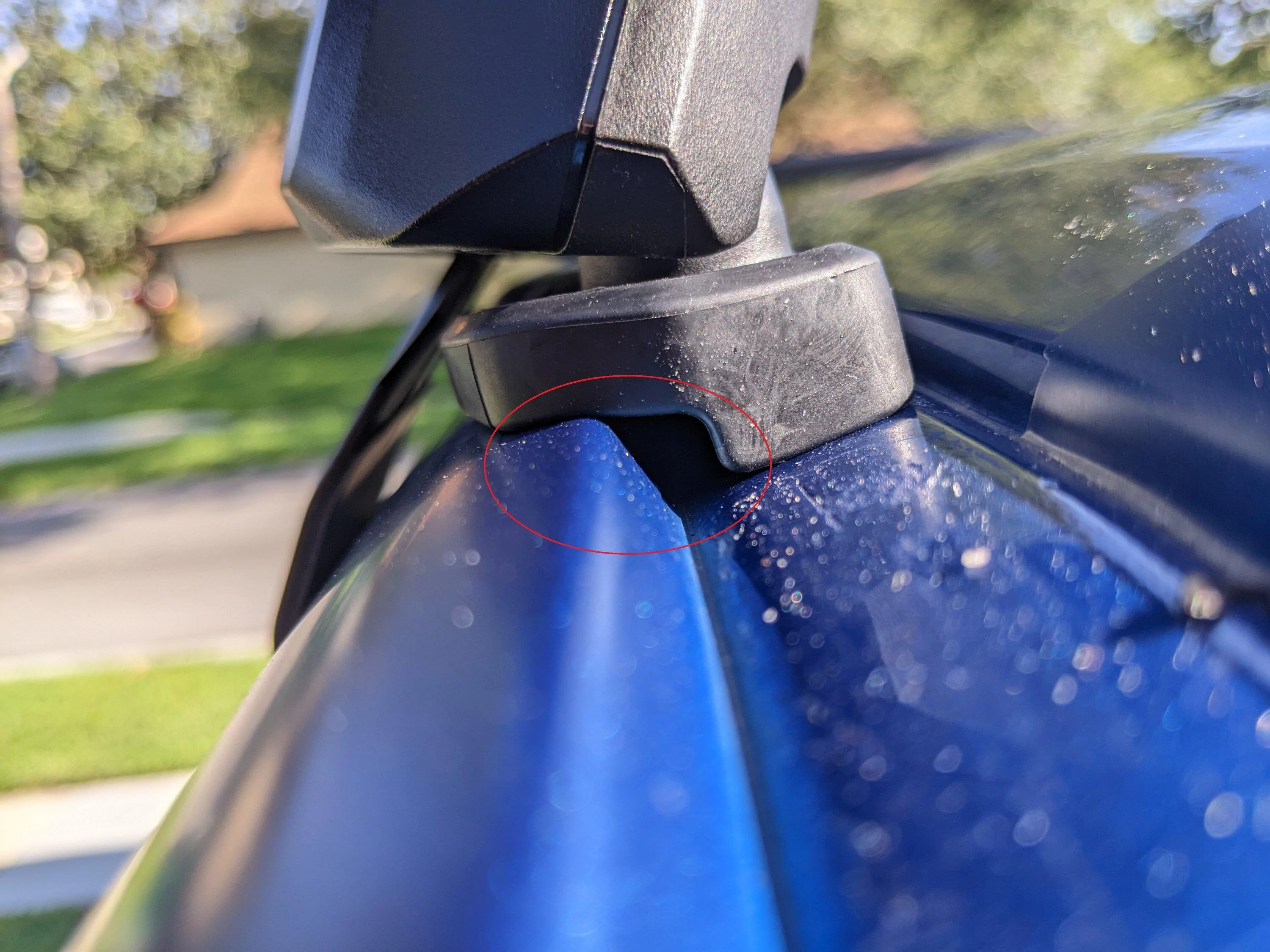

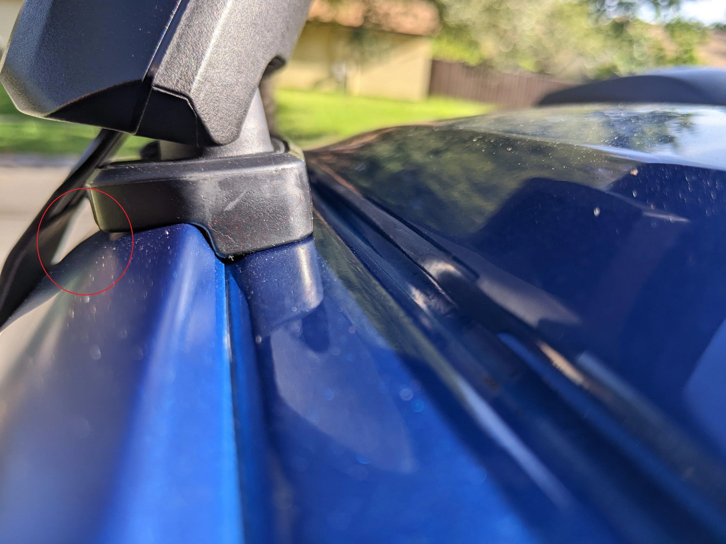

Here are some pics of the (faulty) setup:
Ford F-150 Has anyone drilled into their roof yet? PXL_20230905_211630432.MP
Ford F-150 Has anyone drilled into their roof yet? PXL_20230904_161407978
Ford F-150 Has anyone drilled into their roof yet? PXL_20230904_161419194.MP
Ford F-150 Has anyone drilled into their roof yet? PXL_20230905_210815748
Ford F-150 Has anyone drilled into their roof yet? PXL_20230902_221057554.PORTRAIT
Yeah, those base clips look terrible. I think the damage to the PPF was due to the clip pulling too far up and too little cross-car, and the rubber pads they glue to the metal bracket slipping off. The base pad would be a decent fit if the foot had enough yaw to adjust to the taper of the roof, and if the feet were budged out by a mm or so on each side. I think the bracket and the pad fit, as well as the crossbar shape (lack of a wind strip) likely caused the majority of the noise you experienced. That crossbar length you have pictured I'm guessing is their 70" given the protrusion beyond the feet. If you need that length, you'd have to upsize to the 69" (175cm) ProBar from Thule which may have more noise. Based on the accessories shown attached, you need just about every inch of that.
I actually designed the Thule kit for these trucks, 145177 and 145271 (both fit, the 145271 is slightly different as there was a relief cut in the pads of 145271 to accommodate the moulding over the ditch on the Super Duty). 145271 was actually handed off to my direct report to finish as I was leaving (February of 2021). I remember it distinctly as I had just picked up my new 2021 F-150 (I have a 2022 now, see thread Major Service Mishap if you want to know how I got into that). The Thule kits are all custom fit to the vehicle. There's a catalog of brackets, but when the new Thule Evo system launched we had to create all new components. The contact area of the brackets are crowned so that the middle contacts first and flattens out as it's tightened and the protective coating on the brackets is proprietary to Thule. The corners of the contact surface are also radiused so there is no sharp pressure points there. All this to say, I don't think you would have damaged the PPF coating with a Thule system. Granted, to get an aero style crossbar, you're limited to 60", 10" less than you really need. The ProBar is an option, but the noise may not be up to expectations. It wasn't terrible on the 2010 Tundra I had, but that cab was much noisier and the tires (Toyo Open Country AT3s in 295/70/18 on Method Roost wheels) really droned things out that it wasn't really any increase in cabin noise. Usually I'd just turn up the radio. Although, I mostly rode solo in that truck as it was owned by Thule. Judging by the chalk artwork in progress in one of the photos, my guess is your volume knob barely makes it past 10 on trips you'd be using the rack. I have three of my own (chalk artists) and it's rare that I get to let the B&O shine. If you find a place that offered customer satisfaction returns, it might be worth a shot to try it out. Granted, you'll have the slightly increased install time of positioning and tightening the rack each time you uninstall/reinstall.

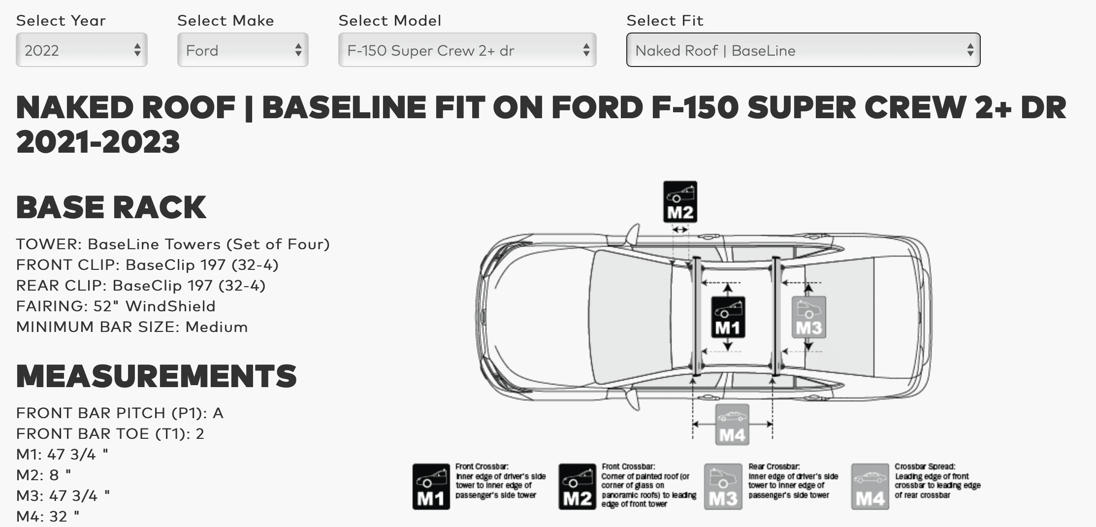

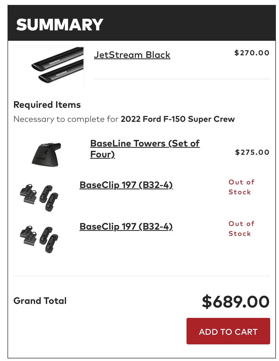

Here is an image from the Yakima website with the different model F150 options. Most all of the options seem to use the baseclip that I was mistakenly sent. When selecting the 4dr option it prompts that no fit is available, which lines up with what Rack Attack initially told me and ETrailer later confirmed after I did the install. Can anyone decipher the nomenclature Yakima is using to describe our trucks? What is a "Super Crew 2+dr" for example? I imagine both the Yakima customer service rep and ETrailer got confused by this.
Ford F-150 Has anyone drilled into their roof yet? Captur
I think they have an error in updating their site for 2023 models (not uncommon for them, I used to see this in the past when I did competitive analyses against them). Looking up the info for a 2022 F-150 Super Crew 2+ dr, the base clip numbers are 197 front and rear and it shows the year range as 2021-2023. My theory on the 2+ dr nomenclature is that they are carrying over model info (copy/paste) from the Super Cab from the late 90s which had 2 doors plus the half suicide door on the passenger side. Super Crews obviously have 4 doors, I think it's just pulling the data from their database or they have a data error, perhaps a duplication and find/replace issue. What's really interesting is that the Ford Lightning (same cabs and roofs as the standard F-150) shows 197 for the front and 109 for the rear and M1 and M3 are 1/4" and 5/8" (respectively) wider than the standard F-150. The fit should be the same as the regular F-150. The interesting thing is they show the Tower as BaseLine Towers 2016-2022. Maybe there was a design change in 2023 and that's why it's showing a no fit on the main website. I'm assuming the "832" base clip stamped on the bottom of the bracket in your photos is the bracket number they sent you, which I haven't found as a recommendation on the fit lookup site or the main site. It's shocking to me that Yakima customer service doesn't have some inside info on this to explain the discrepancies. If you call back, I'd start by asking why the fit lookup site has different info from the main site for the Lightning and follow up asking why the fit info is different than the standard F-150. I'd also ask why when you choose 2023 in the drop down that it shows Check for Update, whereas when you select 2022 a valid fit comes up and it shows the year range as 2021-2023. If they can't answer these questions, hopefully they escalate it to the fit team and start digging to find answers.
Ford F-150 Has anyone drilled into their roof yet? 1694172708946
Ford F-150 Has anyone drilled into their roof yet? 1694173749912
Looking at the regular site reflects the same 197 base clip info, although it shows out of stock.
Ford F-150 Has anyone drilled into their roof yet? 1694173321403
No fit for the 2022 F-150 Lightning on the main site.
