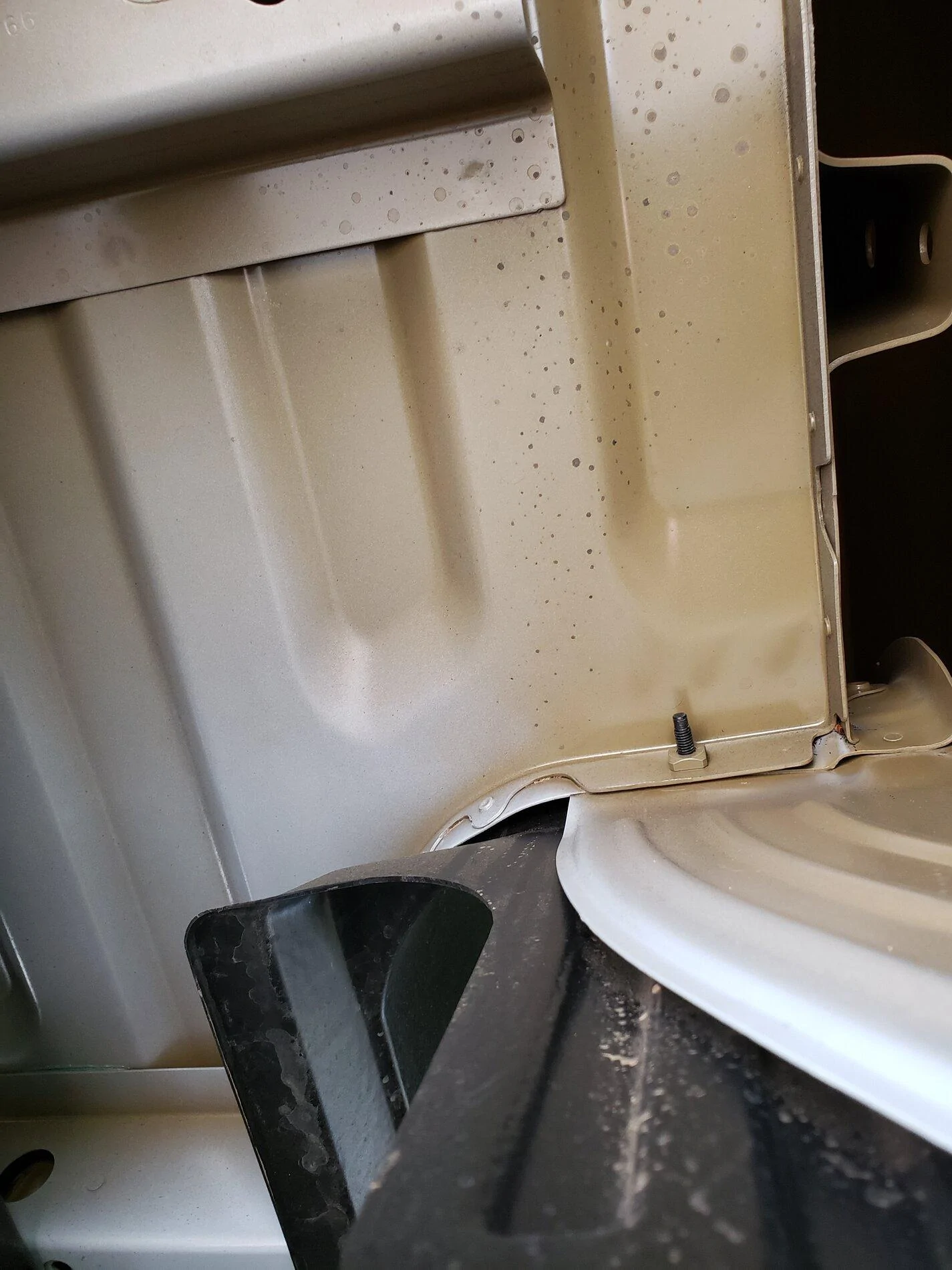

OCD pics LOL:
Weird, bed liner didn't fill gaps, looks like floor was done as separate part almost.
Side seam doesn't follow frame rail at least.
Wheel well liner has lip that looks like its under part of side seam.

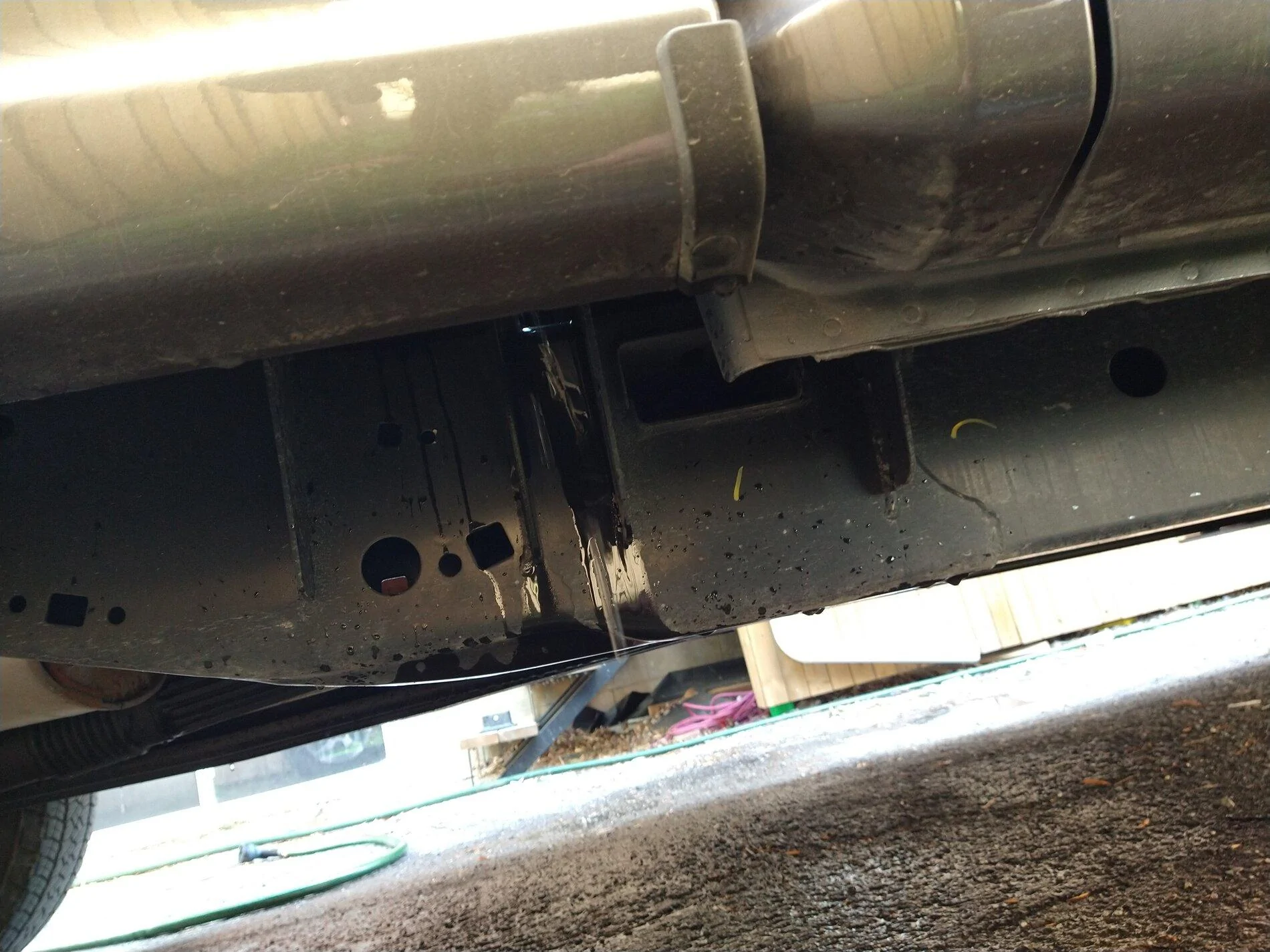

Those gaps are exactly why I made this topic. And as feared, water runs right on the frame rails, axel, exhaust and gas tank at the exact same spot. It direct all the water to that line. I think I am going to run a good bead of high quality exterior black caulk all along those joints.
