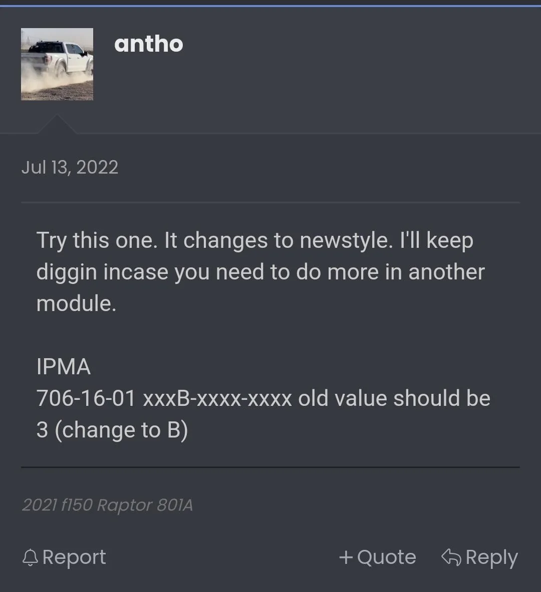

Mine doesn’t come up either. At some point Ford must have “refined“ the parking assist delete.
But easily fixed with a small edit of the AsBuilt values in a single module.
I suspect the gimp was an unfortunate oversight by the "team" tasked with determining the necessary software changes (AsBuilt values) to accompany hardware supply chain constraints. (the missing chip in the IPMA module)
