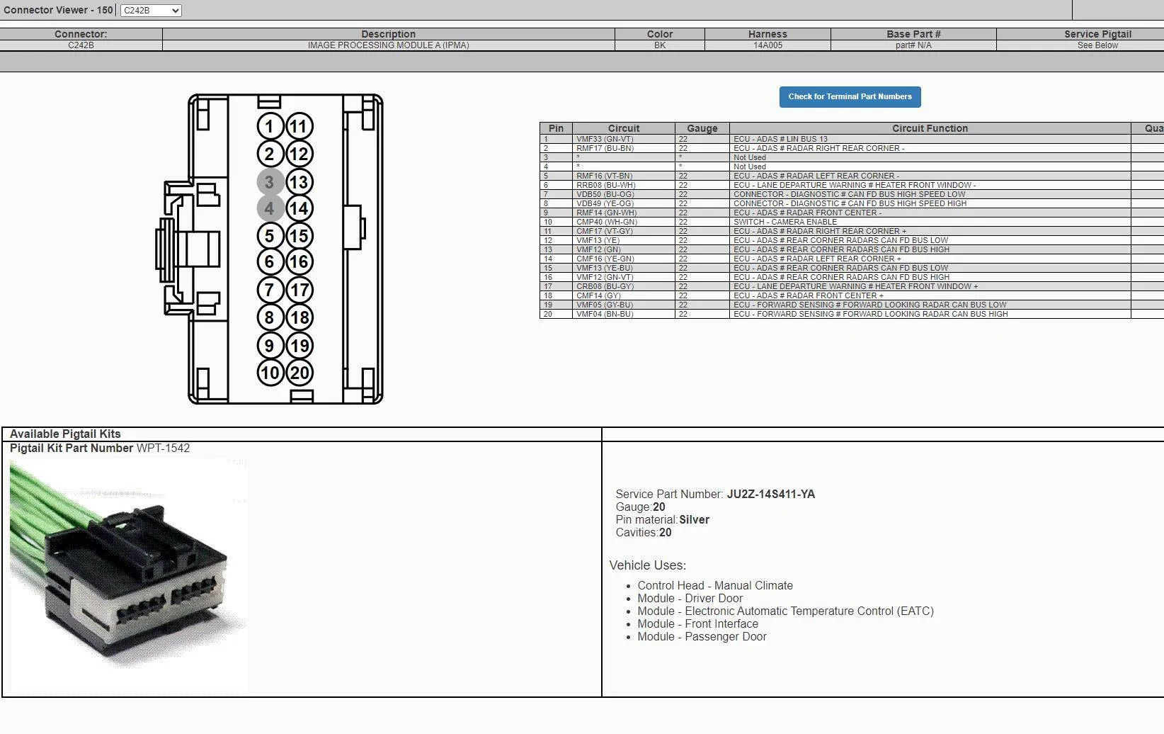

This alert usually indicates that there is a connection issue between the IPMA and the ACC radar. Inside the cabin that is the black connector on the IPMA, which is in the drivers footwell to the left of the brake pedal.
Ford F-150 Front Camera Fault + Pre Collision Sensors Not Working After Ambient Light Install IPMAPlug
