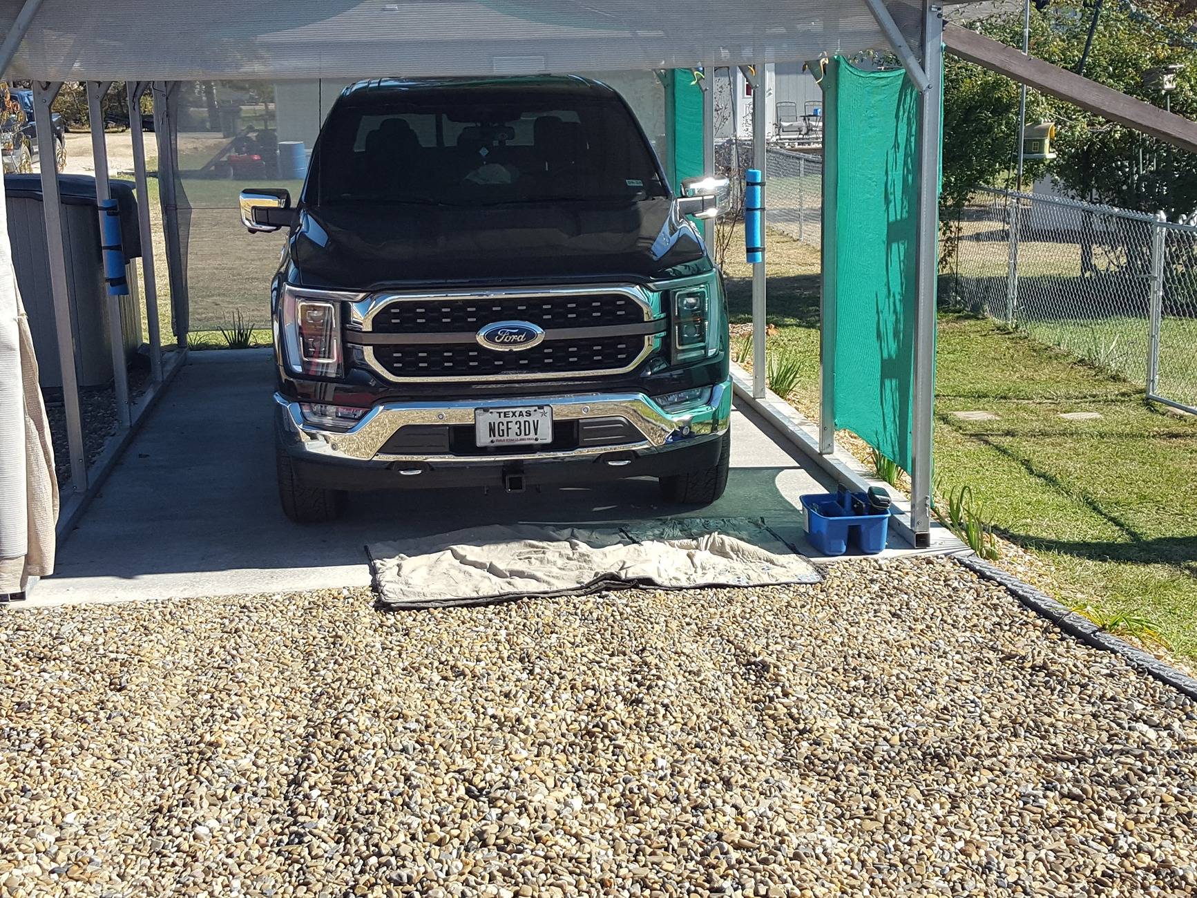

I put a torque lift one on.it poked out just below bumper..in to the upper air dam
Orderd it on e trailer
I cut those ears off as well.
Made a smoother look

@powerboatr, it looks like you trimmed the active air dam for the front hitch. Does the active air dam still work this way?
Also, would this hitch work well in your opinion as I look at the height of it for a winch cradle?
I have a tight driveway and yard to park my boat and you have me thinking this could make it easier.
The deplorable part is removed
Hang it in your garage
The reciever pokes through the no moving part of air dam
As far as clearance
If you scrape the air dam. It will touch
I used a draw bar that was a 6 inch lift..so it put trailer ball right at center of bumper..
Workd like a charm
